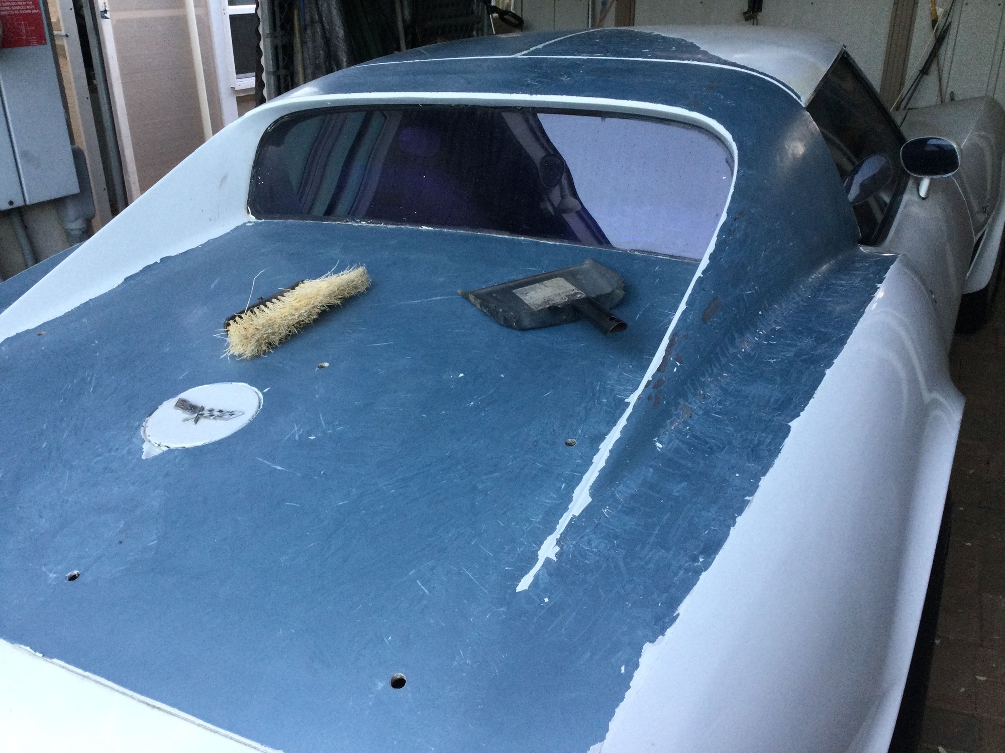

Started out using chemical stripper on rear deck but not having much luck with the stuff from Lowe’s, so trying the razor blade method with better results of removing the Maaco paint job. There will be nicks and scratches and not sure how to deal with those.

use a heat gun to help stop the nicks . also stops the chips from flying . CAUTION ! THOSE CHIPS CAN SEVERLY DAMAGE YOUR EYE !
the heat gun will let it come off in strips .

Took your advice and got out the heat gun, goes twice as fast but switched to a sharpened putty knife with wooden handle, fingers couldn’t handle the hot razor blades.
