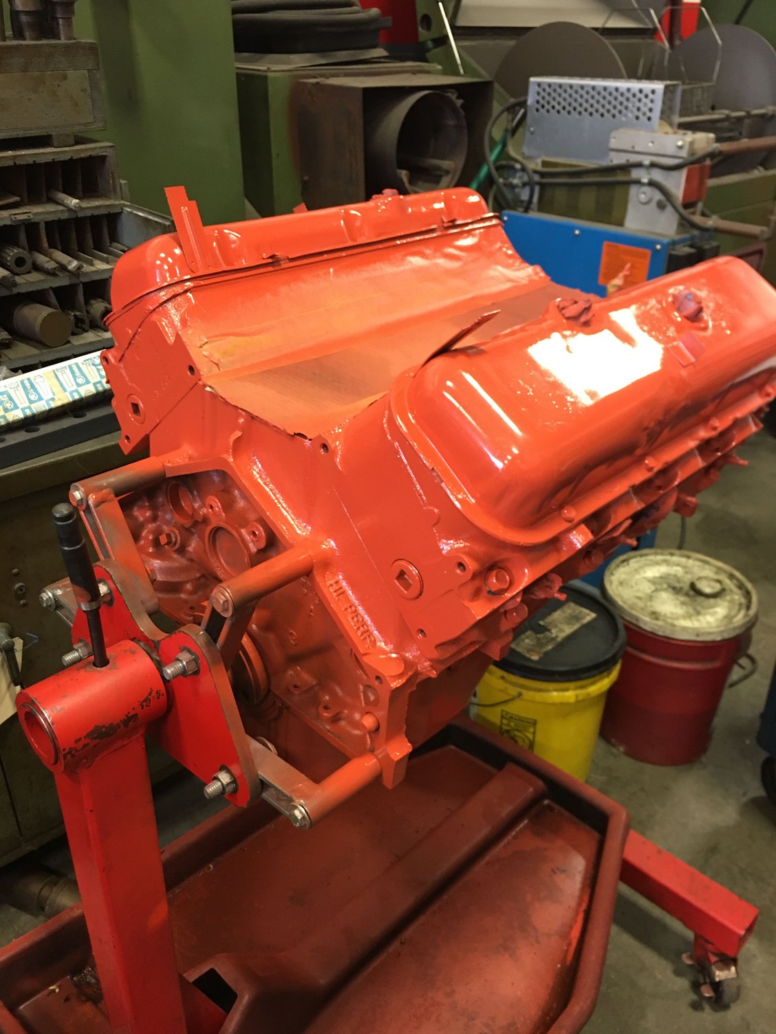

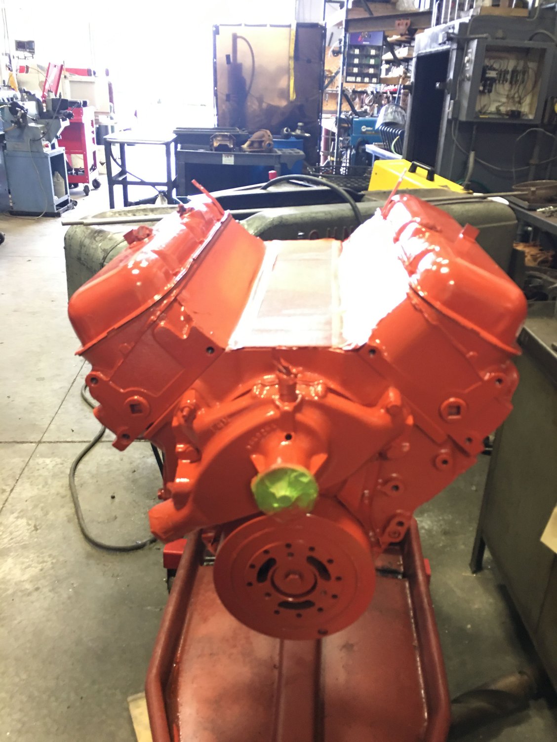

I have a ‘67 L71 whose original engine has been out of the car since 1968. I just did a complete rebuild on the engine and as part of that work the machine shop hot tanked the block and repainted it and all other factory painted parts with typical engine paint.
The vehicle this engine is going back into has 45,000 miles on it. While I was pretty meticulous with specifying rebuild parts etc in hindsight I probably should not have done a complete repaint of the block & heads. What I’m hoping to do is make the new shiny orange paint on this freshly beefed up engine look like it has been in the car forever and look like the engine has 45,000 miles on it too.
That said short of chemically stripping are there any ways to make new engine paint look old and heat distressed? Weird situation and question and I’m not sure I’ll go through with it.....just wondering if there is a way to make new paint look old (some sort of caustic spray on chemical/cleaner, etc).

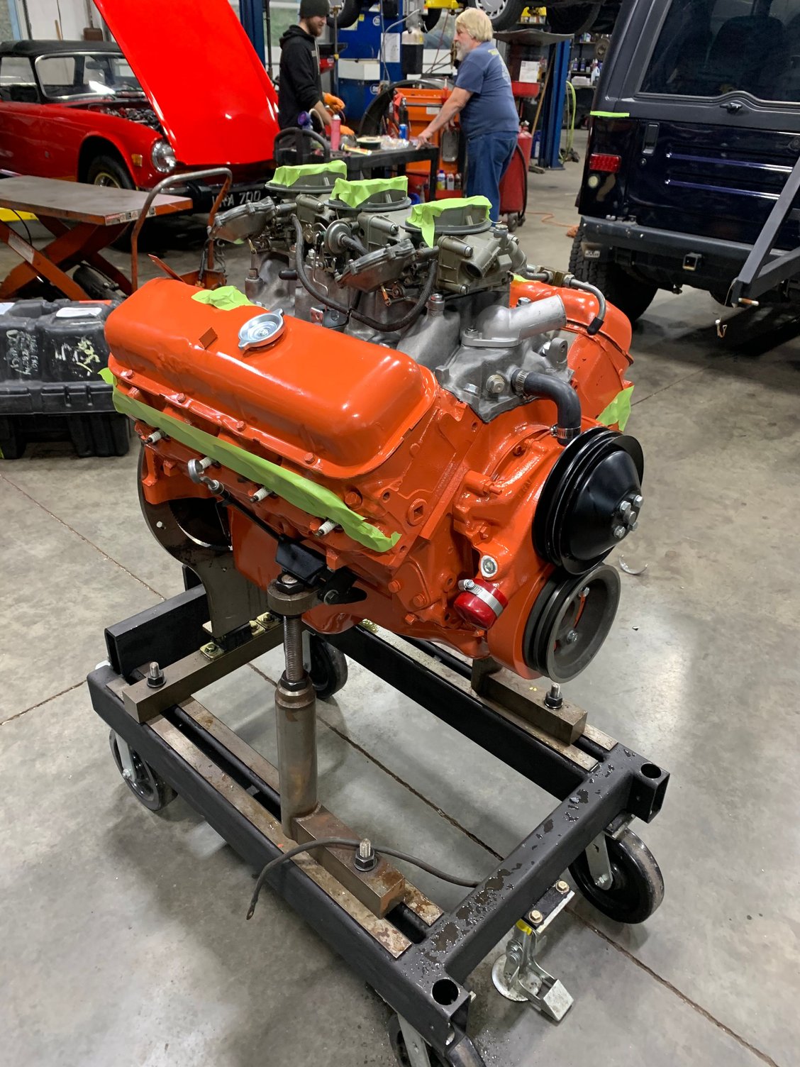

You're welcome. Appearance is more a consequence of storage conditions and age than miles. You can help things along as I mentioned above, but as long as the paint is applied as it was at the factory (overspray and proper components in place when it is painted), it will get a nice patina pretty quickly with use. The real work is creating the "look" with accessories, hardware and the rest of the engine bay.
Here's one I built from flea market table parts in an engine compartment that had been media blasted. Part of the illusion are the intentional obvious deviations from factory (aftermarket radiator cap/air filter/hoses/clamps and the oil change sticker added to shroud). These draw the eye away from looking at what I don't want people to see and create the impression of a survivor. Visible reproduction/restoration parts are a huge no-no. There's not a single part from the original motor but it looks like it's never been out of the car. The biggest challenge for me is getting myself to age a high dollar NOS part when I can't find a suitable used original...

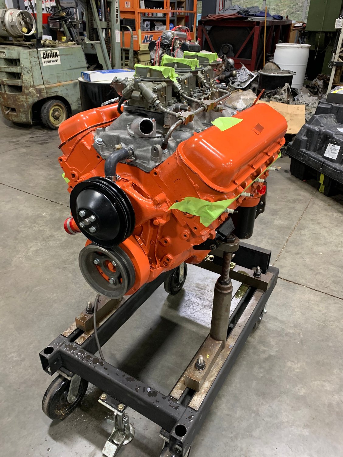

Thank you. Here's a picture of the other side. The car has its NCRS Regional Top Flight; very few originality deducts (the K&N filter is for driving).
And a couple with the filter housing off:
