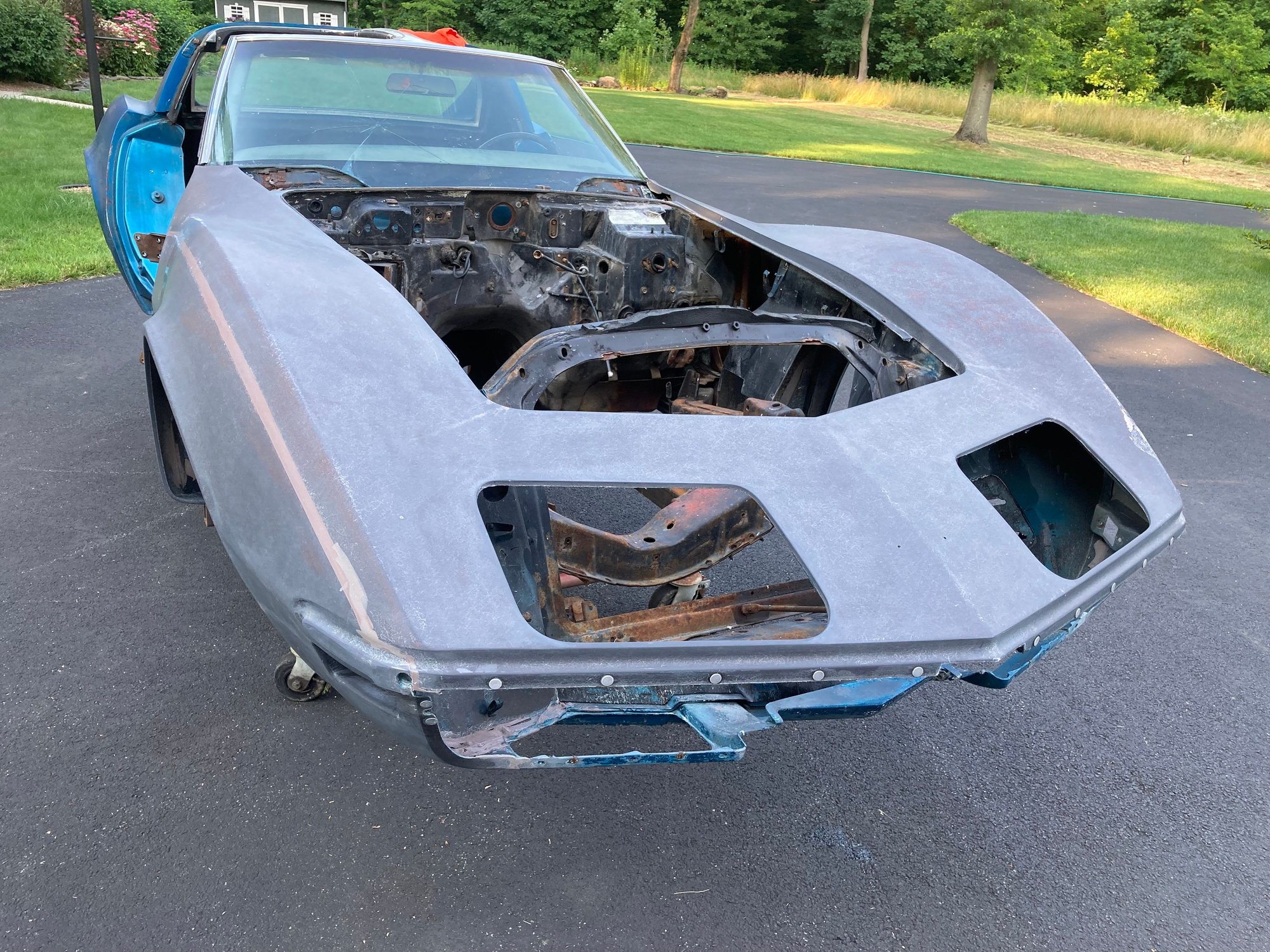

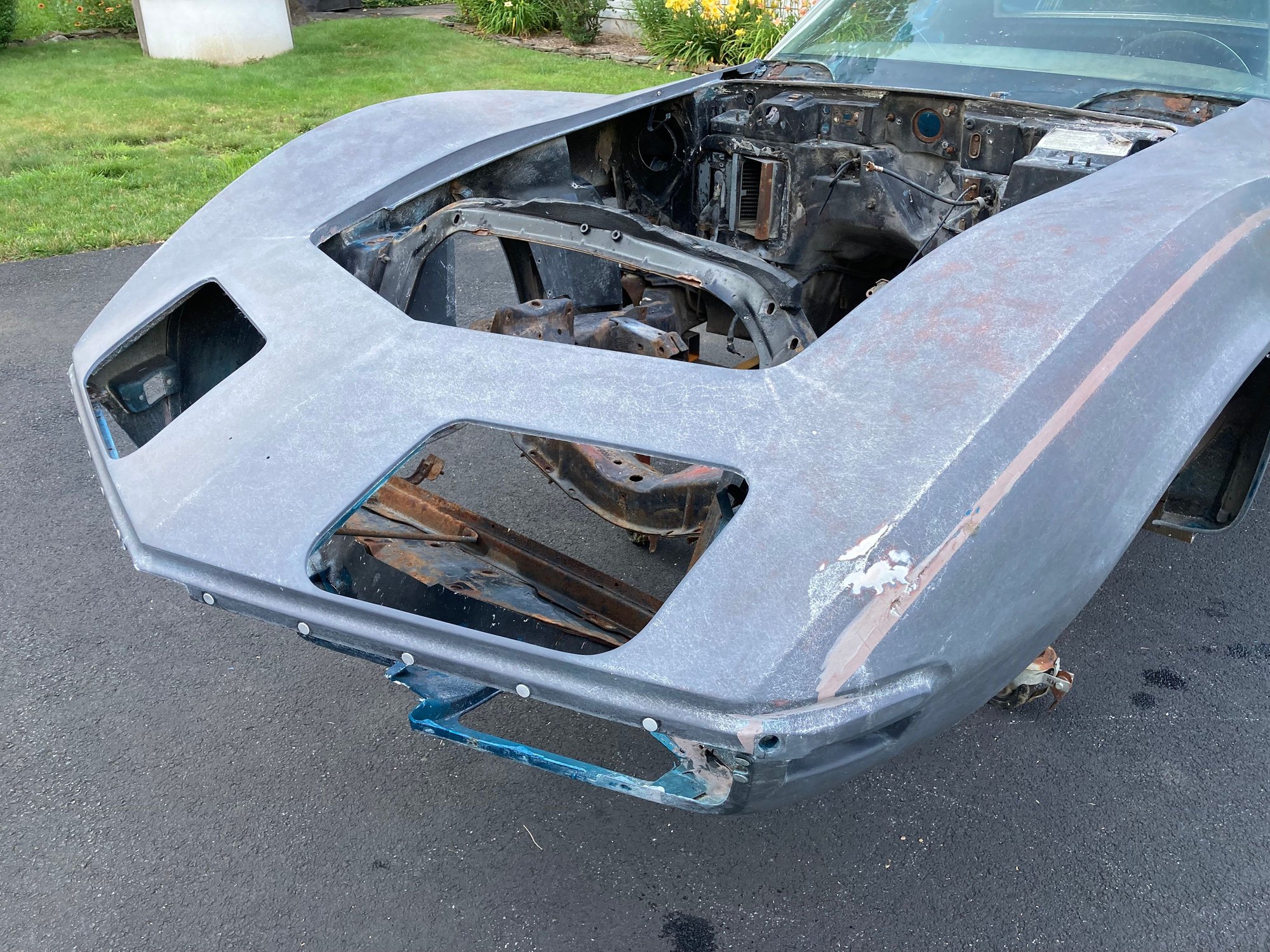

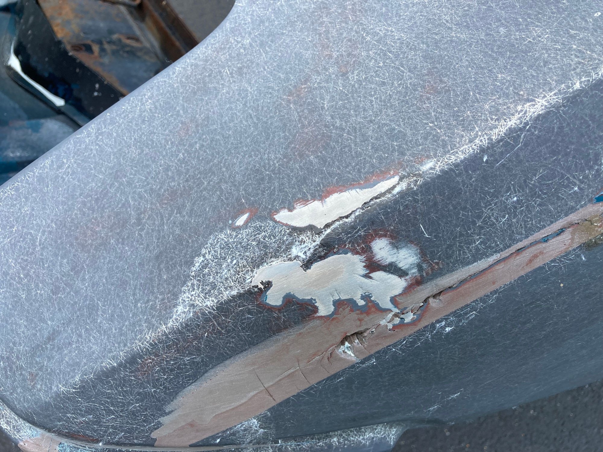

Good Morning,
My 71 vette will be fully stripped so I'm starting with bare fiberglass and the original bonding adhesives. I plan on dishing out the bonding areas and filling the voids with Vette Panel Adhesive. I also have some other repairs that will be made using the West 105 system with either glass mat for the larger areas or 105 plus one of their powder additives. Most of this seems pretty straightforward to me even though I'm relatively new to bodywork, but here is my concern. I will have bare polyester fiberglass, original body panel adhesive, VPA, and West epoxy on the outside surface of the body. Evercoat Featherfill advertises great adhesion to bare fiberglass and I was hoping to shoot three wet coats so I could block the body until it's pretty slick, but what about those other products? Will it bond to them or do I need to hit those areas with epoxy primer first?
Eventually I hope to paint the car using PPG products including a coat of sealer followed by three wet coats of Single Stage Deltron Paint.
Steel body cars are easier. Proper cleaning and sanding...bury things with epoxy and you are good to go with a primer surfacer. Fiberglass and epoxy have me puzzled and I don't want to "Learn a hard lesson."
"Donor" front clip right after paint removal.
Lower valence will be replaced with an original one I already have.
Only hidden damage I found under the 9 coats of paint. That's right...9 full coats!
There are a few "nicks" on the panel edges I plan on repairing with the West 105 system.
Old repair that needs to be ground out and glassed on both sides. Bonding strip has separated, but it is still intact.
Any advice would be greatly appreciated,
Mark
