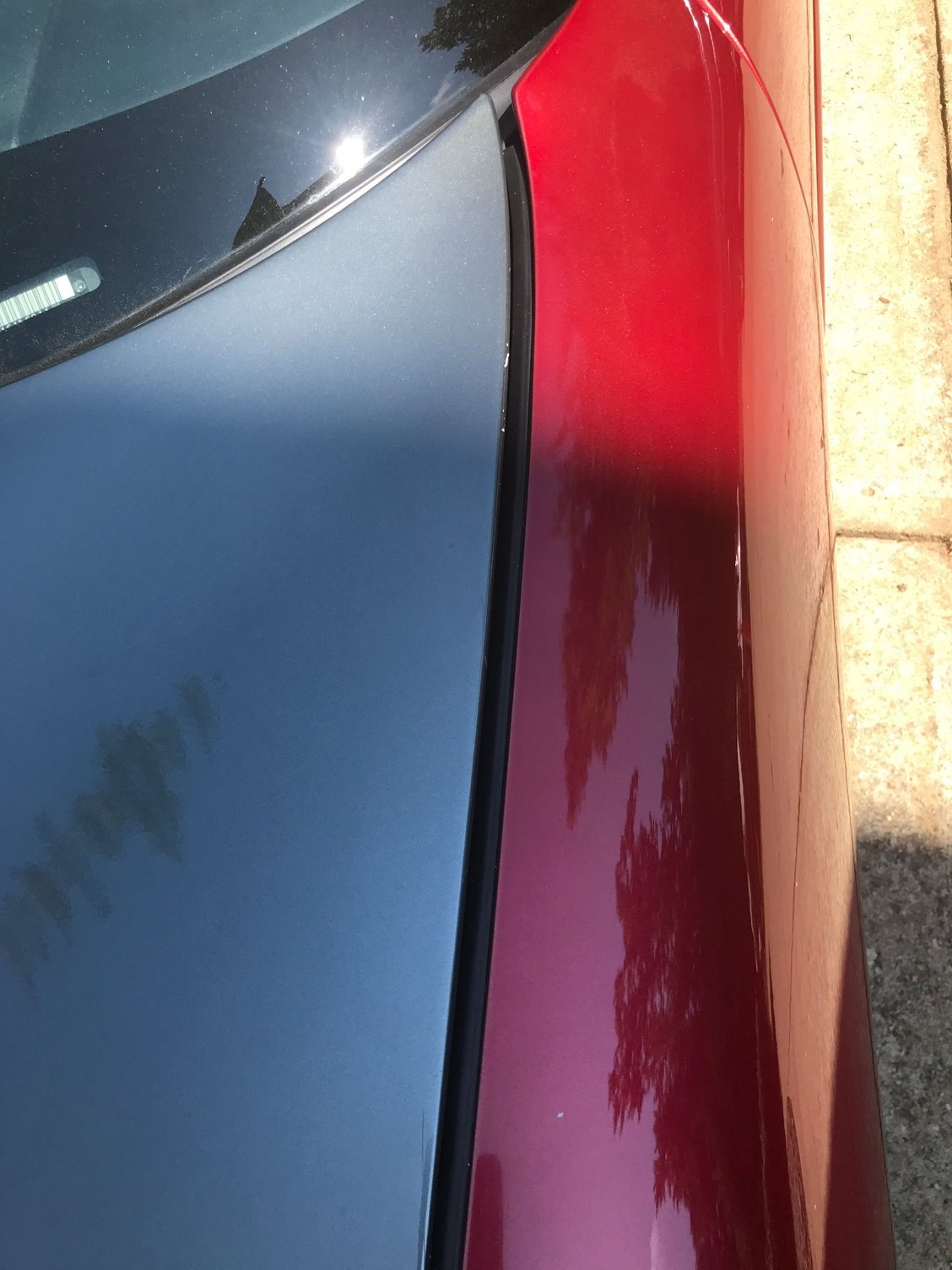

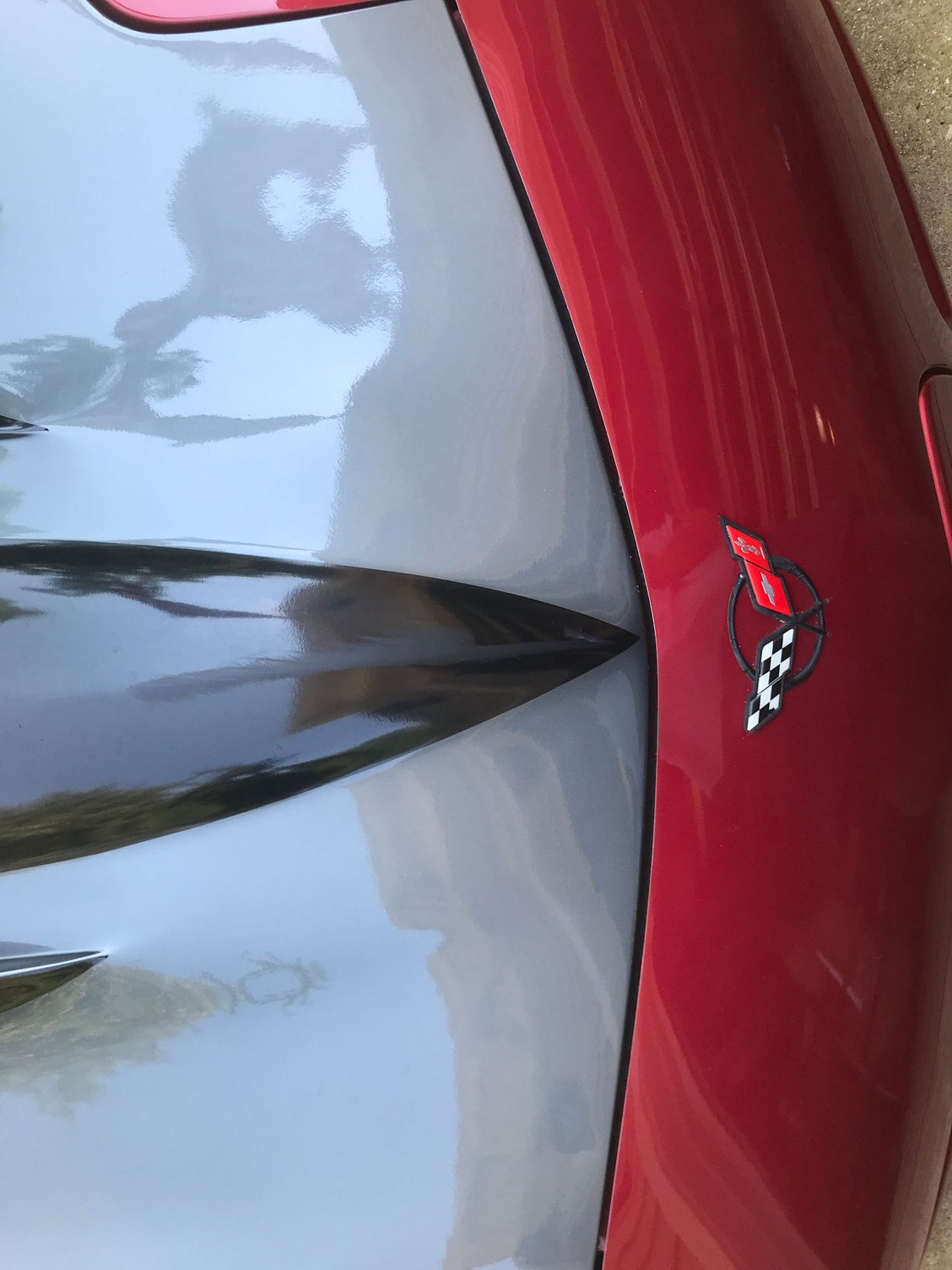

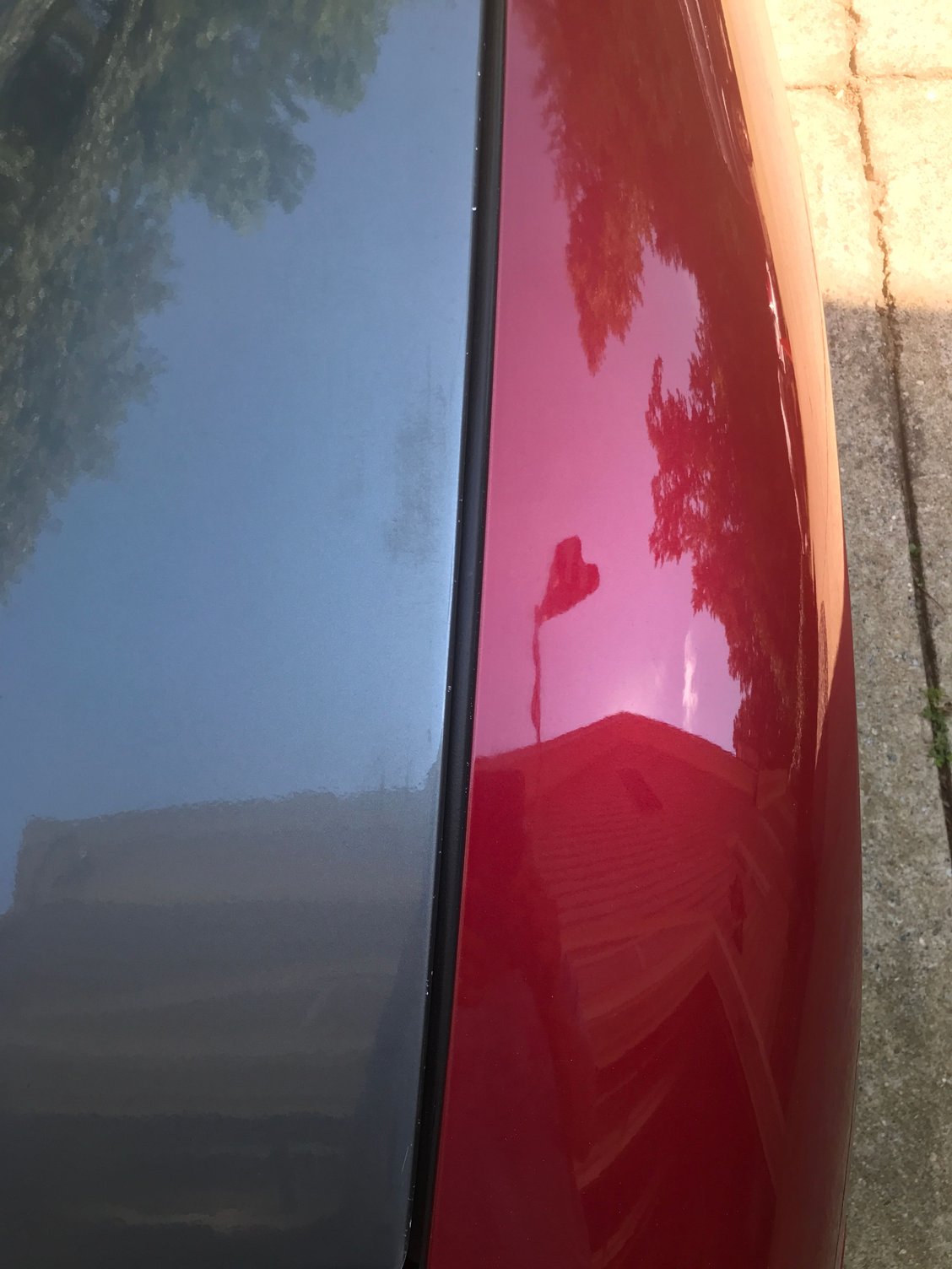

Hey CorvetteMike, had trouble getting pics off my iphone, but heres what it looks like:

If you move that fender its going to miss with the alignment of the door and headlight door. Measure your old hoods width and measure the new hood width, Who is the manufacturer of the new hood? If there is a difference in width between the old and new maybe contact manufacturer or retailer you purchased it from. Good luck and let me know the results.
Old Jul 20, 2022 | 12:23 PM
CorvetteMike2024's Avatar
CorvetteMike2024
Corvette Enthusiast
Joined: Oct 2007
Posts: 6,797
Likes: 2,721
From: So. Cal.
Also, if the hoods are same width can you re center the hood and split the difference on the panel gaps?

Good advice above and another thought for you.
Assuming you are going to get it painted, I would split the difference on all the long seams and sand and/or add a very small amount of glass/filler (apt to break off if too thick) on the remaining short seams. Good to remember, GM was not perfect on these seams new plus aftermarket vendors have to make the best balance for fit they can too.
Also I pulled the fender off my 2004 to do some glass work on the bottom and if you get the factory assembly manual (likely on line now) there are only a handful of sheet metal screws that hold the fenders in place. You might could loosen all these screws and gain some additional movement plus there is always slotting the hood hinge holes routine. This later is I think more risky but you could mark the original location of all the fasteners to retrace your steps if necessary.
Hope this might help
