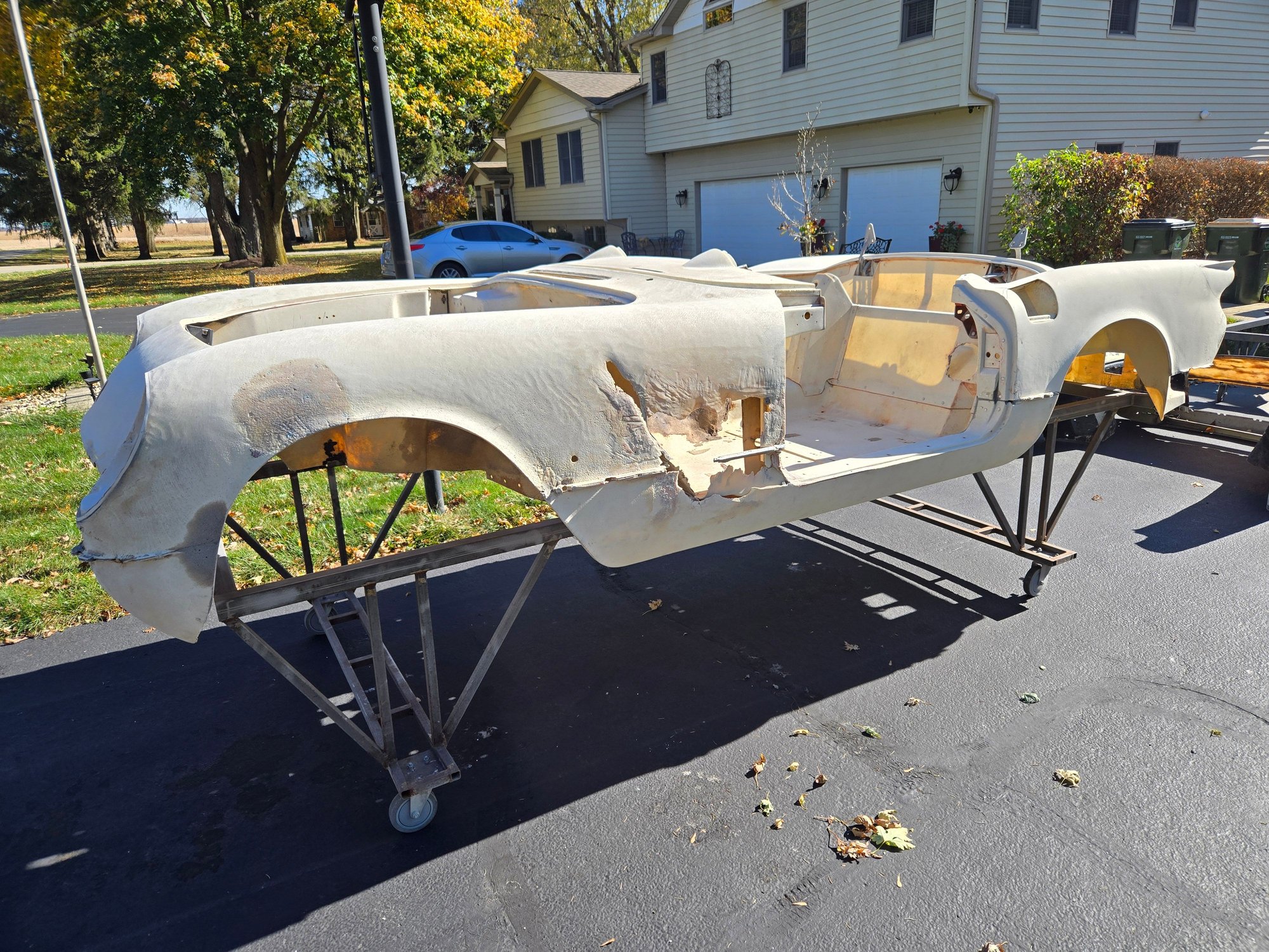

I am having good luck with Kleen strip
Klean Strip Paint Remover Qt
Here is my car last month

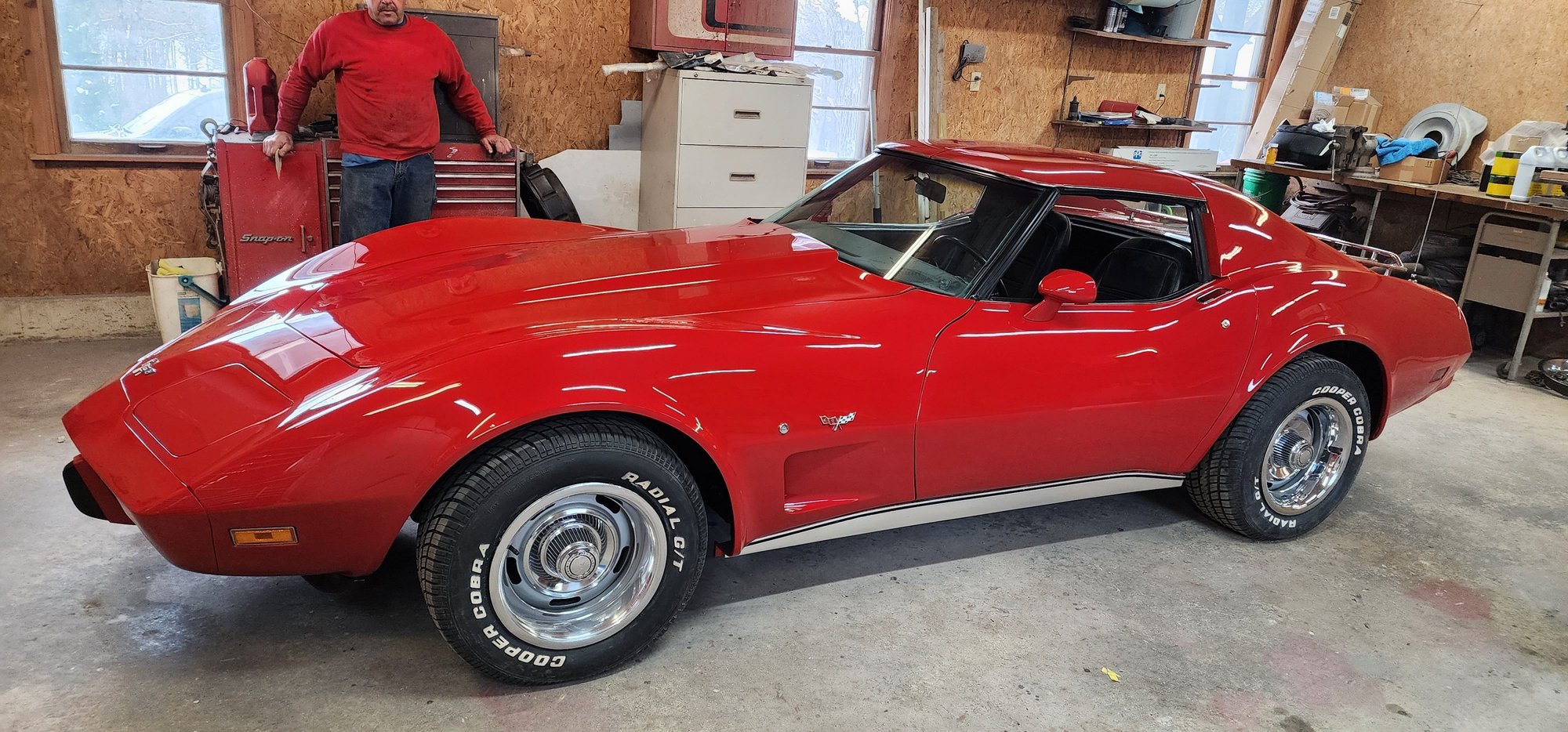

I just have had no luck using scrapers and too afraind of trying to sand off and causing too many wooptie doos
I have help paint dozens of corvettes over the last 35 years, here is my friends car we completed last winter using a chemical strip, painted base / clear and cut and buff not perfect like mentioned but maybe 98% and about 300 hours

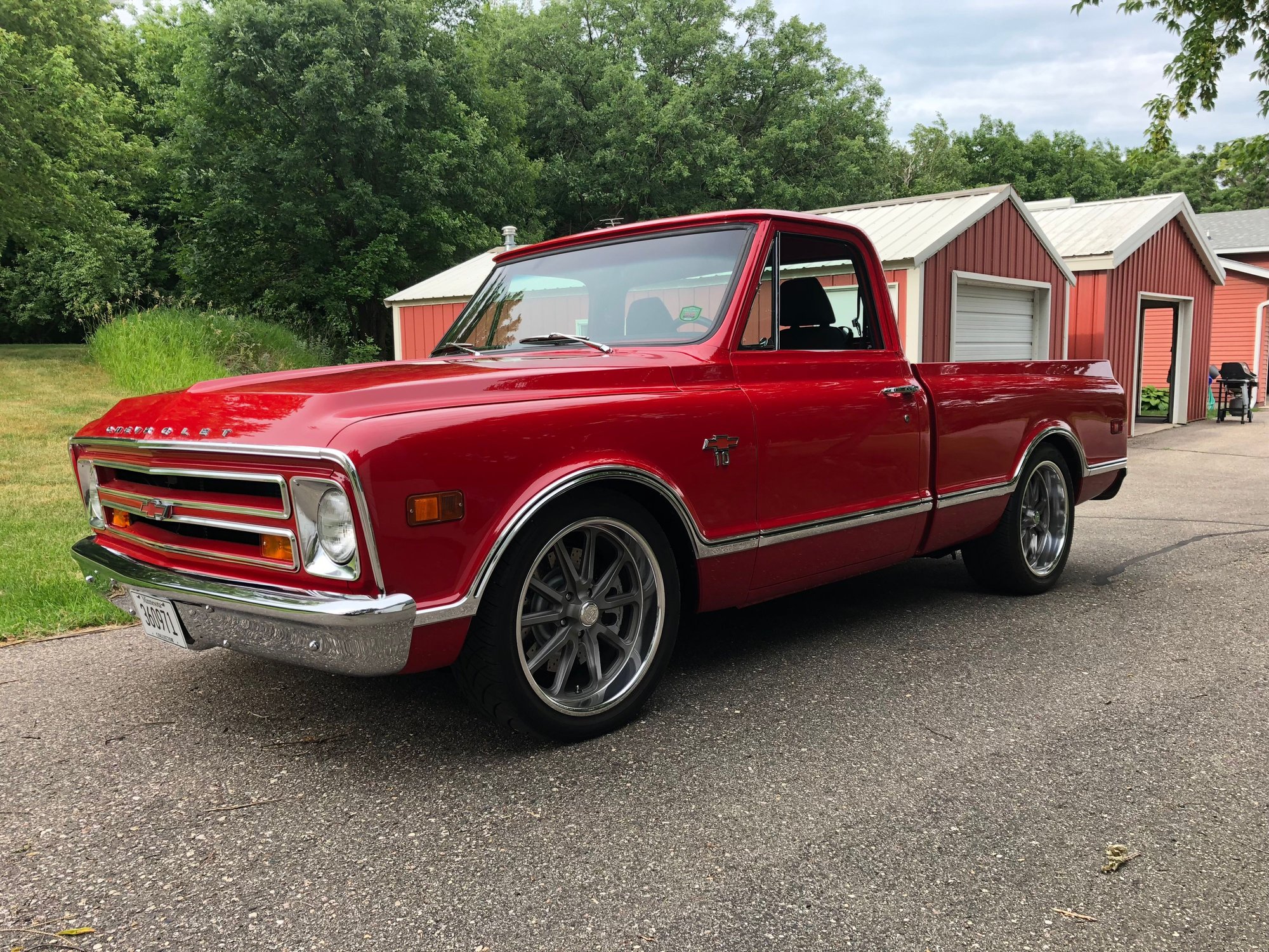

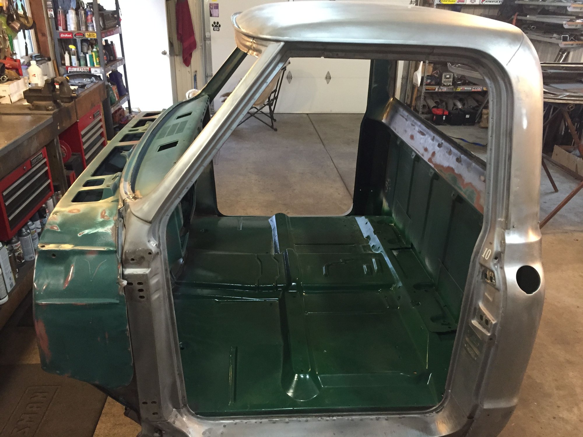

Maybe not for you but my last big project was a 68 C10 frame off. I had just retired and I asked a local body if I could do some of the body work to save costs. I built a number of hot rods over the years but never any body work. I was always in charge of taking paint off not putting back on.
The body shop agreed. I did all the disassembly and stripping of old paint. As I stripped parts I would bring the parts in to be sprayed with 2K primer. I don't have a spray booth. I used the mid range materials cost wise that the body shop used.
I stock piled body parts and one by one brought them back to the body shop and they "let" me do all the filler and primer sanding under their supervision. A number of times I thought the panel looked great. The response I got from the shop owner was keep sanding. I can tell you no one is standing in line at the body shop to block sand.
I also did all the color sanding on the flat panels. The shop did the edges and curves. The shop did the cut and buff.
A few pics before and after.

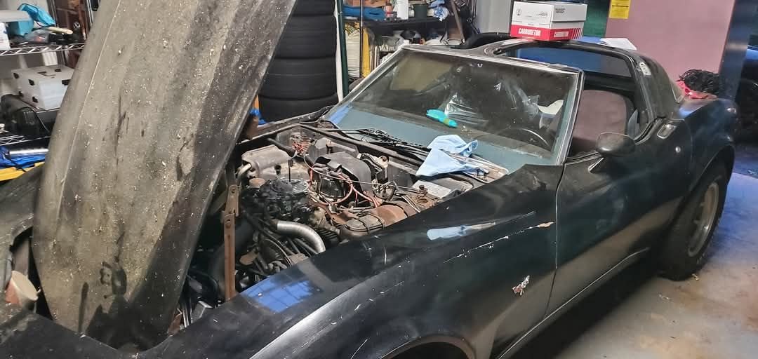

My 78 had 2 layers of paint on it. I wasn't sure at the time what was on it so I sanded the entire car down using a DA lightly and then by hand. Spent 3-4 hrs on each panel. Not much real body work at all except I also was changing out the front and rear bumpers and the side markers. That all took up a good amount of time. I am just about ready to put on 2 coats of G2 Fiberfill and then do the guide coat. Aside from just getting the car prepped I had to educate myself in the new products of today vs what I used 20 years ago. I had to get personal protective gear and then set up a paint booth. Thanks to a few forum members here and elsewhere ( Big thanks to Mark G,20 Mercury and Golfobsessed) I am confident I can get this done. I know it will be cheaper than paying someone to do it, and I really need to have my hands in the last part of my project. ALTHOUGH...I have had 3 or 4 cars done at Maaco. Say what you like, but they got the paint down fine. Everything from a 65 Mustang, a 64 Impala and a 1990 300ZX. Here is a lnk to my thread over on the C3 side. SO far the most difficult part has been trying to keep up with this thread! I plan on adding to it in a week or so with the equipment I ended up with. https://www.corvetteforum.com/forums...nt-thread.html..

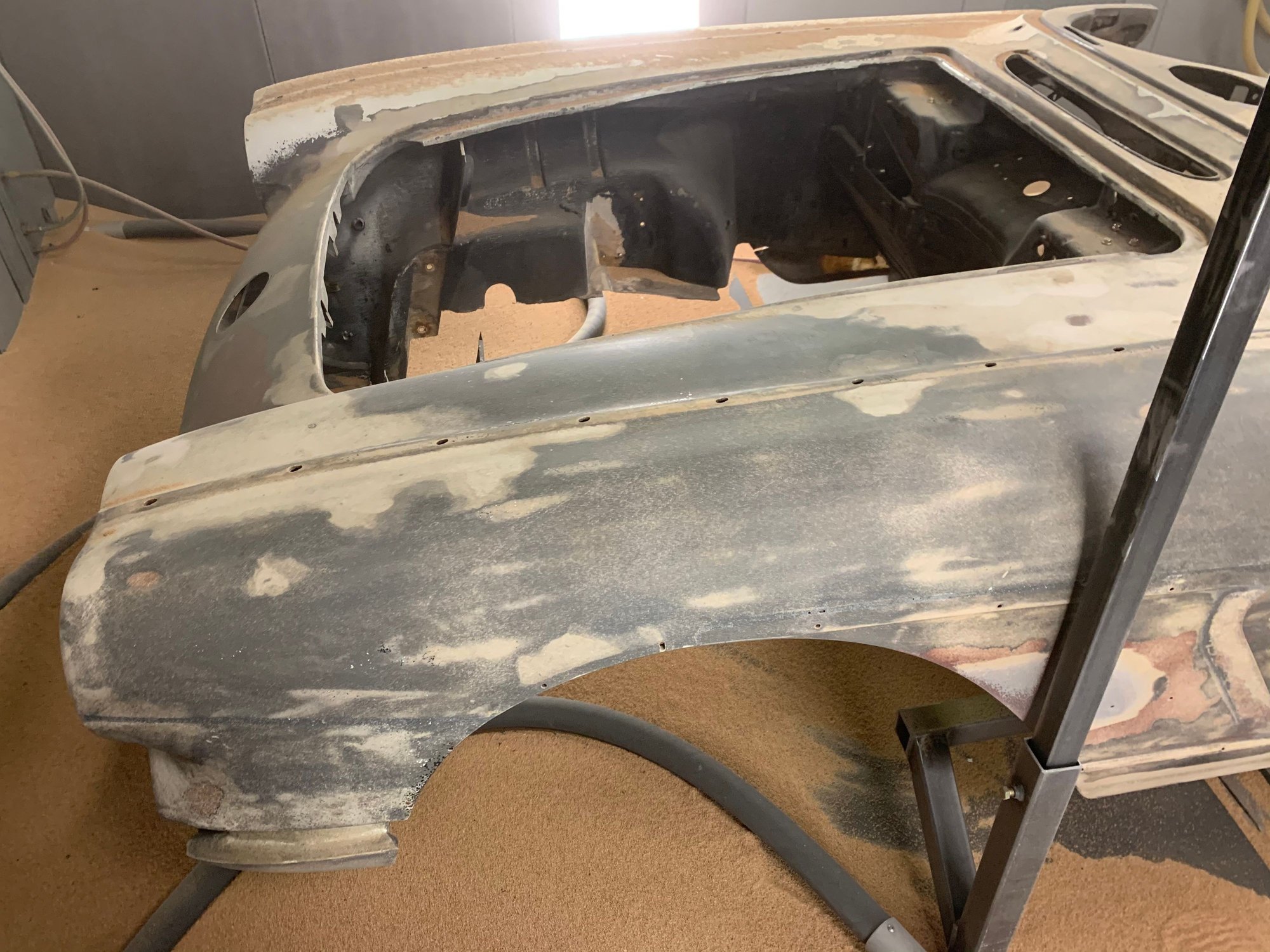

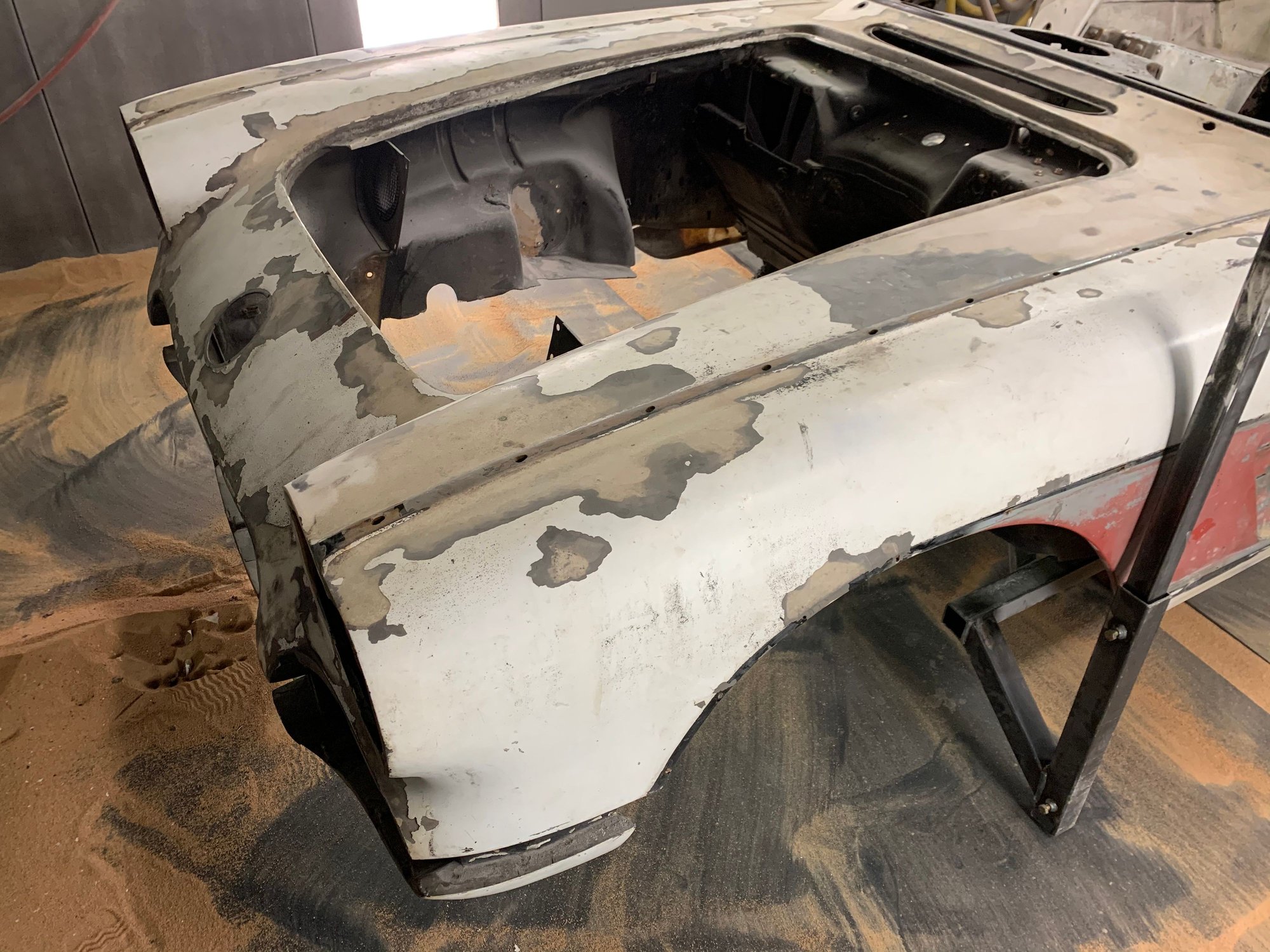

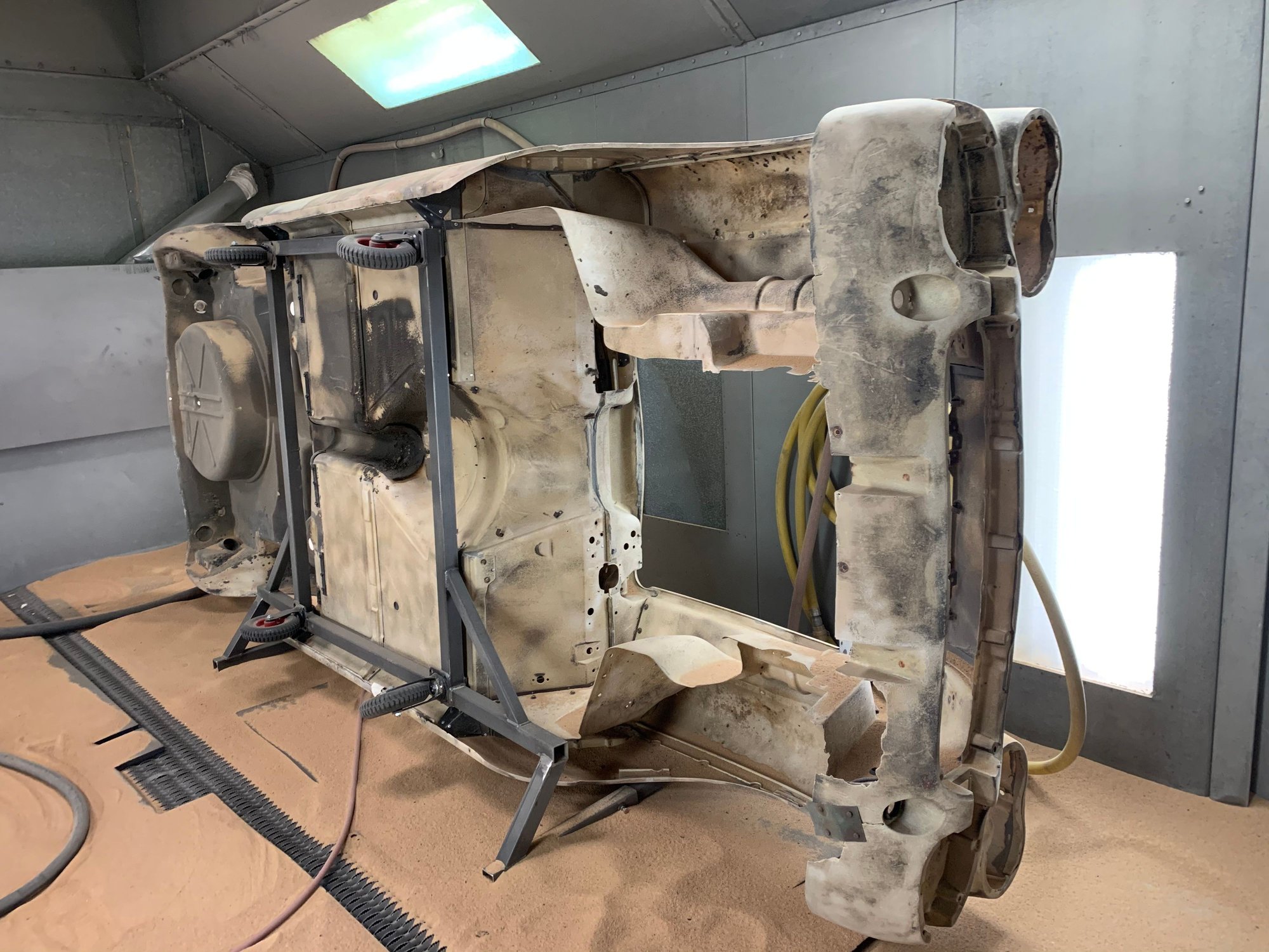

I blast ALL my customers cars
Inside / outside / underside
For $3,500.00 plus or minus I can go right to body work
No mess / no chemicals and I am right to bare glass
Now - I have a really really good blaster and he knows what he is doing and does alot of bodies for me
Body work is an art and take good feel and a good eye and knowing what products to use and where to use them
My average body work is 400 hours
Just body work - repairs - cracks - panel fitment - gaps
My average paint job - from primer to wet sand and polish to 3000 grit is $20k
It is alot of hours and it is alot of money in materials

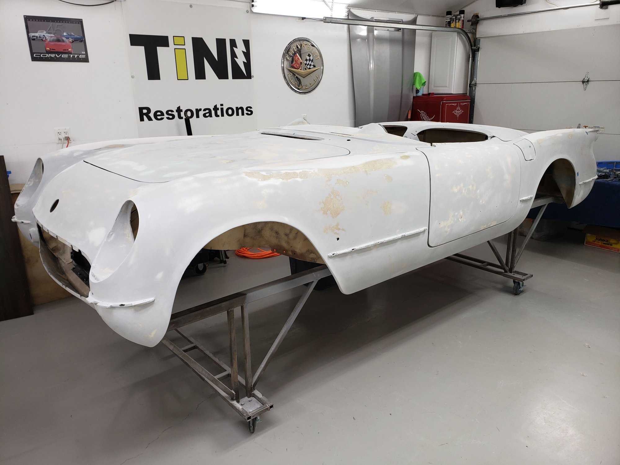

Here are some of my bodies blasted and one body ready for primer
Hope this helps

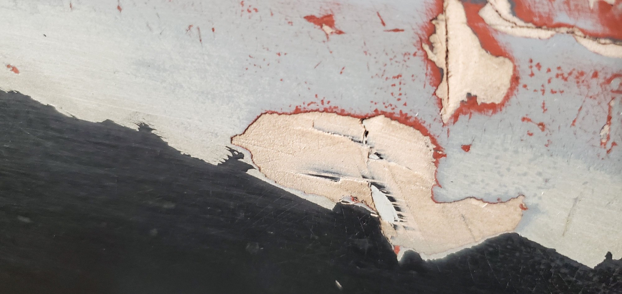

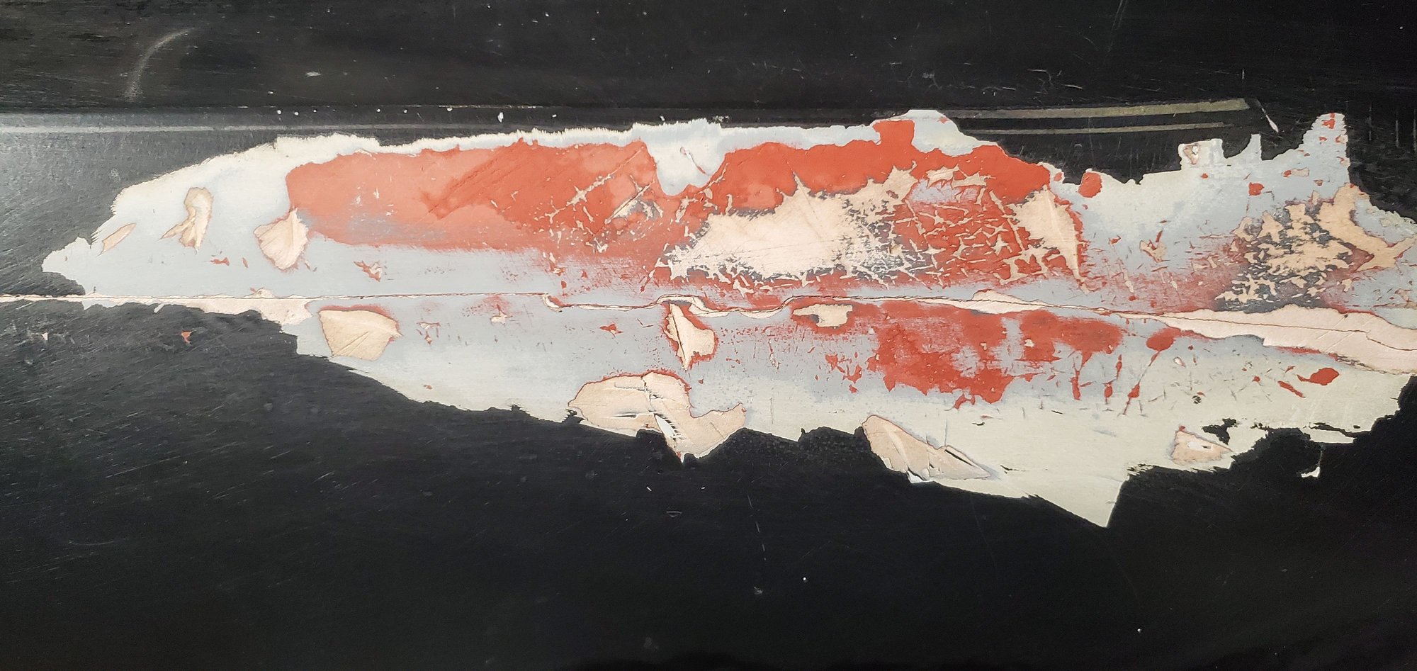

So I started using a razor blade, ran into issues with gouging under the paint. It seemed like a very fine line between the paint coming off nicely and the razor digging in.
The crack you can see is the front fender body seam. Is the white part I've dug into the actual fiberglass or is it seam filler?

Mark G's Avatar
Mark G
Joined: Jul 2005
Posts: 3,668
Likes: 822
From: WI
I've blasted a lot of stuff in my day. Going back to the early 80's. But fiberglass is soft and easily damaged. Blasting is waaay too aggressive for it. Not too many vette guys would recommend blasting. I certainly wouldn't do it (for paint stripping). You can't really control the 'depth' so a guy ends up with an uneven surface that's a mess. Its a lot more work on the bodywork end. I've seen vettes that were plastic media blasted and the fiberglass surface was terrible ..uneven. I can see a lot of uneven surfaces on the above 54 (no offense ...to each is own). On a C3 blasting will erode away all the nice sharp edges (the essence of a C3). But media blasting is great on painted steel!

I ran in to a similar problem as you with the razor blades I had a few sections peel off but after looking at it I was clearly gouging the fiberglass
Stripping barely even blistered the old lacquer paint for me
i opted for blasting and a big sander
i built a custom frame and had them start under the car
my instructions were, stand across the shop and blast lightly
leaving some paint on is fine
it did work out ok for me.
i hand sanded from this point
