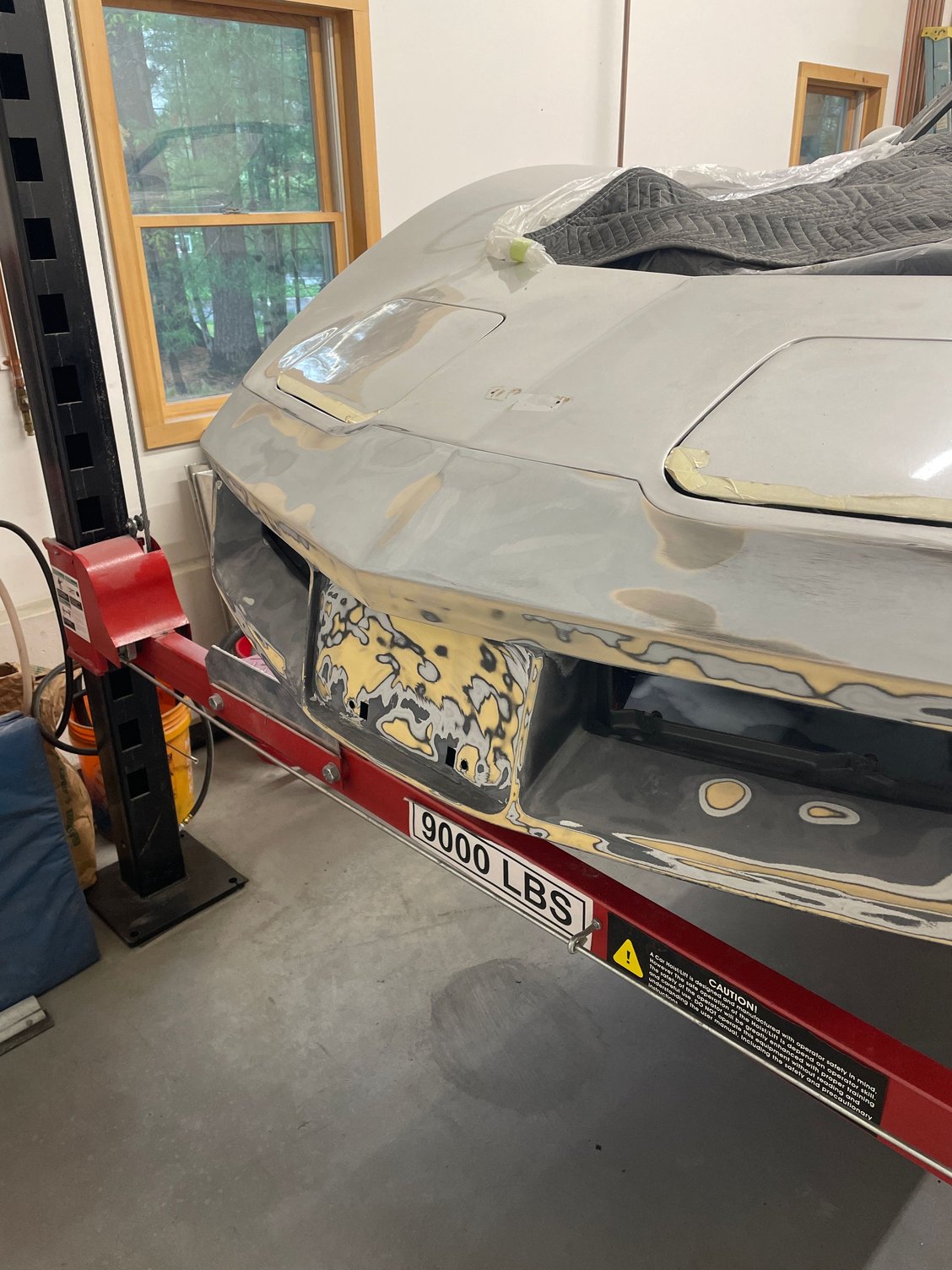

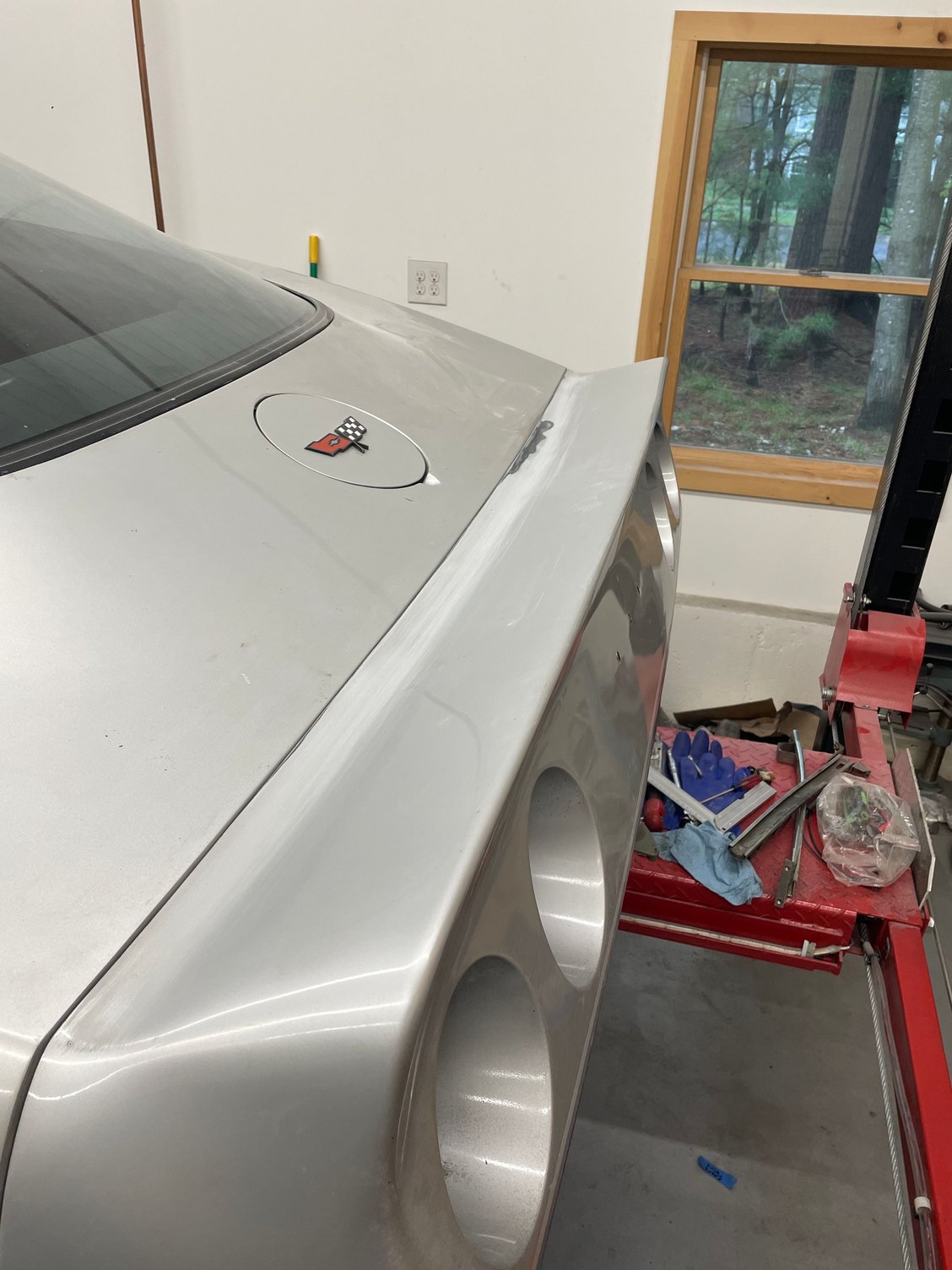

Thanks for all the information and wow didn’t expect such a quick responses. I’ll post a pic,it tells all. Front needs more sanding. Top has a lot of high lows that I can’t do much with and going to sand more paint off. Now the back one spot lifted so I sanded it and feathered it out. It going to need more work. Maybe spot that with adhesion promoter spot prime and paint rather than stipping the hole thing.
Paint lifted only one spot.
The gray is polyvance filler.

Kind of a toss-up there. I guess if it was me I'd do a test spot with the PVC solvent to see if it'll soften the bumper... put some in an inconspicuous spot with a small modeler's brush. See if it 'softens' the substrate a bit. If so, spray on a wet coat on the bare bumper areas with a small touch-up gun. Check to see if you need a 2nd coat (b/c it evaporates quickly). After it flashes off, apply your 2k primer. HERE Or get some of the adhesion promoter as I've linked above.
If you applied your 2k primer over what you have now it would probably be ok too. I'm sure they're good and stiff ...not very flexible anymore. But I like to get better adhesion on bumpers as much as I can.

You’re right about the cover being stiff. They’re real stiff. Have no cracks just wavy. Very hard to get it perfect. The car was in Florida for a while. Probably baked them. Thanks again for the advice it helps out a lot.

Well here's an idea:
You could consider applying 2k primer, then scuff it and apply a flexible filler over the bumper cover ...and sand it flat with a board sander. Use a flexible body filler HERE. Worth a shot. Its plastic over plastic. Silver doesn't really heat up like black or dk blue....which would expand/contract a lot more. I think you could maybe get away with it on silver ...if you are gutsy enough to try it. Like I say, use a flexible filler. Take the paint off the top and use an adhesion promoter (or the PVC trick) ....to get good adhesion with 2k. Then scuff and apply the flexible filler. I can't guarantee anything, bet it would last a long time ....sure look a lot nicer. Be Worst case, you sand it all off in 10 years and re-do it. I bet it would last a long time though. How often does the car see the light of day??
Most new fillers are designed to be used over (scuffed) primer anyway. But I would remove all that potentially old lacquer paint/primer on the top ...if you do it.
Are you going to blend back into the front of the hood/fenders? Or just spray the nose & tail?

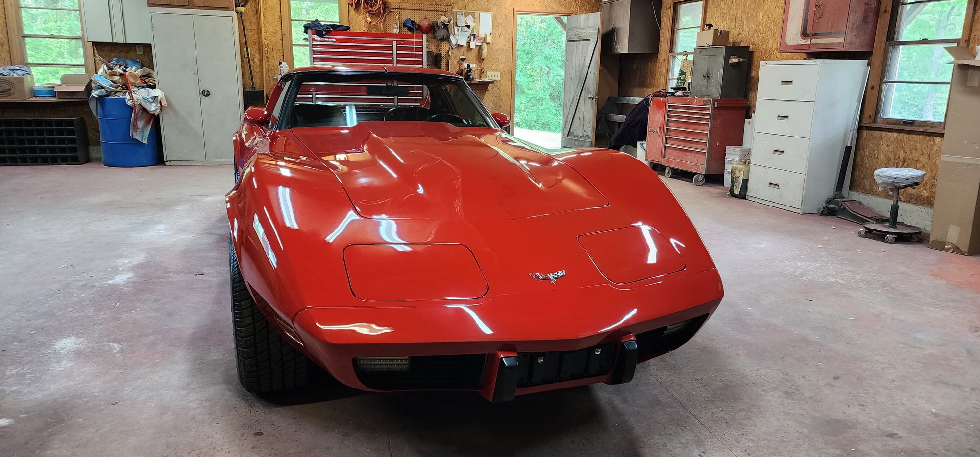

I bought a brand new urethane cover for my car a while ago (like 15yrs) ...when Ecklers was still making them (maybe they still do??). For an 81. They're pretty good, but even those get a little wavy too. But that's how they were. Fiberglass is good until the nose gets tweaked ....and damages the fenders/hood. I guess if a guy has insurance...

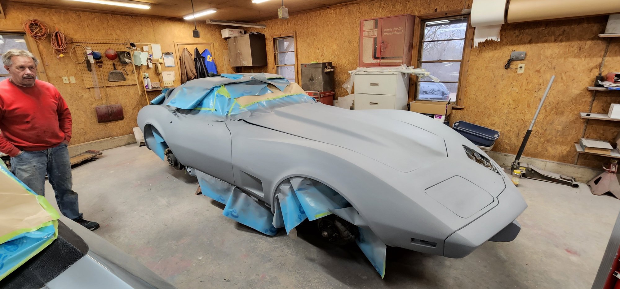

Hey Walleyfisher nice paint job. That’s a lot of work stripping it down. Did you paint it where it sits. How on earth did you keep the overspray down. Everything looks so clean.

Your lucky. When I priced everything out I decided to stick with what I had. Even used fiberglass was expensive. I going to paint the whole car. Not sure if I’m going to stick with the 2 tone. Silver, charcoal or i’m looking into steel city gray. I visited a members shop in N.C. And he introduced that color to me. It really sticks out.

Mark I used polyvance Flex Filler 2 on the front. Sanded it with an air board sander. I’m going to do it one more time and try to feather those high spots better. I tried a little guide coat on it. Trust me that’s way better than it was. That filler is for urethane bumpers.
Old May 5, 2025 | 10:57 PM
Mark G's Avatar
Mark G
Joined: Jul 2005
Posts: 3,691
Likes: 833
From: WI
Ok....sounds good. Sounds like we're thinking along the same lines.

Thank you, I used a nice gun and wetted the floor down
