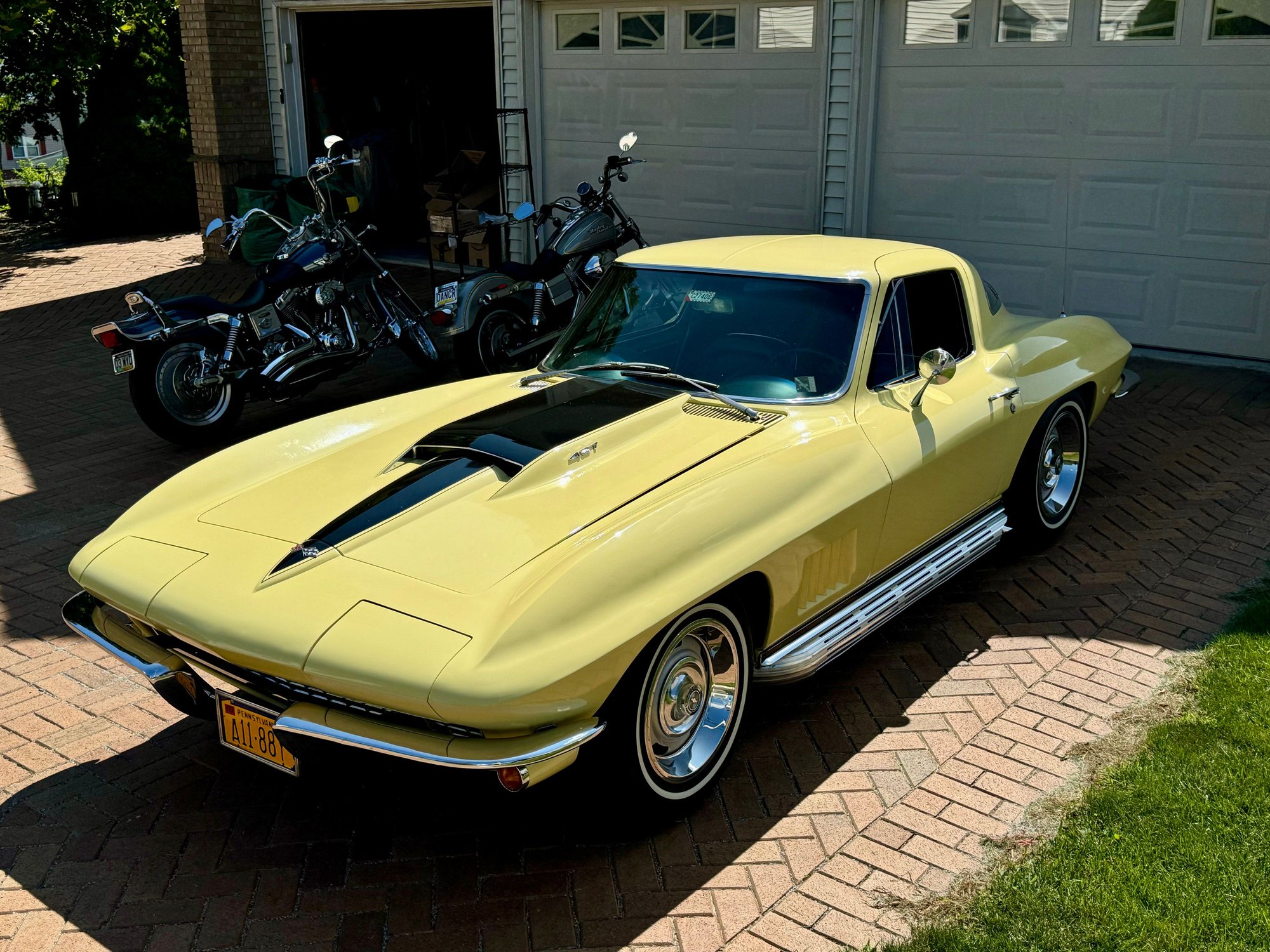

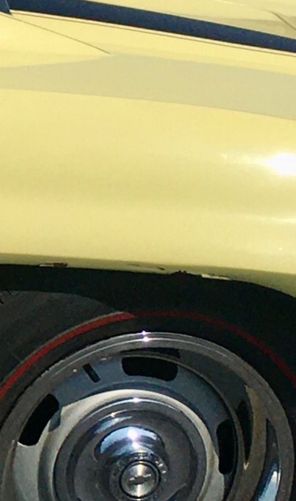

So I have a Sunfire Yellow 67 L71 that was repainted under warranty by the dealership body shop in February 1968 with the GM lacquer de jour of that era. The car still has that finish and it is surprisingly in very good condition (very little exposure to elements). I have a small front wheel well opening crack that I’d like to get repaired and naturally I want it to blend as well as possible. What is a good modern lacquer to use and where can that product be sourced. I want to keep it a lacquer repair.

The area you need to touch up does not look very big to me. I would contact some of the vendors that make touch up paint and see if their paint bottles are lacquer based. I think most are. And you do not have to use the bottle brush, you can use a quality air brush to apply. I want to say I saw somewhere lacquer does not go bad if sealed properly so you might contact some Corvette restoration shops and see if somebody will sell you a small quantity. Some fading might have occurred simply from age so might be hard to get a perfect match.
Nice Corvette! And hope this might help. Another thought; you might post on the SPI paint forum too, lots of paint pros who are happy to help.
