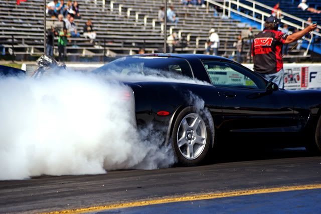

Default Trial & Error !
There is alot of Trial & Error to getting your Launch technique perfected !
Track Prep and Conditions Have a Major Roll in IF your even going to hook up
I use line lock with a two speed burn out and have Very Good Results. Start off in first gear , bringing the RPM up to 4500, then into second gear till 5000 rpm . Let off the line lock and continue through walking out the burnout for another 5 ft. Tons off smoke
PS I run MT 305/40-18 street radials too ! at 20 psi and check tire pressure after each run , it does change with the heat built up !!!
Get great 1.70 launch for my set up, But Tire Life is
