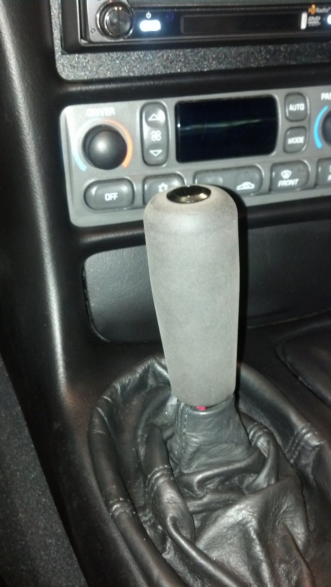

Line lock with a custom Delrin shifter and a pretty sweet button in it.

Got the car back from having the N2MB installed. WORTH EVERY PENNY! Had to download the software to make some adjustments to the TPS Threshold to make the N2MB box work. Really didn't want to have to use my computer at all for this piece of equipment but I can honestly say downloading and using the software was a breeze. If you have a manual transmission and any interest at all in racing this is probably the best dollar for dollar investment you can make. 2 step feature makes staging the car a breeze especially coupled with my line lock.
The no lift shift feature has eliminated the "I thought it was in gear and pinned the throttle to the floor only to discover I didn't have it in gear" mistake. I've made this mistake a couple of times (2nd to 3rd gear....tell the truth we all have!). Prior to having the N2MB box I installed an adjustable Ticks master cylinder which greatly helped with this but turned my clutch setup into what feels like a either on or off setup which I don't really care for with normal around town driving. I'm so confident when making quick high RPM shifts with the N2MB box that I'm actually contemplating removing the Ticks master cylinder and going back to stock. If you are thinking about this product go for it. I highly doubt you will regret it.
