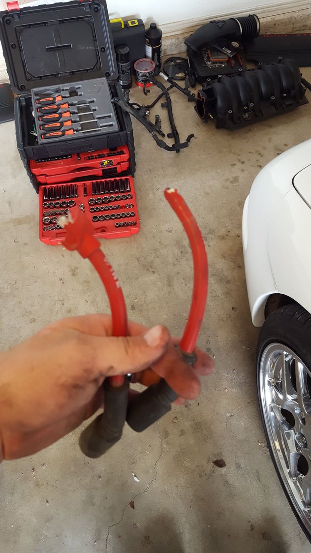

I dont hear any knocking. I bought the car around 3-4 weeks ago so trying to figure all this car out. I did purchase a vararam but ill wait to install it after i get this figured out

Tomorrow my msd wires and it will be back together. I was checking the old spark plugs and they are gapped way more than 40 i know that probably wouldnt have anything to do with being lean but that might be one thing
