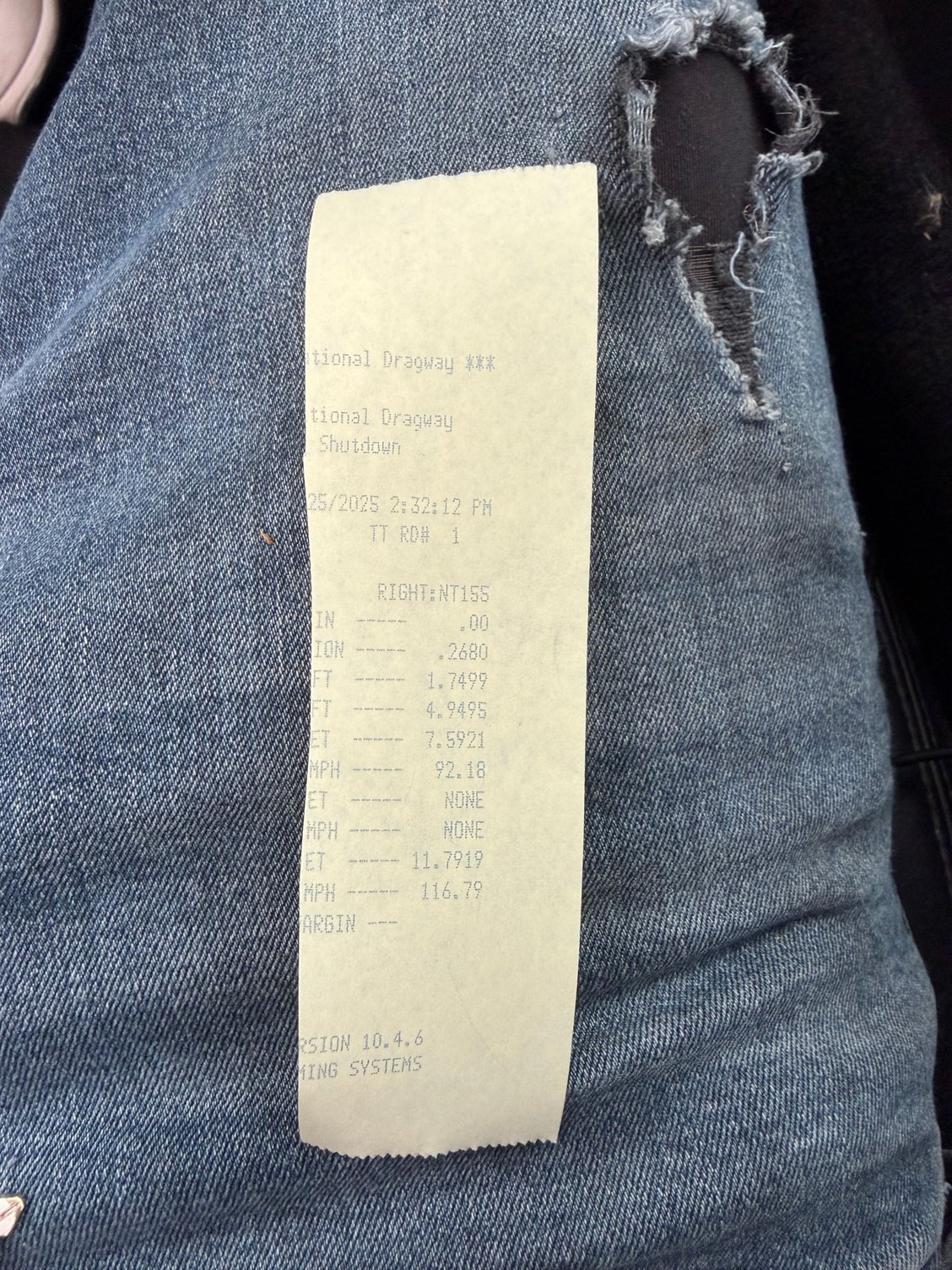

Default New PB!!
60’ 1.75
1/8 7.59
1/4 11.79
H.C.I
S.B.E
Built Trans/Diff
3.90 Gears.
Circle D 3000/3200.
Full Coilover Suspension.
Looking to get some general info on how I could possibly improve times.
thanks for any type of comments/feedback!

For HCI I would expect more than a stock c5z trap speed.

Stick vs auto. Stick always traps 3 mph or so higher.

Congrats! I did 11.93 dont remember the trap speed. The last time I ran it at a track rental I was in the 12s fastest trap speed was 122. I know why though its me being scared to break the rear and the trans again lol.
