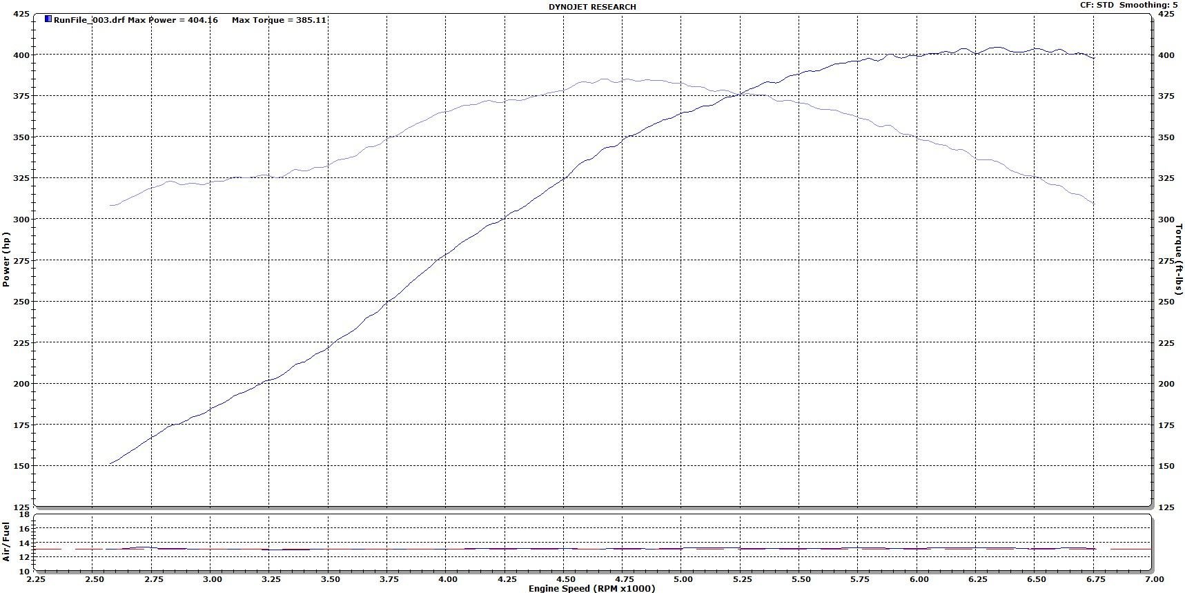

I fulfilled a bucket list item and decided to do a cam and headers on my 03 6sp coupe. Blackwing intake, BTR LS1 Stage 2 v2 cam (with supporting mods), Speed Engineering headers with high flow cats. Pretty happy with the results and the sound/exhaust smell. Drivability is a 9/10 compared to stock. Highway fuel economy is only slight reduced but around town driving is down to 11/12. Is this normal? Also I post the dyno graph, how does this look based on everyone's experience?

Doesn't seem out of the ordinary for power based on slightly inflated Dynojet numbers.
I think I was around 390/360-ish with similar mods on a MustangDyno

As mentioned above its right on par for STD corrections which are typically 4% higher than SAE corrections. So, your numbers are slightly inflated. Which is why most folks require their tuner to use SAE corrections to not inflate their number. Even at 390whp/370wtq a manual c5 is still a really fun driver. Enjoy!

Thanks, what about the shape of the torque curve? Seems like it’s an odd shape toward the lower end.

Spot-on imo. My C5Z made 414 / 396 std on a Dynojet. The only mods were a BTR Stage 2v2 cam, Speed Engineering longtubes/X. Stock airbox.
