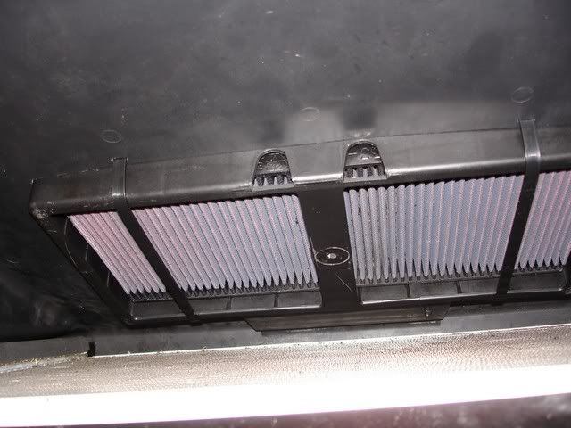

Here is a cold air induction you can do yourself with your stock parts. You will need a washable
filter (K&N or Green) and some Tie Wraps.

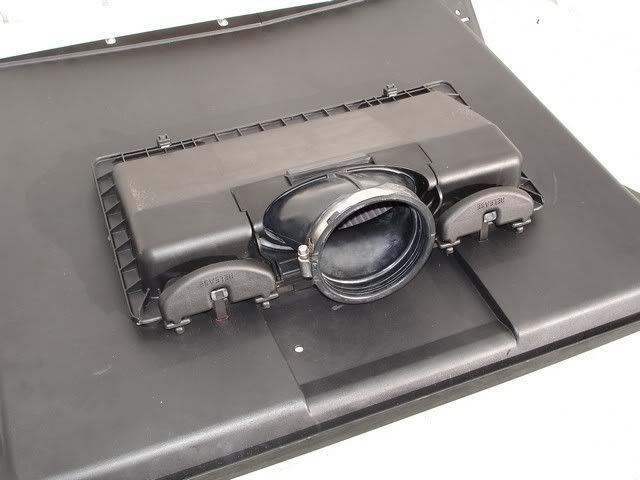

Essentially it is the bottom and filter frame of the stock airbox flipped over, fitted into a hole cut
into the radiator shroud. All held together tightly using Zip Ties and the stock clamps.
A "Write up" for download is attached at the end of this post.
