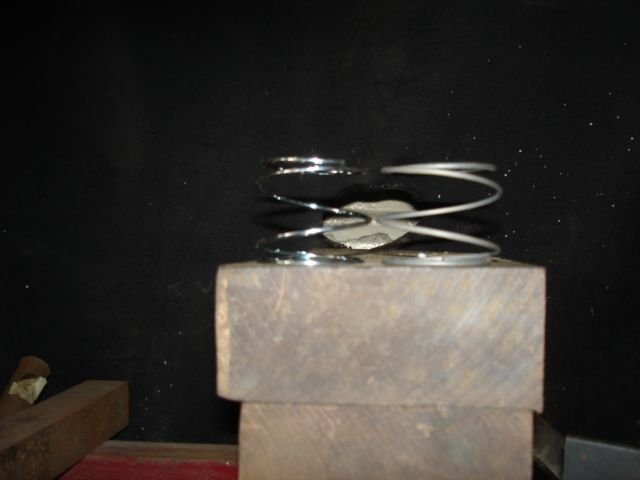

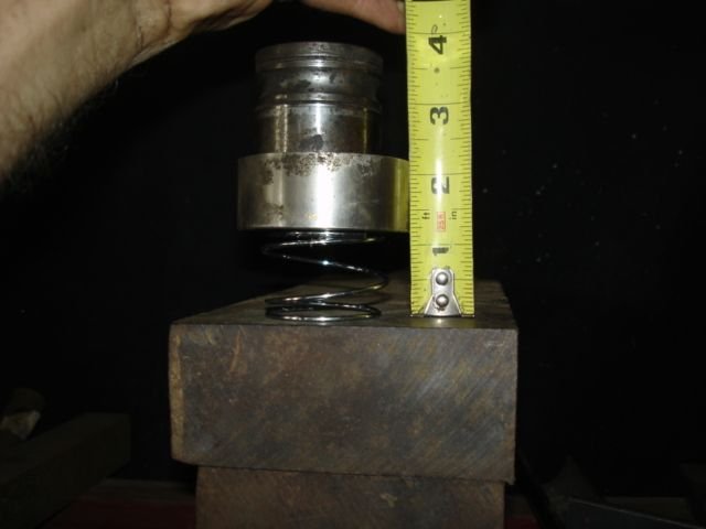

Spring on the LEFT is the spring out of the Corvete America relay...the one on the RIGHT is the facotry spring out of the old relay. All appears to look fine here. But the equal height of the springs has nothing to do with tension of the springs.
The Corvette America spring with a weight on it.
The ORIGINAL spring with the EXACT same weight on it. Notice how much more the spring compresses. It does not seem like much ..but when dealing with vacuum...it makes HUGE difference.
The Corvette America spring with more weight added to it.
The ORIGINAL spring with the same amount of added weight,
