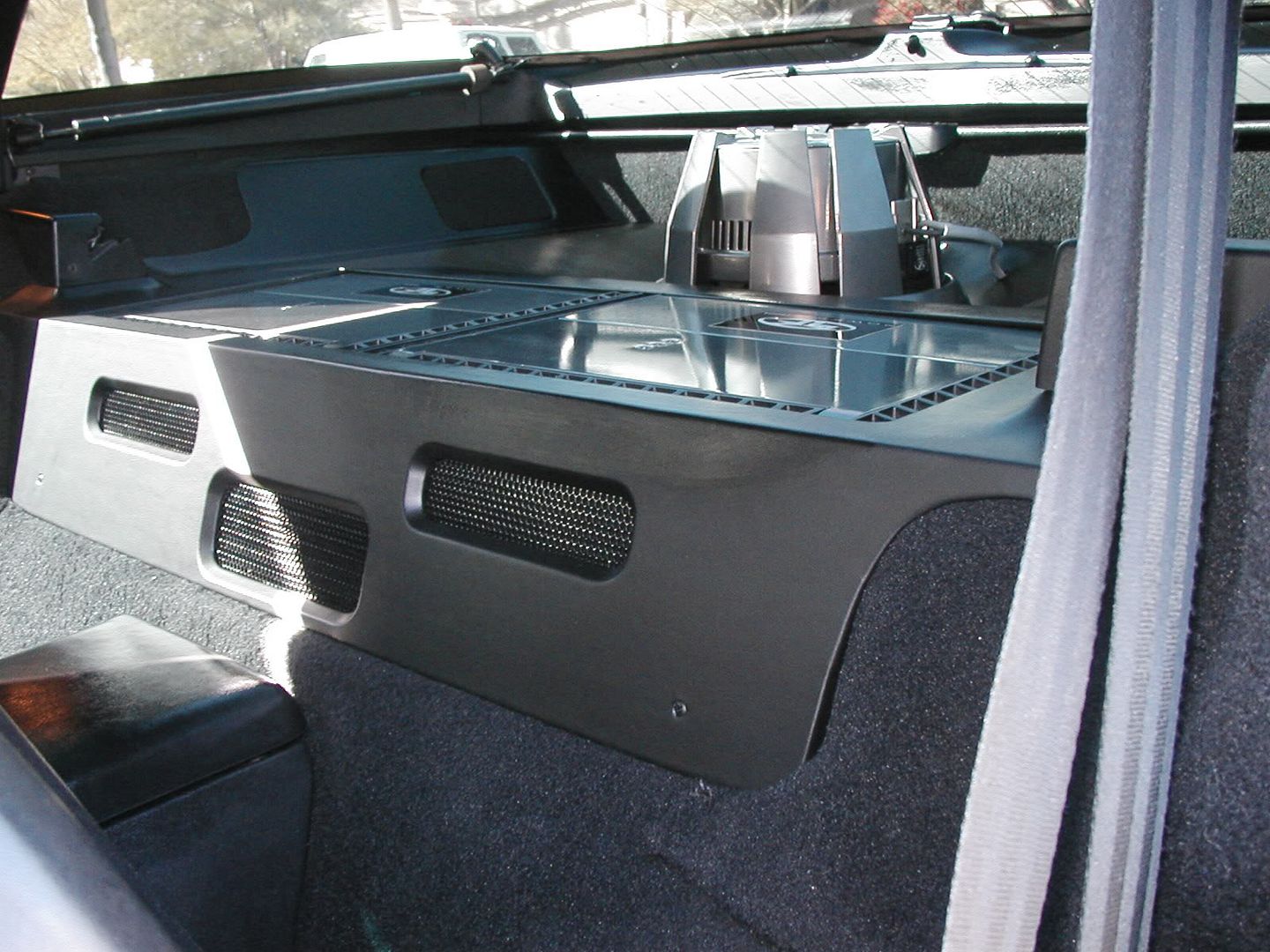

(2004 Machine Silver Z06) I built the box to act as a partition as well. It has a floor for the Oz Audio crossovers and distribution blocks...
...and a false floor for the PPI amps, a PCX 480 and a PCX 2200. I had the covers chromed.

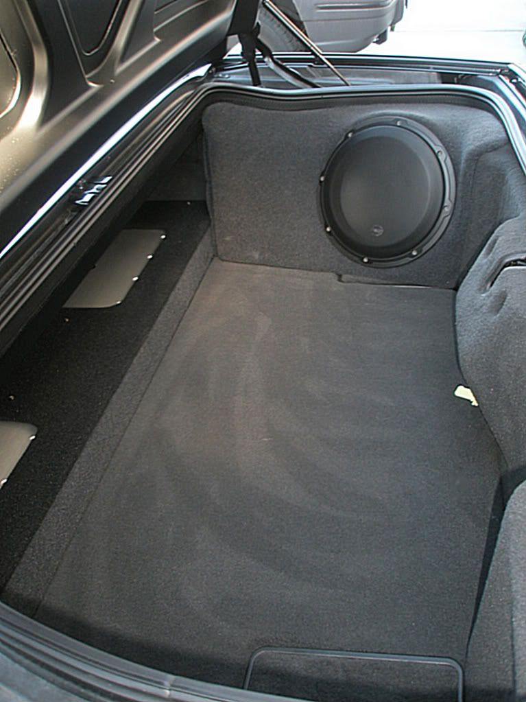

Here it is in the car.

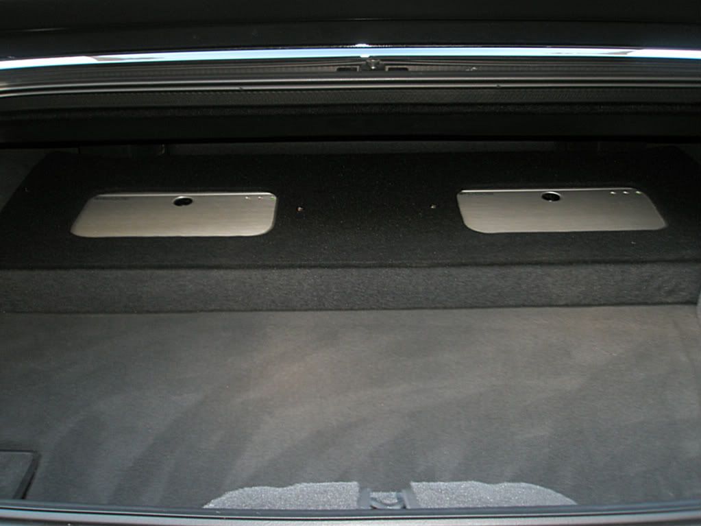

And a trunk view.

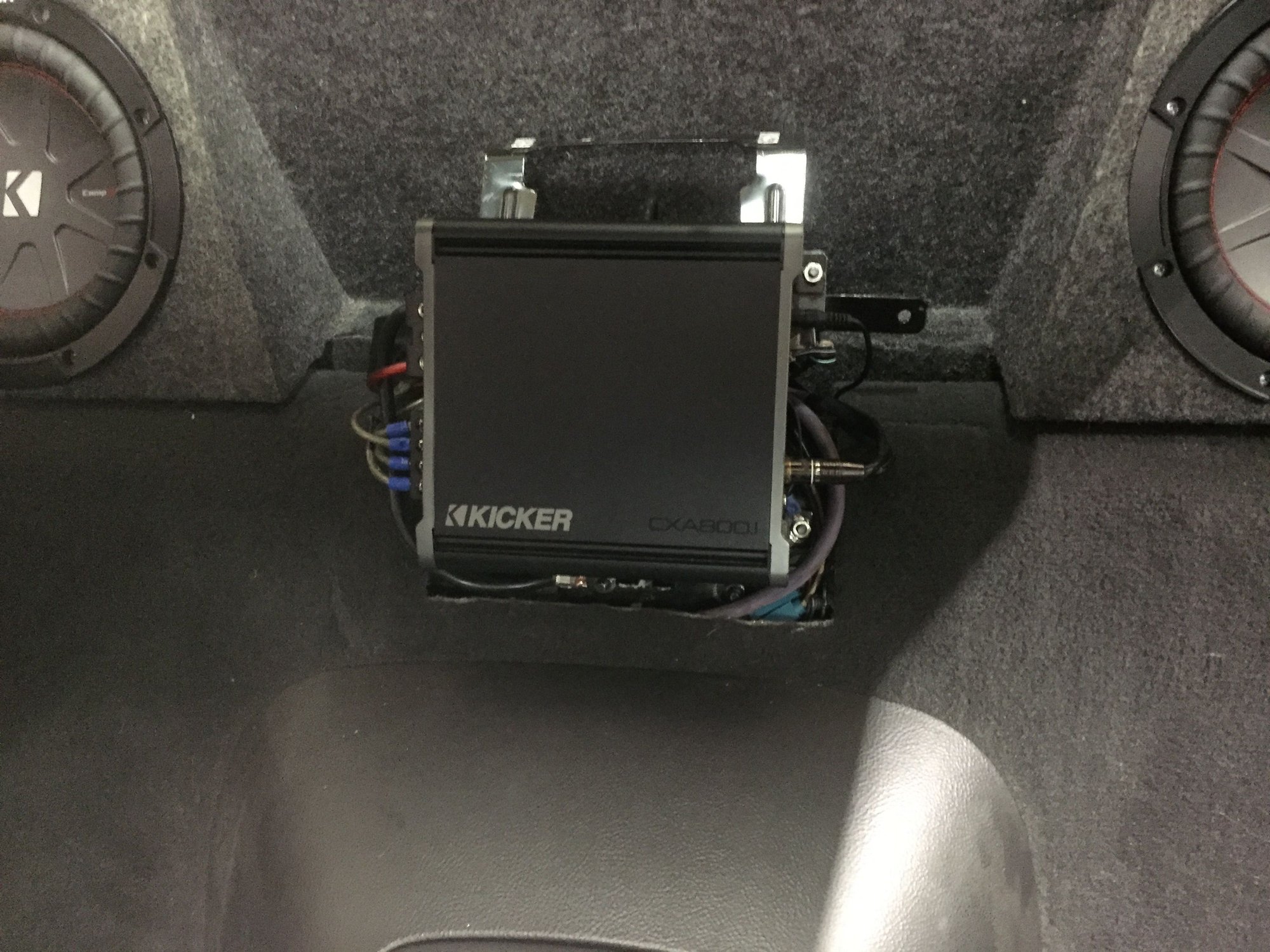

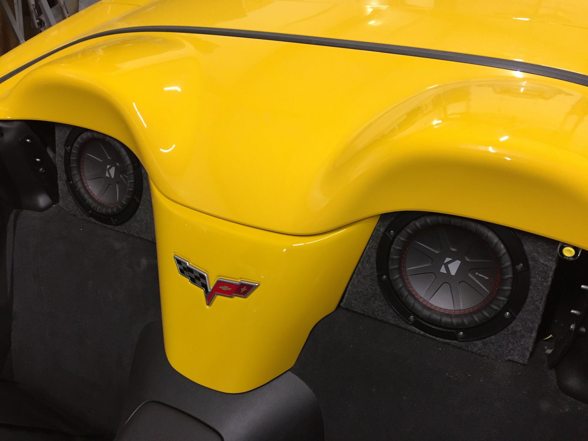

My sub build and amp mounted that fits behind the water fall on my 05 Vert.

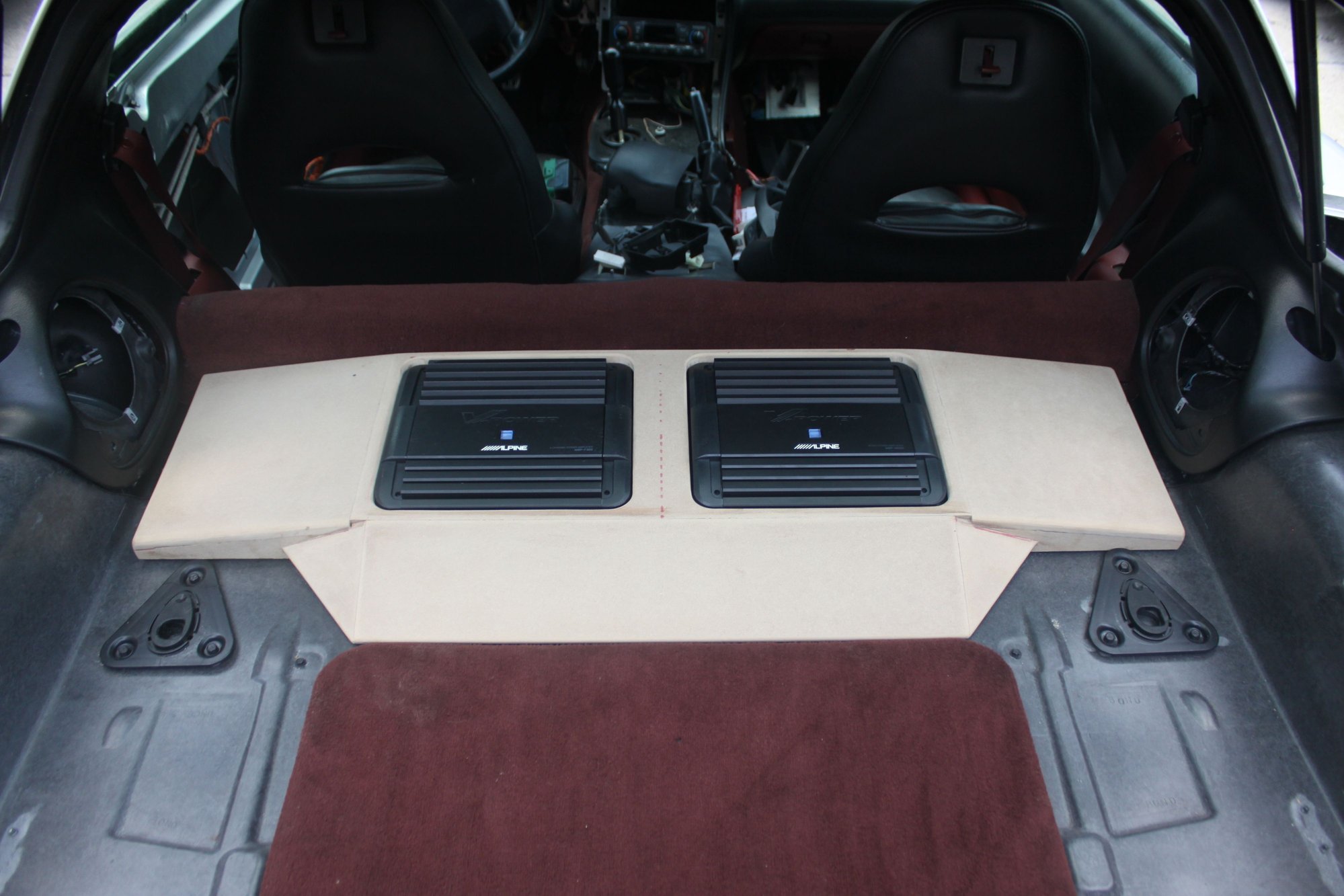

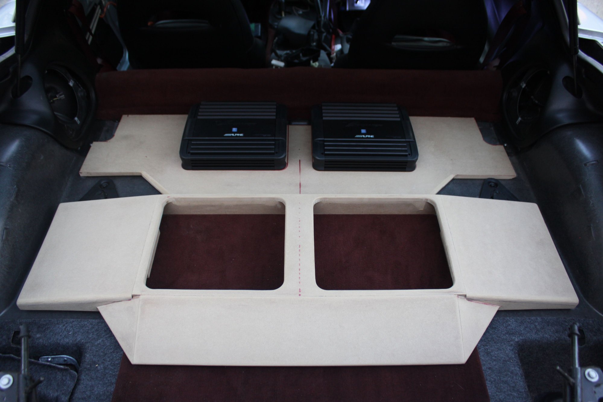

Default C5 Corvette Amp Deck
What I am currently working on. Base for mounting the amps, etc. Removable cover. Not quite done - need to fill the little corners at the front with putty.

Looks like you got a lot of work in it, looking good

Set it up with the sloped front so I can lay my carpet mat over it as needed. It was kind of design as you go. Made the concept up in cardboard and then switched to the MDF. Extra room under the cover for crossovers, etc. as needed. Wiring will go out the back corners and over the center. Short runs to the ground points on each side. Alpine MRP-F300 four channel and Alpine MRP-M500 single channel amps. JL Audio 10" in the "hole", Infinity Reference 6500cx component speakers in the doors and Infinity Reference 6002i coaxial speakers in the rears, Pioneer AVH-X391BHS DDIN HD radio driving things. I will also add in a Pioneer backup camera.
