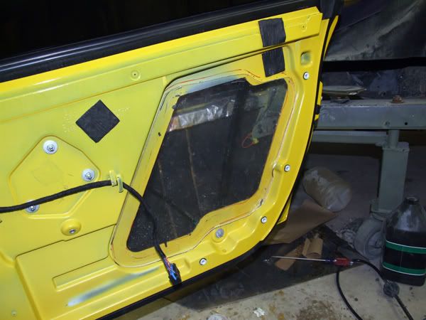

Posts: 1,890
Likes: 7
From: Newcastle Oklahoma
Not really an update on the box but the whole project. I am waiting to paint the box at the same time that the trim pieces get painted. All the none painted trim pieces will be covered in faux leather. That stuff isn’t cheap. All the sound deading is from Secondskin. This project has turned into a monster.
