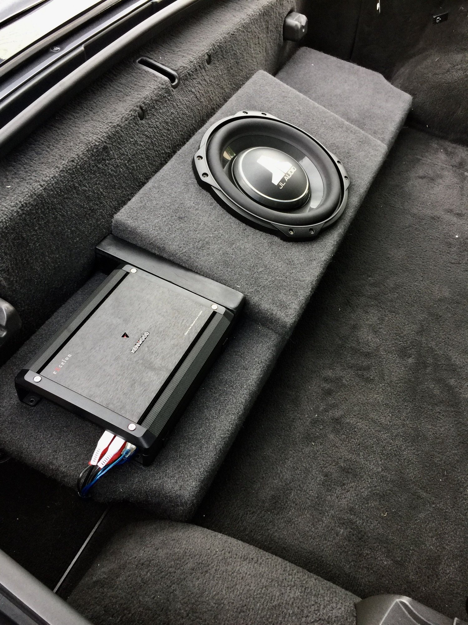

I just wound up putting the box and amp in the rear. The sub was too loud behind my head. The amp is removable and can put the sub towards the front if I wanna store the targa top
Looks nice.
Good install!
