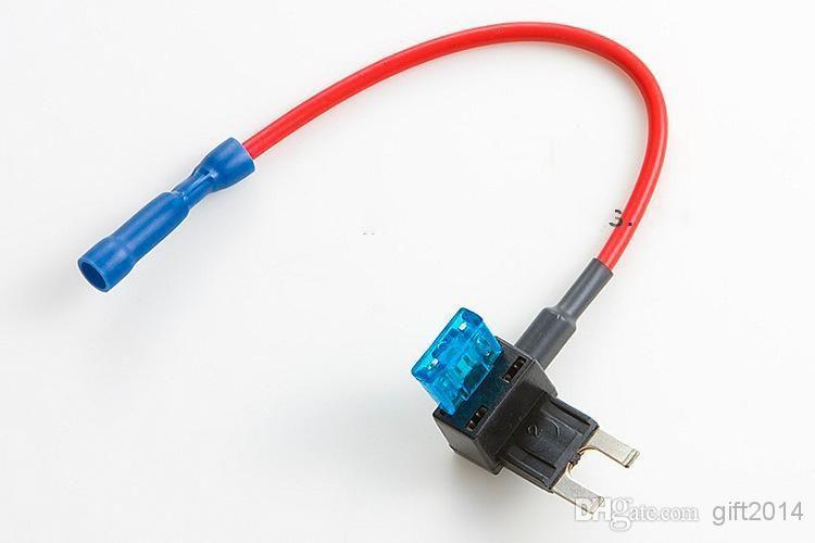

You could also use an "add a circuit" fuse tap and tap an existing switched circuit in either fuse box.
https://www.google.com/search?q=Add+A+Circuit+mini+fuse+adapter &oq=add+a+&aqs=chrome.5.69i57j69i65j69i6 0l3j69i59.4282j0j7&sourceid=chrome&ie=UT F-8
https://www.corvetteforum.com/forums/c6-corvette-general-discussion/3969710-12v-switched-source-from-fuse-panel.html

Have you looked into using a fuse tap? You can find a fuse that is switched power (ie, heated seats, radio, windshield wipers) and use that to power your cutouts.
