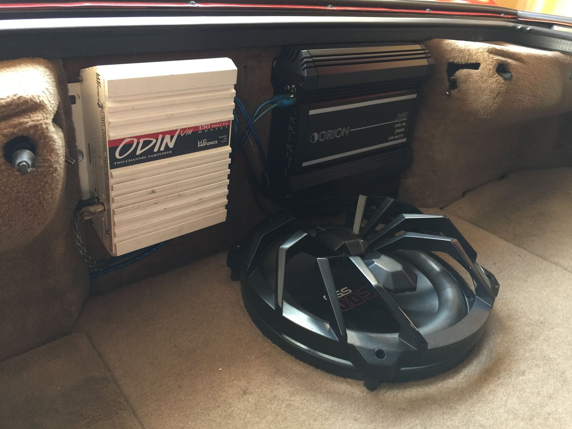

^ When I went from a modern-era class D two channel amp powering my mains to an old-school class A/B and the sound was obvious and crystal clear.
Current setup:
