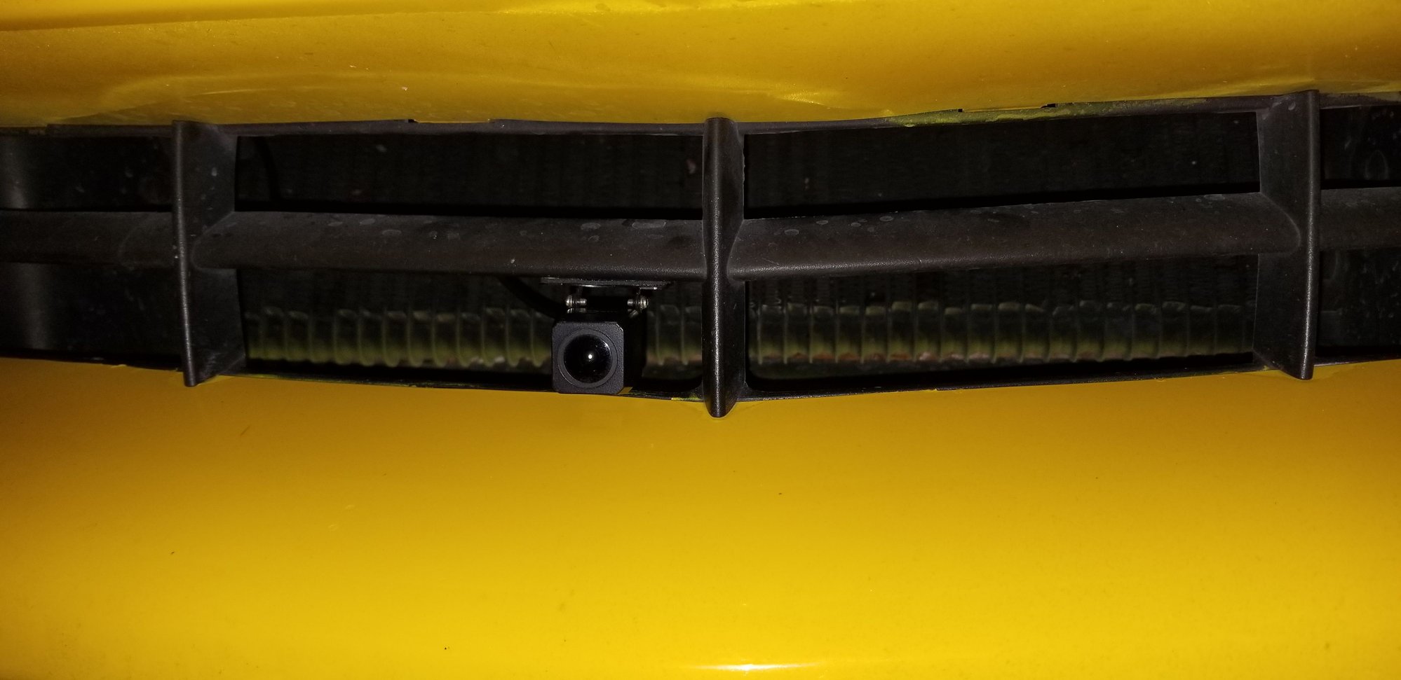

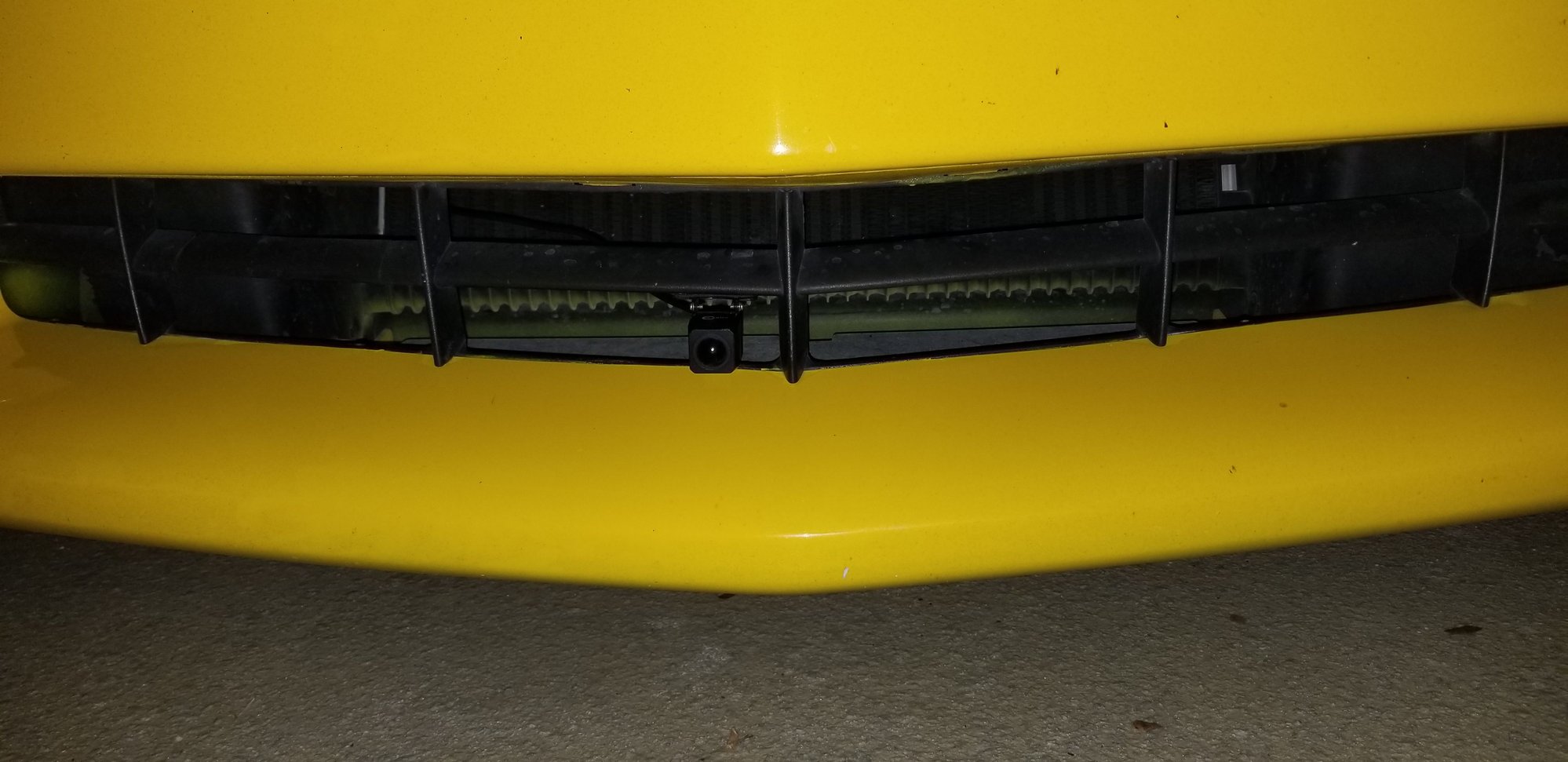

I'm thinking of going with one of the cheap ones posted in this thread for my front facing camera. For those of you that have one on the front, where did you mount it for the best view without it getting ripped off going up steep driveways? Any pics? Thanks.
I mounted it with 3M tape (which it came with) to the grill area. Not under the bumper lip, so no issues with ground clearance.
Front camera mounted in grill.
Front camera mount closeup.

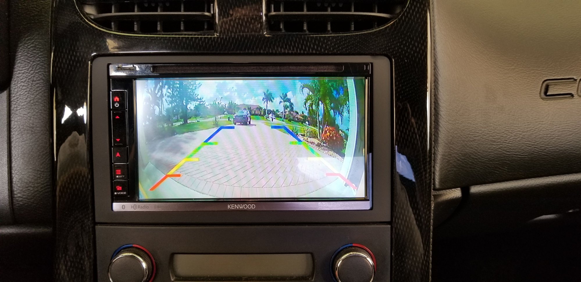

Front camera view on DNX574S (Esky 720P Camera)
Rear camera view on DNX574S (Natika 720P Camera)

Ah, much easier to find a place to mount on a C6 than my C5. Thanks for taking time to post the pics and quick responses.
Can you turn the lines off on the front camera or do you find them helpful?
Yes, you can turn off the lines. I like them though, the red line is the distance I want from a concrete parking block.
