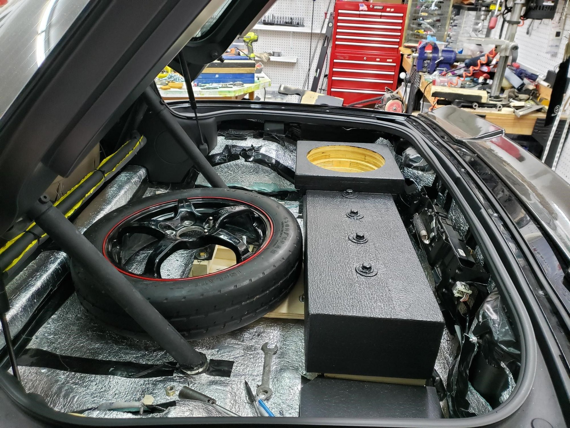

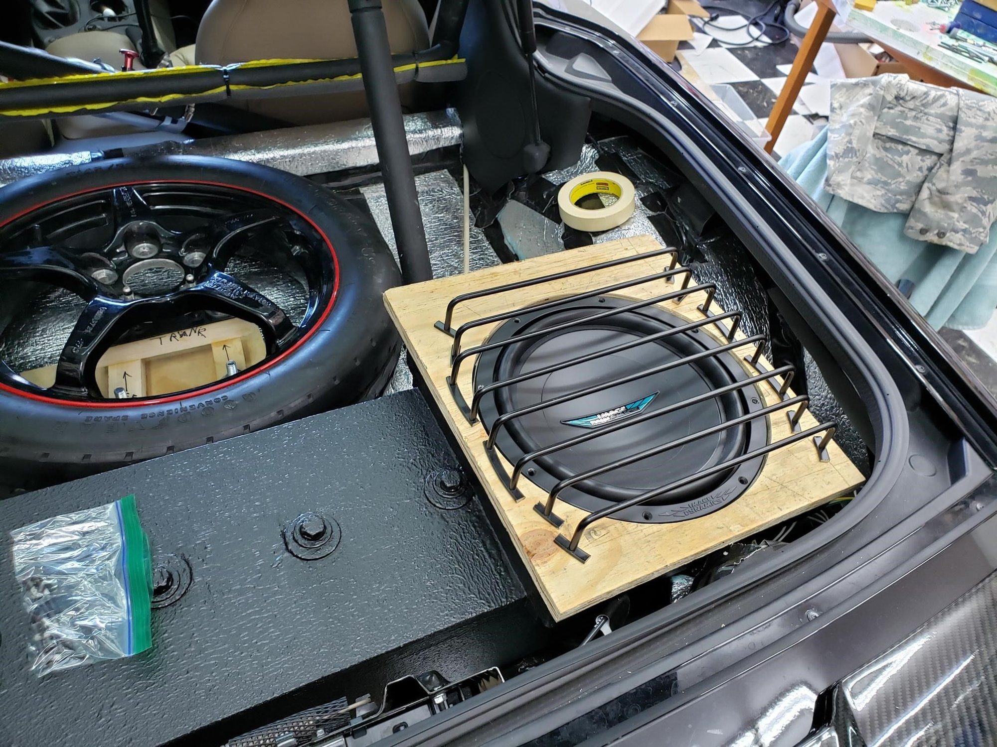

Here is the status of where I am at right now...just finishing up the sub box grill. Still need to do sound deading everywhere, door speakers, and head unit/amps. Gonna put plain black trunk liner everywhere when done.
I know The sub box looks really ugly, but I don't care....did you notice the roll bar and spare tire ? Yup, it's ugly and it's my car, and I'll take function over looks every single time. Besides, if someone says oh man your stereo looks great, and it sounds like poop, well then it sucks. I'd rather had some one say, that looks like poop...and it's the best sound system I ever heard.
My sub box has 1-1/2" x 1-/2" square pine battons in a skeleton frame under the 3/4" baltic plywood. Also, you can see I have FOUR braces in the middle. 1/2" all thread going through the same sized square pine wood, using them as dowel rods kind of. So, like I stated, I can park my car on top of this thing, and it wouldn't budge at all. Overbuilt...yes. Necessary, for me , yes, that's what I do.
Sub is super clean all the way down to 20hz. My Audio Control DSP will take care of the EQ for it and provide the best bass response possible. If you don't have 9 bands of EQ for your subwoofer, then you are missing out on a TON of performance and tuning, in my opinion.

I can honestly say I’ve never seen a subwoofer box built so strong. I threw mine in yesterday, without the port installed yet. It’s got some serious cancellation. Louder with the windows down. I’ve got an audiophile friend that had me make a hood for the last box and it seemed to help. I’m honestly thinking of firing this one down and I’m definitely going to port it into the passenger rear corner. If I can’t get this sub to do what I want I may end up changing subs to something a little smaller that can either be pointed into the rear corner or possible do a band pass box. I’ve never done one before and have always wanted to try it. I was truly hoping I could figure out a way to store my top in the back but I don’t think I’ll ever get the sound I want and be able to do it. Honestly taking the top out blows my hair everywhere and the sun is in my face anyway....

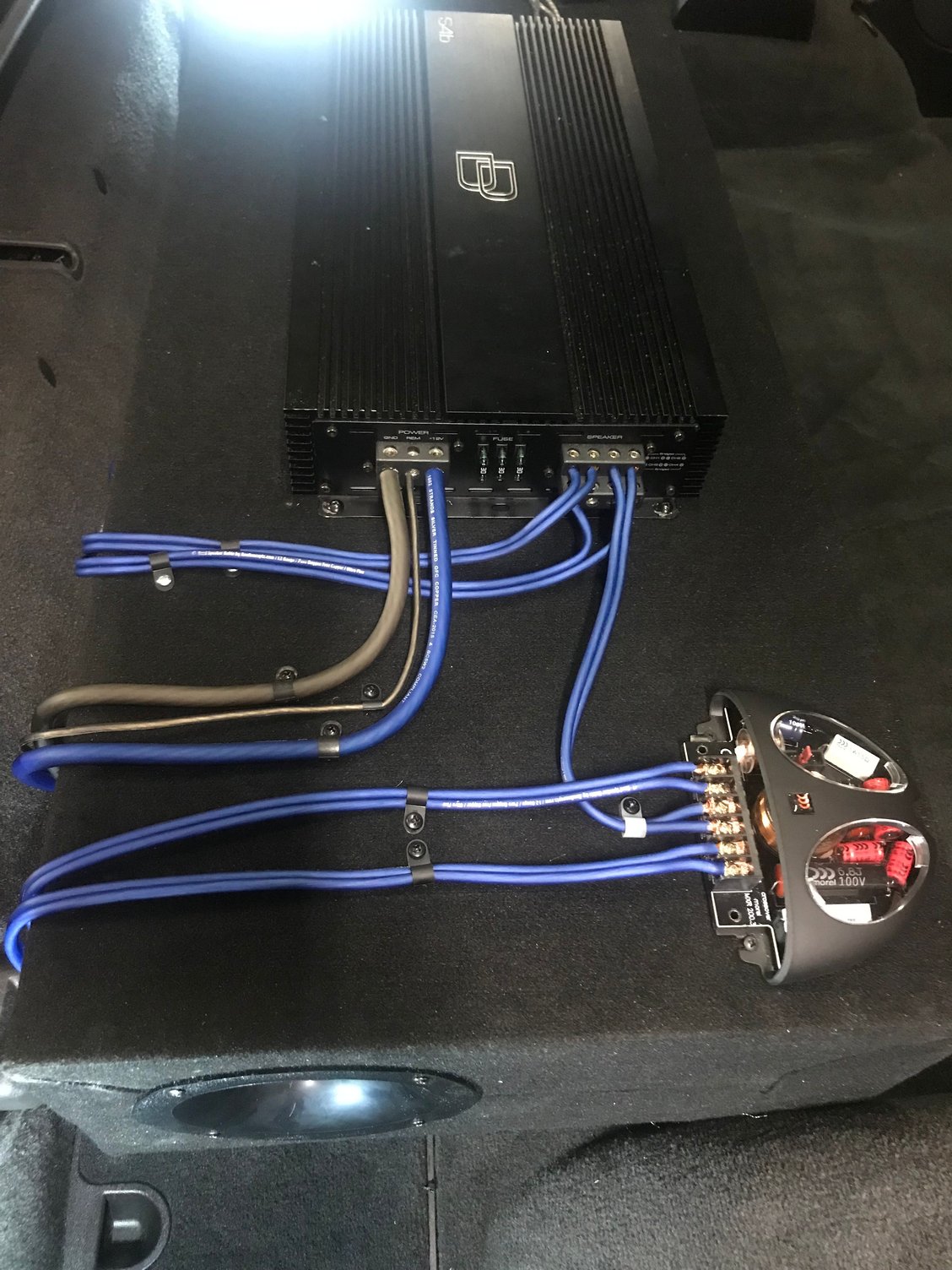

This is what I ended up with for now. I wanted to do something different that hides the wires but really can’t come up with something creative right now. The sound is incredible and it’s not a show car so this may be it! Anyway, thanks to all of you that chimed in with ideas.
