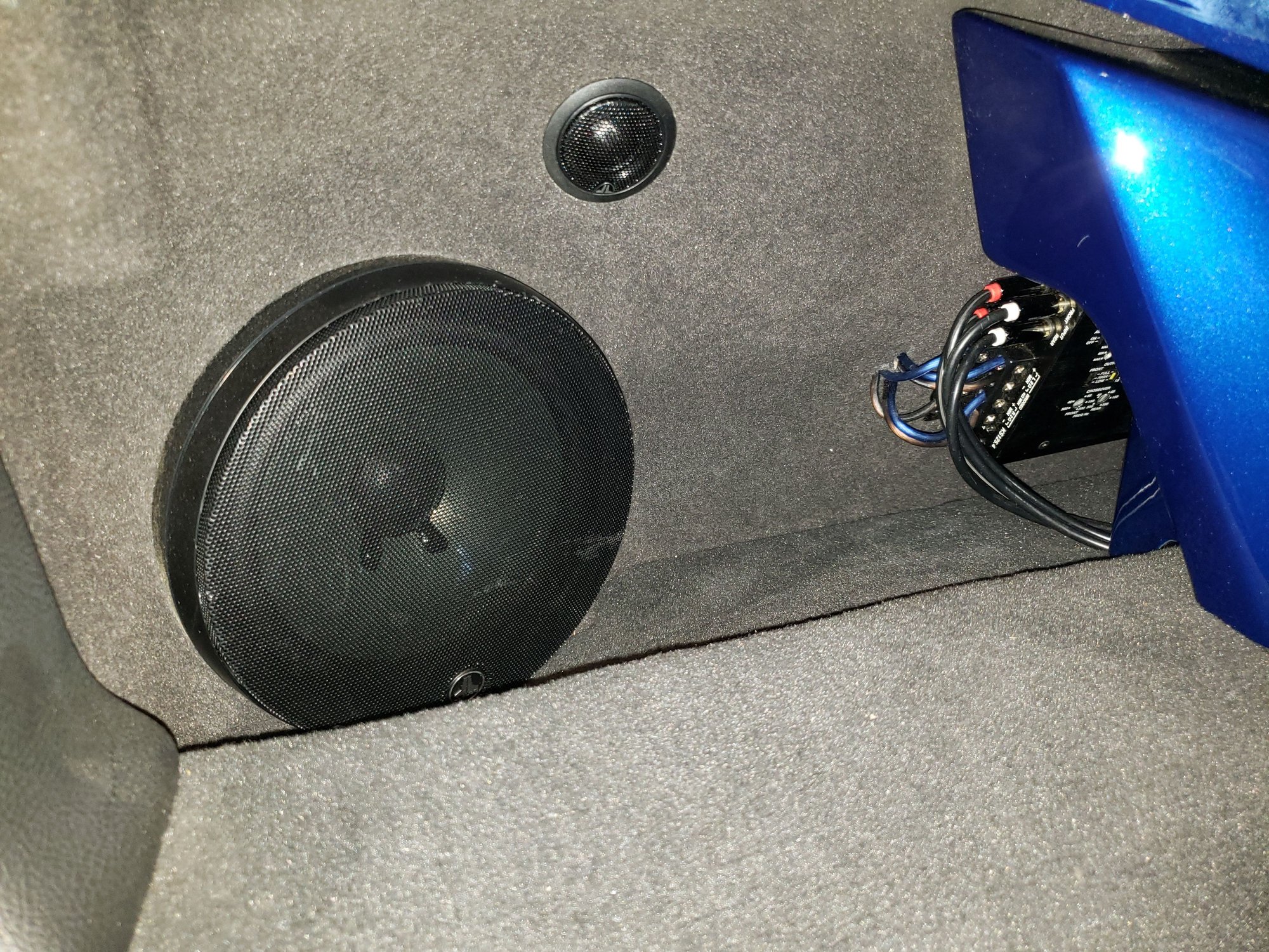

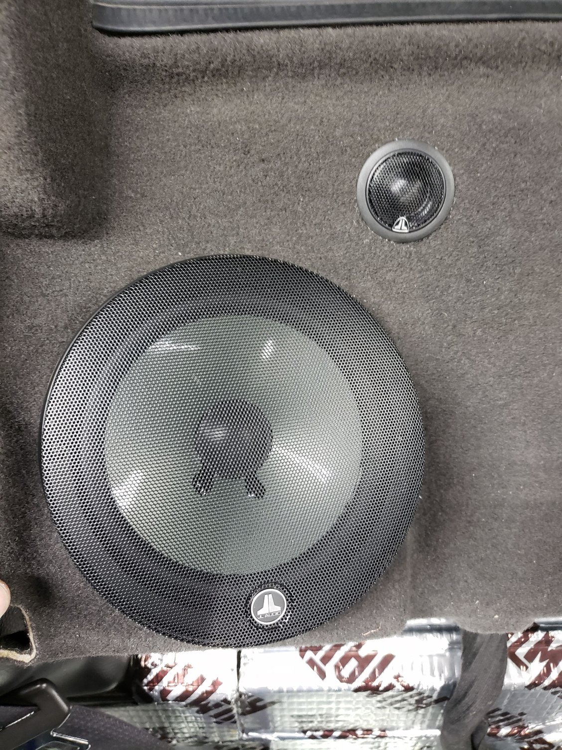

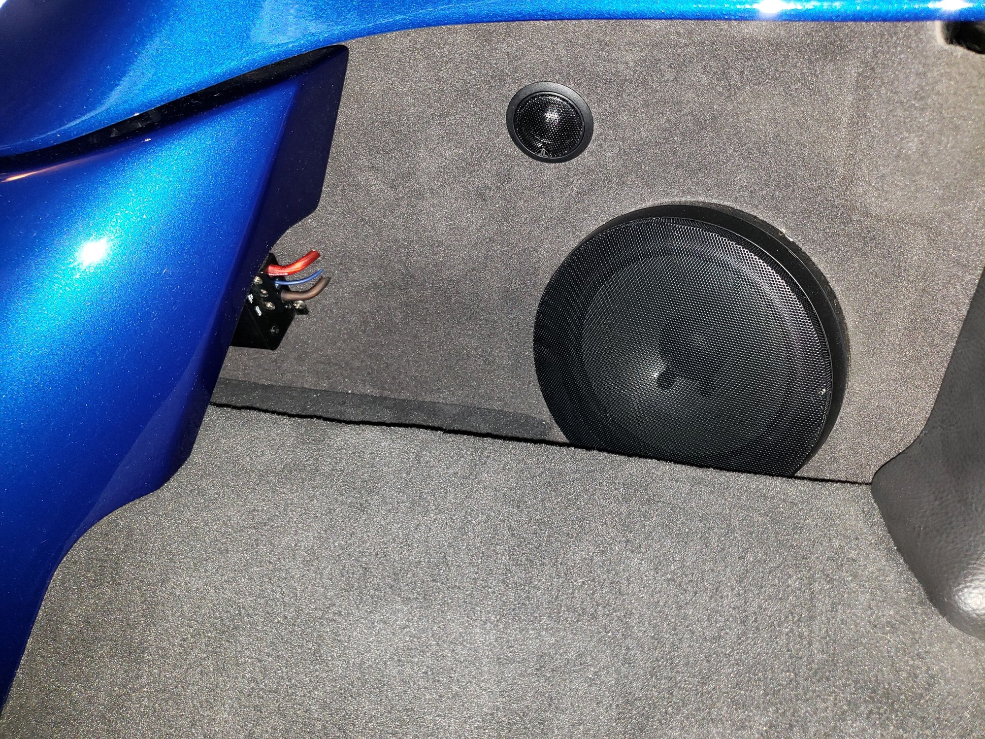

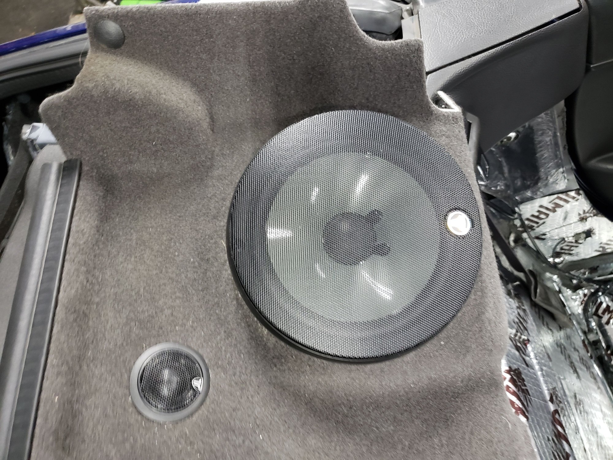

Mounted the JL audio C2-650 components in place of 5.25 Bose today. Looks pretty good with very minimal mod. Perfect fit for x-overs too.

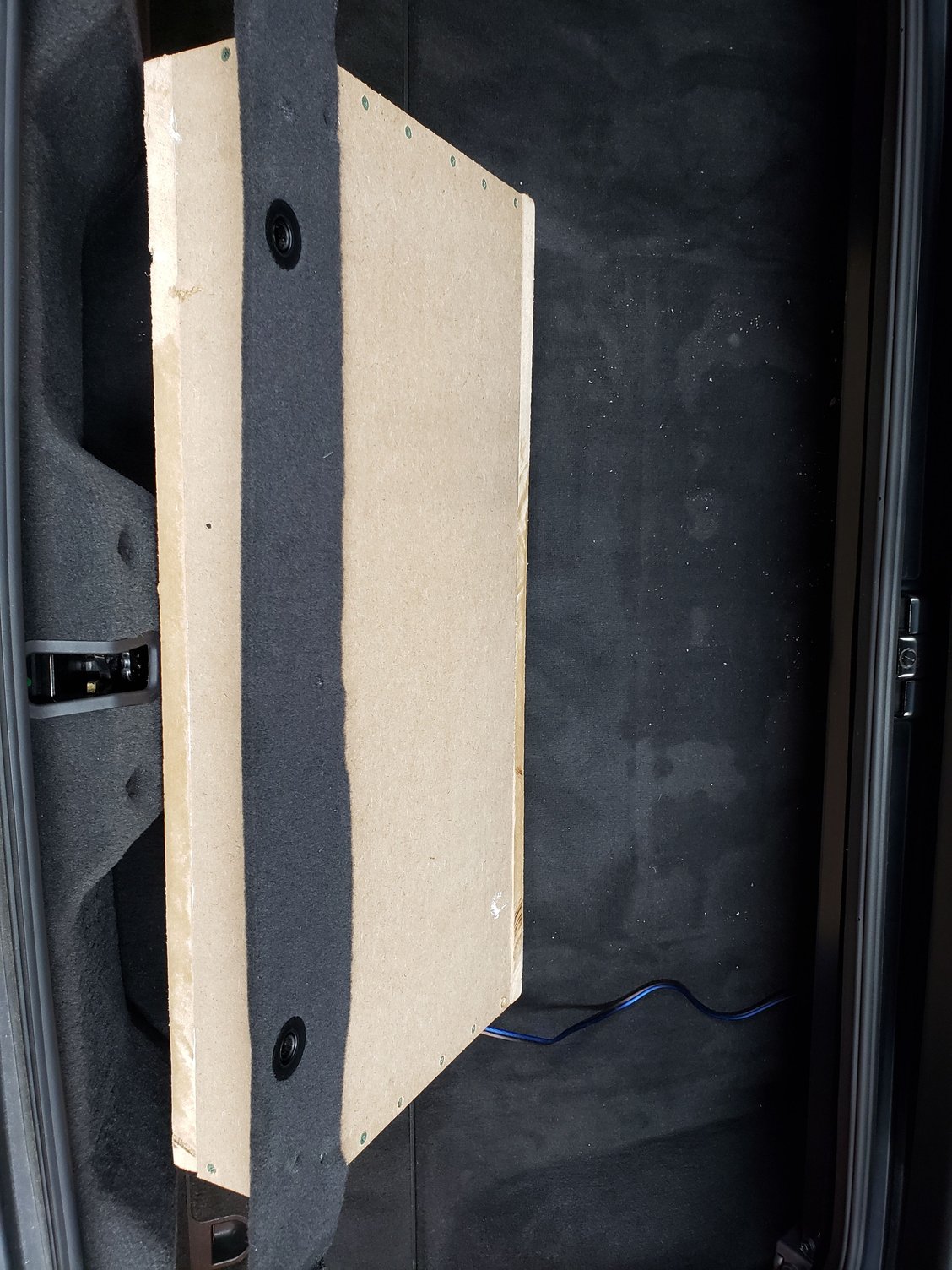

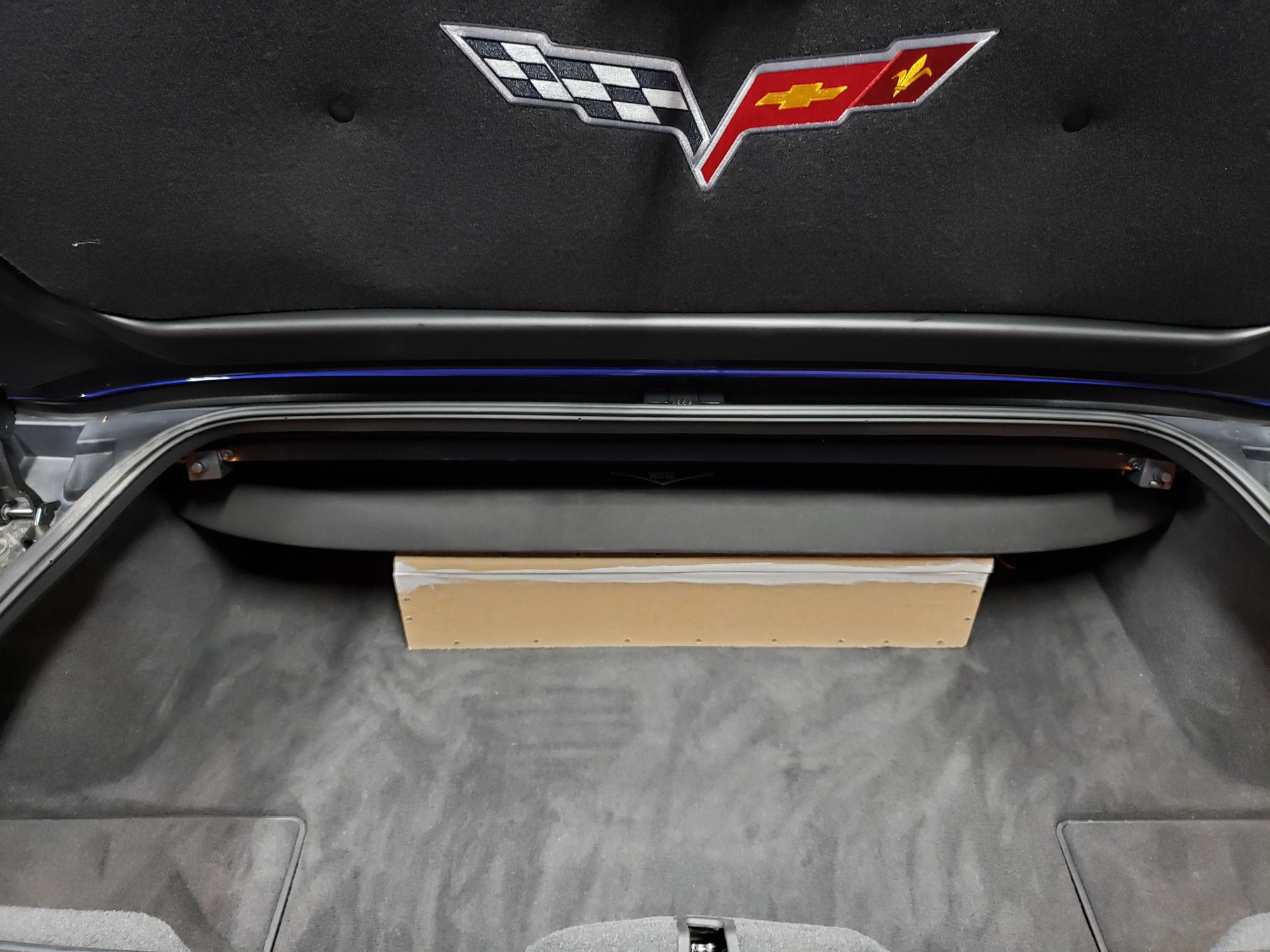

built the box the other day. Ended up being slightly bigger since I went with 3/4" MDF rather than 5/8". Still need to put carpet on it and modify the partition, but so far I think it sounds awesome! I'll get some pics later, but so far it does NOT interfere with the Top when folded down. However, I'm curious if the woofer will extend far enough to actually hit the cloth...... haven't had a chance to crank it with top down. IF it is too close, I will probably end up building a flat box that has a slightly bigger footprint to make up for air space. I'm also considering another box but PORTED just to see what the difference is.
I will say for sure that the sub makes a BIG difference with the top up.. it's going to take a while to get it dialed in because this head unit has WAY TOO MANY adjustments!!!!

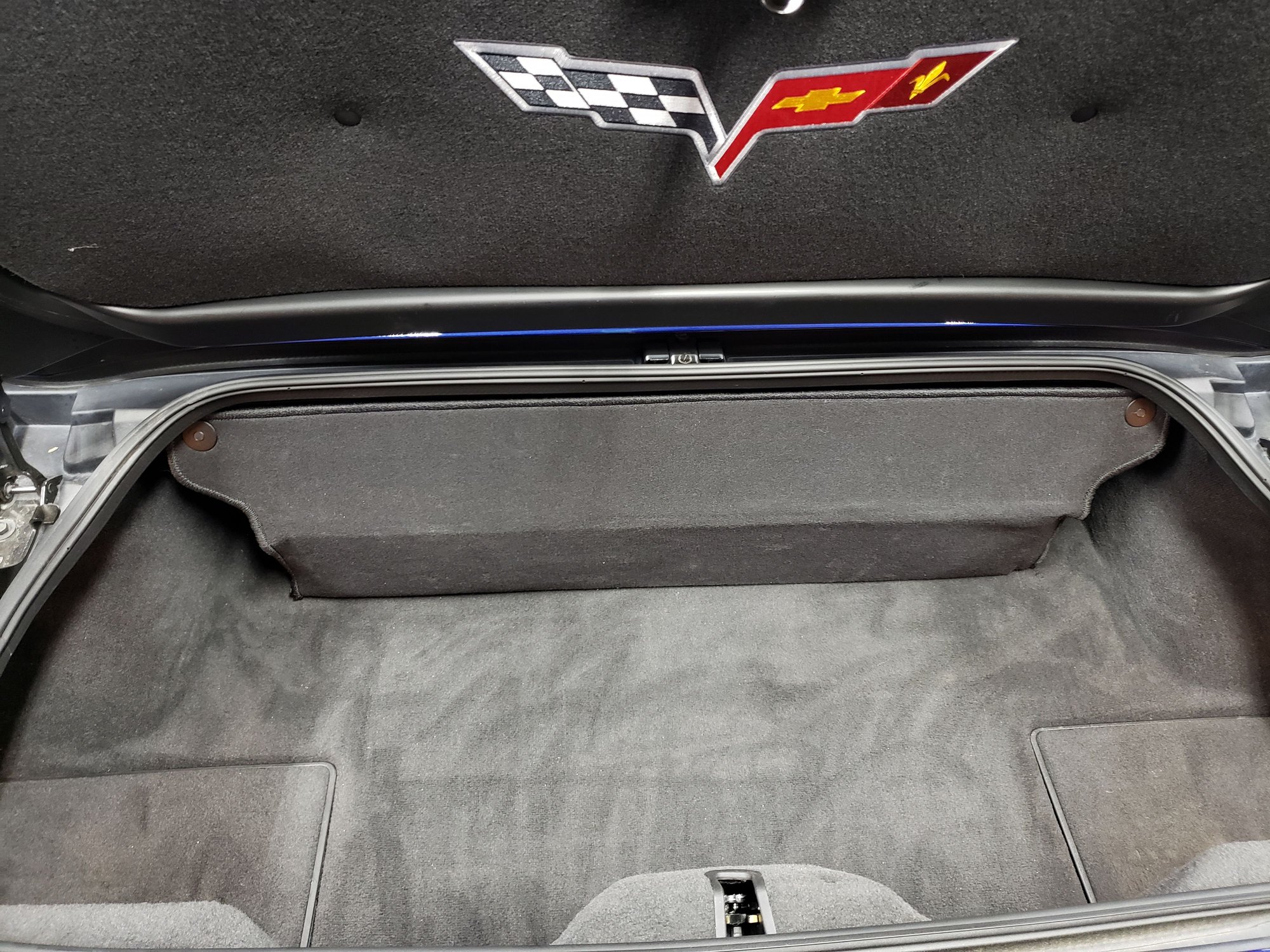

Got the sub box in and covered. Still experimenting though. Sounds good with the top up, and the sub is clear of the top when it's down.....BUT.... it sounds a bit more "muffled" when top is down. Pics below of set up now. However, I'm considering a flat box rather than angled to give a bit more clearance from the folded top.
I did some positioning and it definitely sounds the best with the sub facing the rear And the current box just barely fits that way. I have plenty of materials to try a couple more options.... 1. Ported enclosure, 2. Flatter box facing the rear.
Personally, I think it looks horrible in trunk at the moment, but I'm just starting. Trial and error hahaha. More than likely will end up building a different enclosure to go with option #2. The box only needs to be about 3" deep so I wont sacrifice much trunk space. It all comes down to maximum sound or maximum trunk space ....

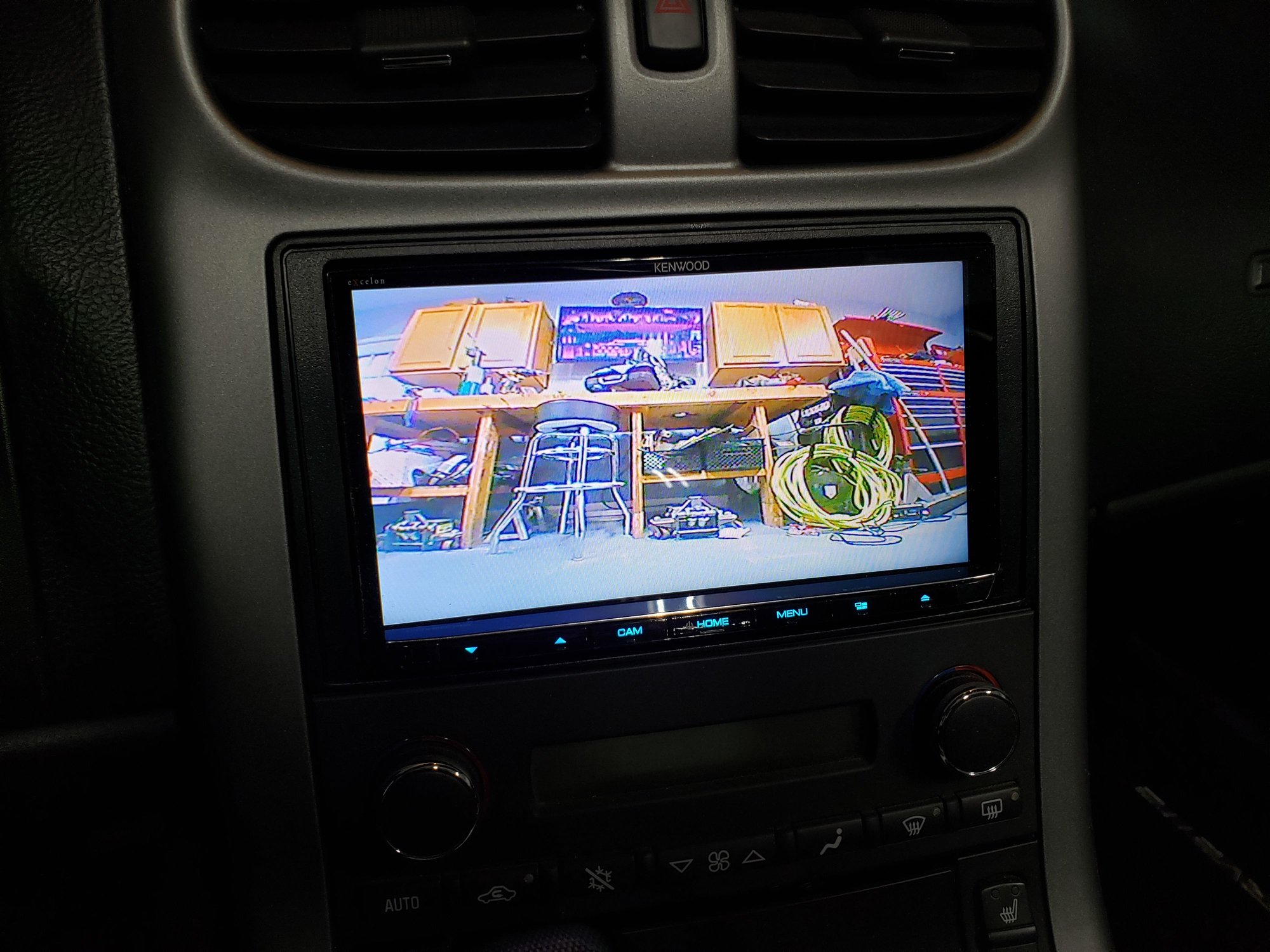

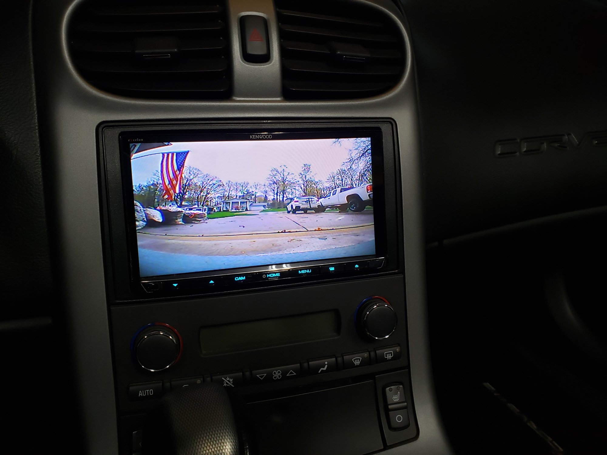

Front camera view
Section of partition screwed to box to hold in place using factory clips
Double din installed
6.5 JL components in rear

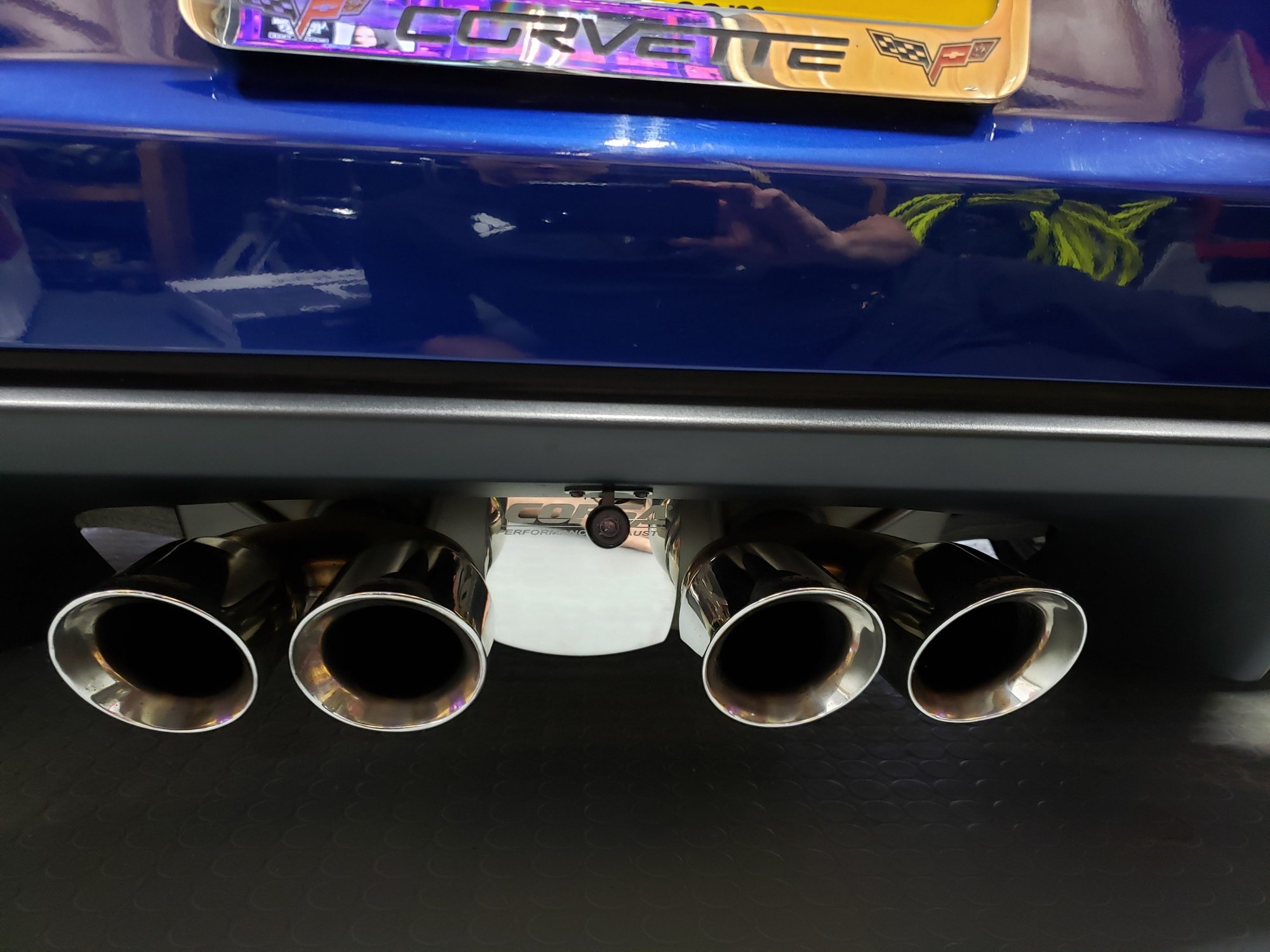

Rear camera view
Rear camera mount
Sub box under folded top
Front camera. Mount
Sub box

The partition is stock. It normally goes from trunk to behind seat
I'm thinking it sounds muffled because the top folds down within an inch and doesn't allow the air to breath.
When I have the box facing rear in trunk it hits reay good
