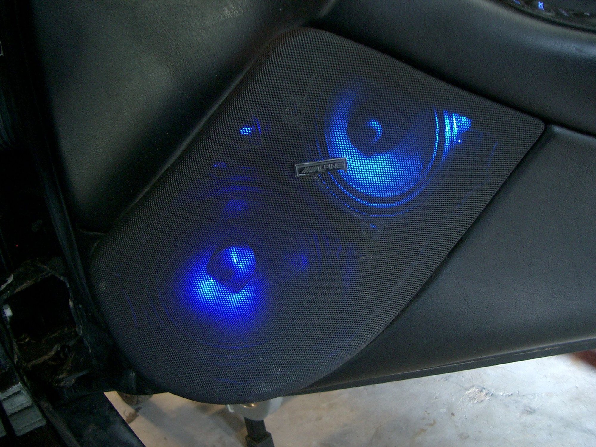

Ran Alpine's SPX system in my 97, then in my 02. Built a custom MDF/ Fiberglas mount for the 6.5" and 4" drivers in the door. The 4" had a sealed enclosure. Originally, these were driven off a single channel and Alpine's passive SPX MB crossover. Tweeters were re-loated to custom-molded pods in the A-pillars. Later when I installed the system in my 02, I switched to an RUX C701 active crossover. and each speaker got it's own channel (I deleted the rear speakers entirely)
