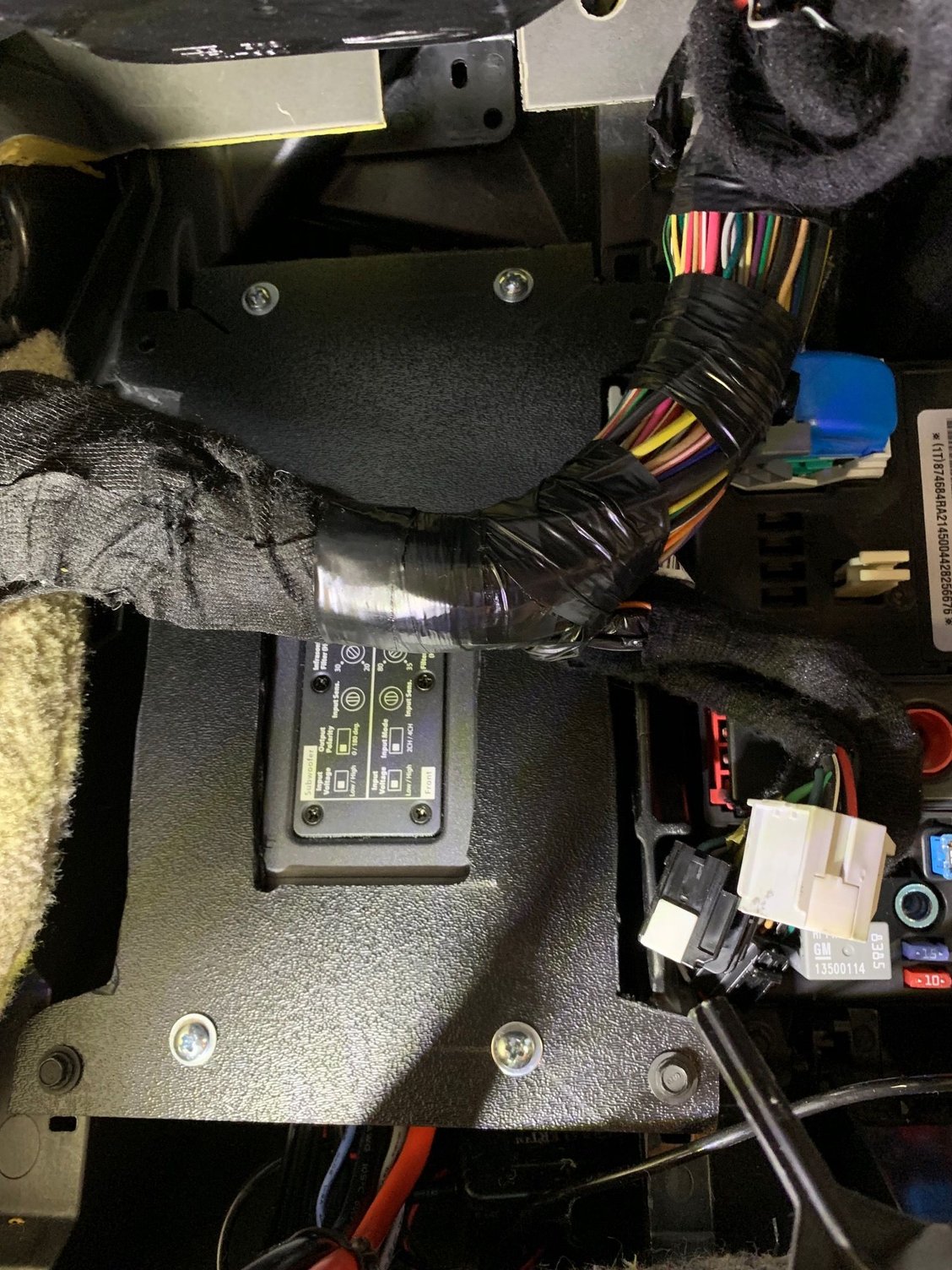

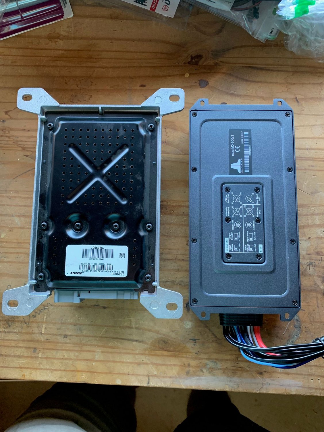

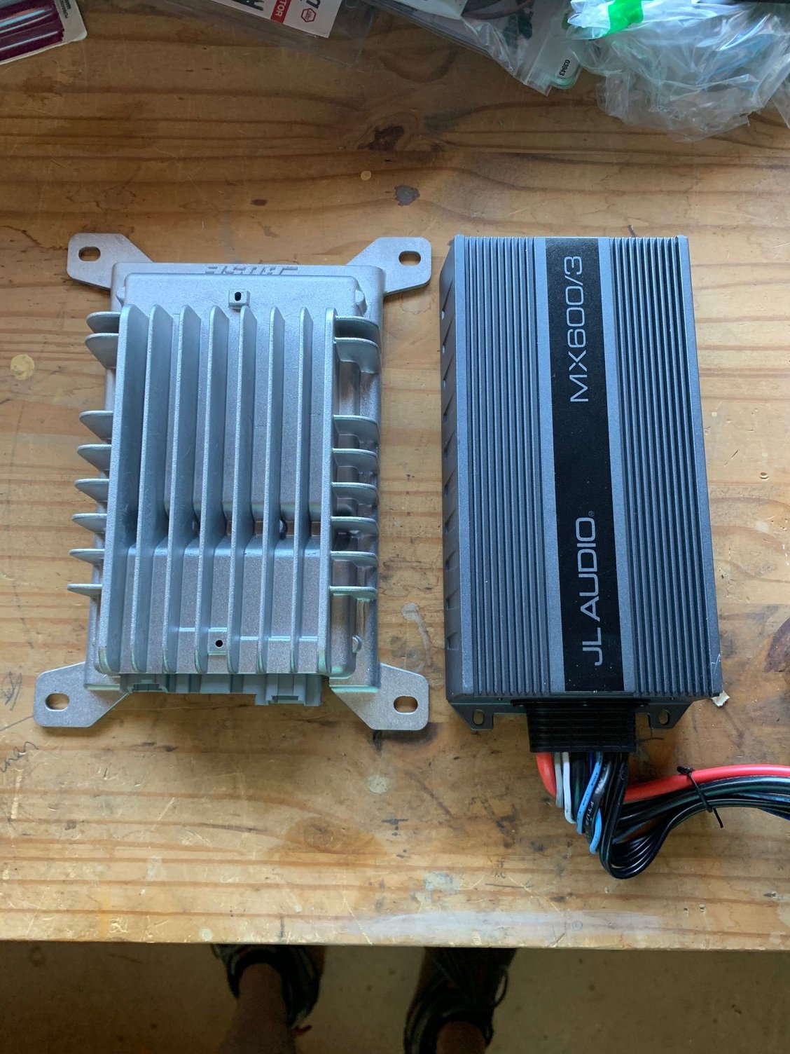

The Bose amp is located in the front of the passenger footwell. You pull back the carpet to expose a fuse panel on the right and the bose amp on the left. It has 4- 9/32" screws holding it in and there are 3 plugs you have to unplug to get the amp out. I am replacing the head unit and amplifier so I am not concerned about the inputs and outputs on the amp are but you could probably figure out what they go to if you have a multi meter and a little time. The bulk of the wires would be outputs to the various speakers.
Bose amp on Left. This is how it is mounted in the car. Replacement JL Amp on the right
Top view of both amps.
JL amp in place after tracing the Bose amp onto ABS plastic (1/4") and cutting out a bracket to fit the Bose amp location. I made the upper end of the bracket about 1" longer to accommodate the mounting tabs on the new amp. The mounting ears are the same as the Bose amp. I also cut out a window in the bracket that exposed the cover for the amplifier controls. I can get to them without unmounting the amp.
