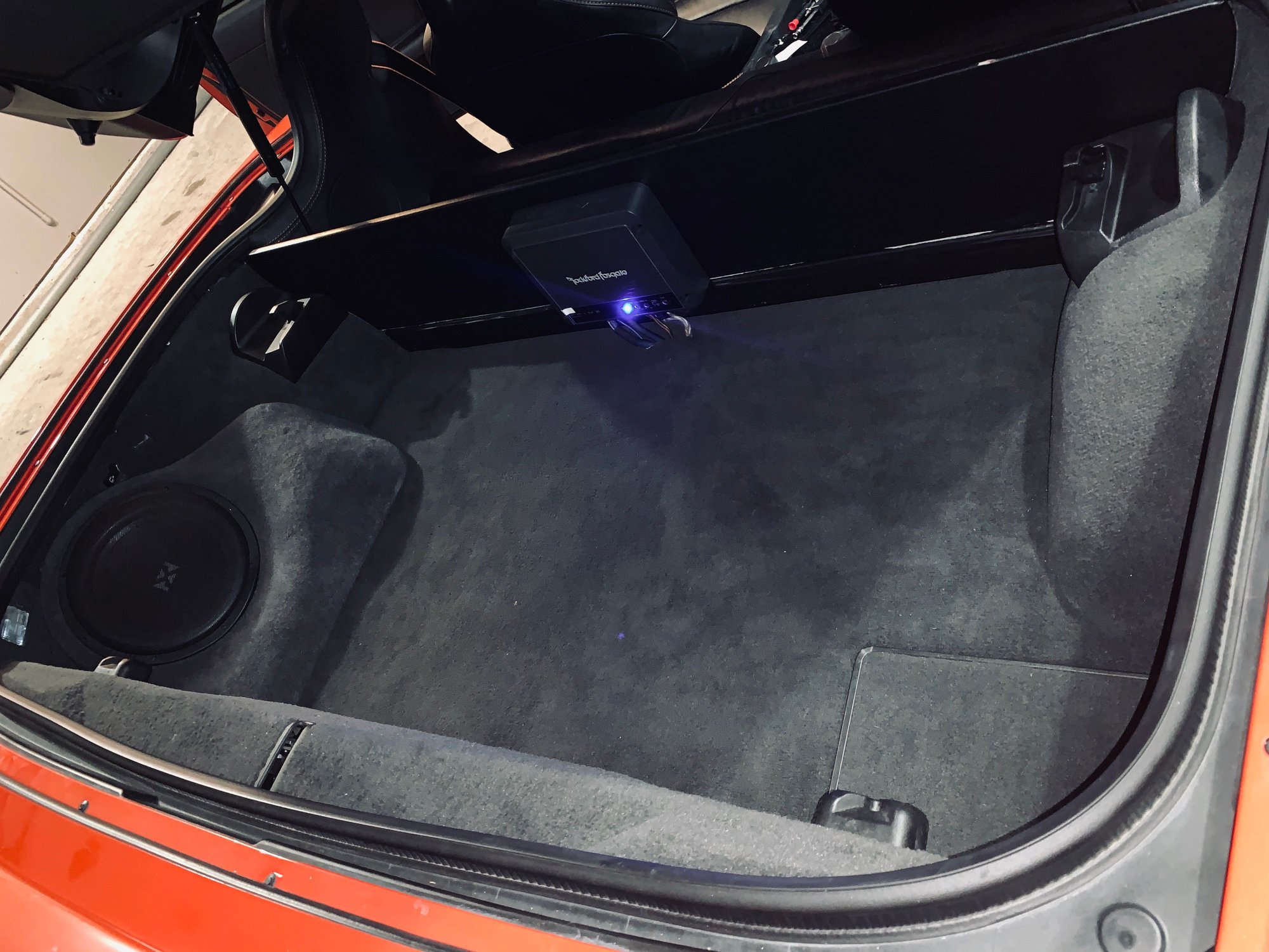

Thanks. The Rockford Fosgate amp comes with the sub volume control. I purchase a ton of stuff from amazon - something being delivered on my front porch every day is not an exaggeration. Never had any issues with returns or exchange.
I went with the Rockford Fosgate amp, 4 gauge installation kit including speaker wires & 3 year extended protection plan on the amp for $19 more than the same amp alone from Crutchfield.

So I installed everything tonight & have a couple questions.
  • after reconnecting the neg terminal on the battery I realized the PAC RP5-GM11 wire harness had changed all the settings with my steering wheel controls. Volume up & down change move the stations thru FM 1, FM2 & AM. The up/down arrows both lower the volume. So I’ll have to pull the head-unit out again tomorrow to try to reset the harness.
  • I’ve had nothing but trouble with the PAC harnesses, I’m on my 3rd. Previously was only able to get the volume up & down working but nothing else. Any tips for when I pull it out tomorrow?
  • I have to now turn the volume up to 30 on the head until to get any sort of volume. Even then I could probably easily have a conversation with a passenger. Thoughts?
  • I’m hearing a lot of “air” from the speakers when I turn up the volume?
  • tips on setting up the sub or equalizer on the head unit? I did notice the head unit has a subwoofer setting that I had to turn on for the sub to start working. It has some other settings in the head unit for the sub but this is all new to me.
  • I previously had my battery tender hooked up directly to the positive/negative terminals of the battery, can I still do that with the amp hooked directly to the positive terminal?
