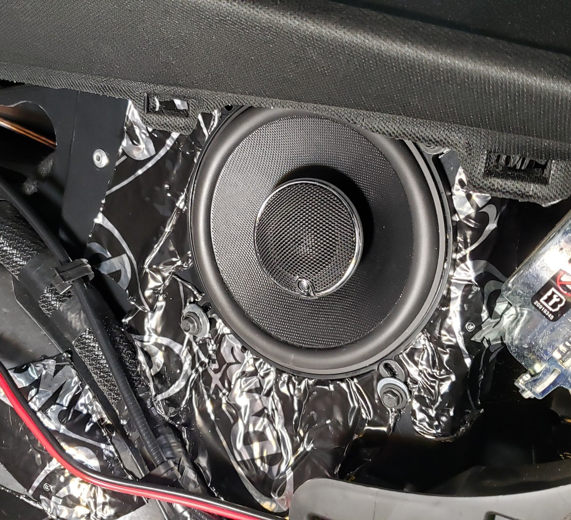

Replced with JBL tweets from a gto set. Perfect fit. Secured with some epoxy.

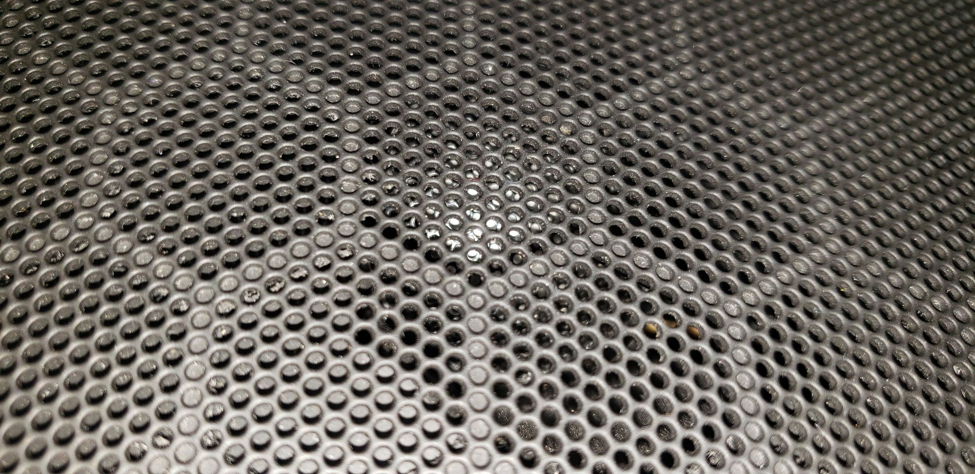

Stealrh tweeter
Ran signal wires on passenger side behind speaker.
Driver rear speaker installed. Decided to not make new screw holes and simply just added large enough washers.

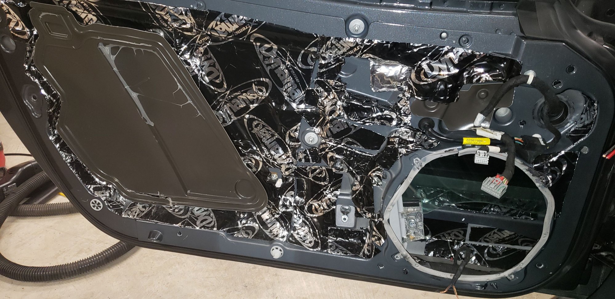

Infinity perfect 300M in door panel. Foam ring and sealed with dynamat.
Another shot of work done previously on door.

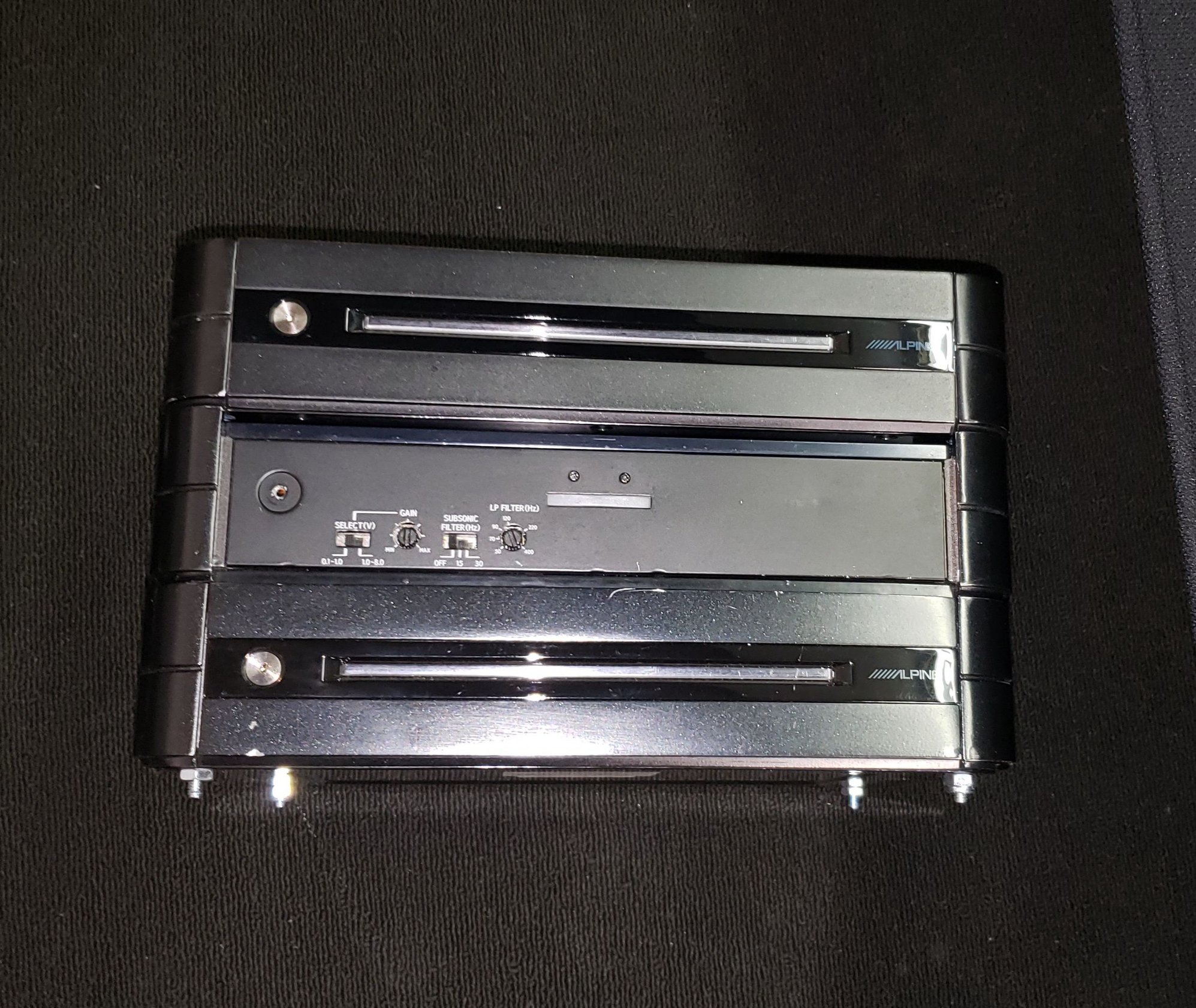

Seats and door panels back in. All signal wires ran. Need power and ground for my 10 channel amp.
PDXv9, PDX-F4, and PDX-M6
10 channels: 4 ch F/R mids and tweets 4 ch bridged to 2 door midbass 1 ch 10" subs 1 ch 8"sub TBD another amp for center channel

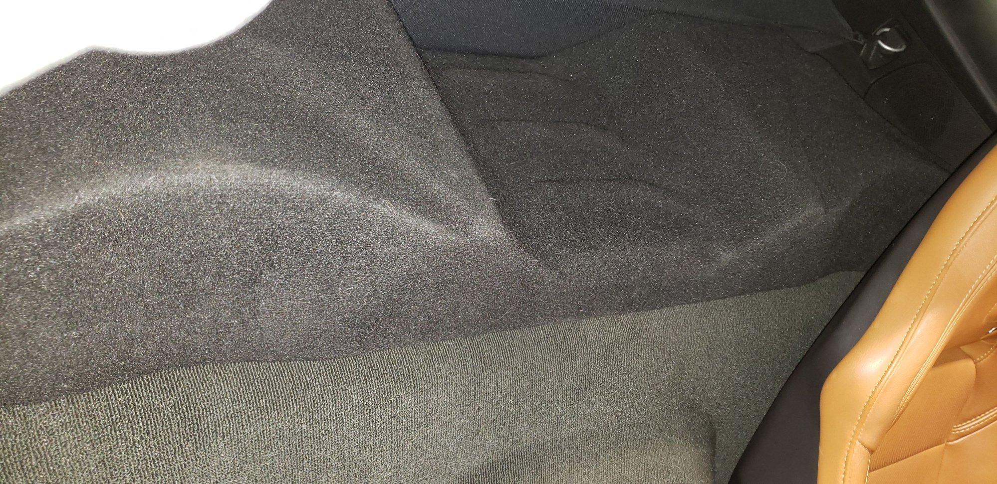

Amps stacked in cubby. Barely enough room for the plugs and patch cables. Will build a nice cover with quiet exhaust fans and maybe a DSP.

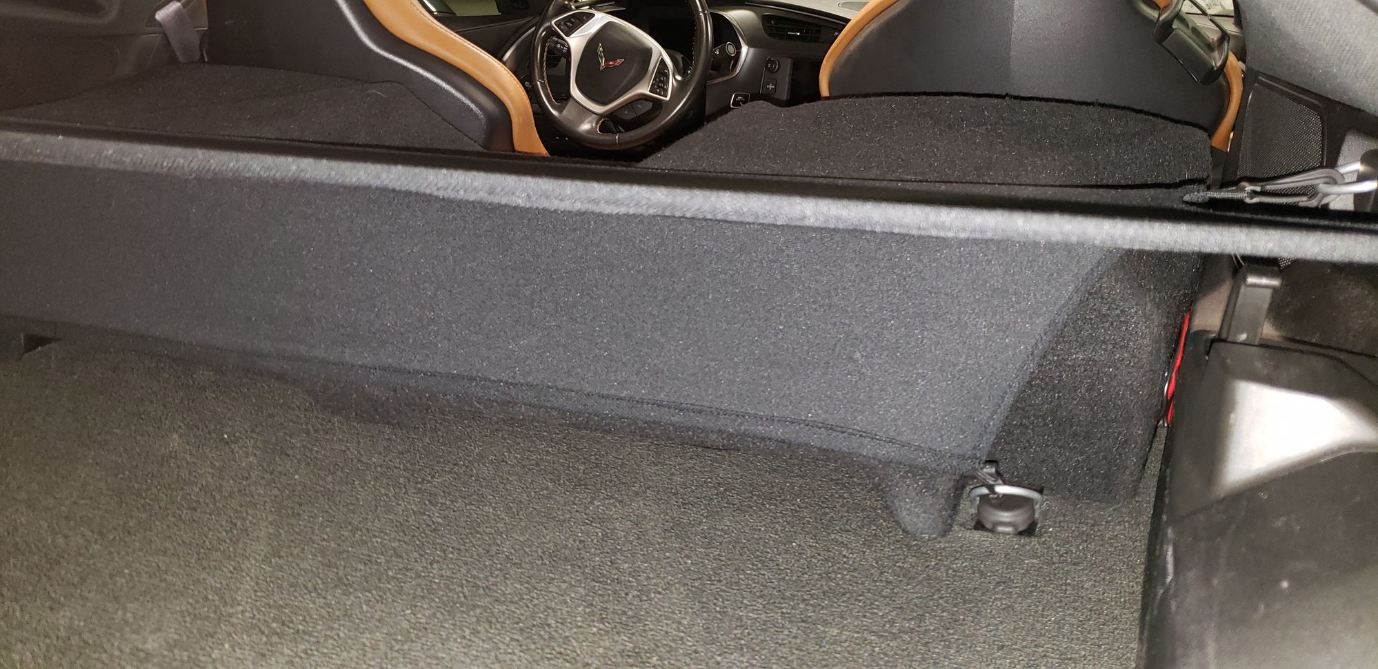

JL Audio sub box
Secured by factory bolts.
I just need a couple hours to do the actual connections at the amp.
