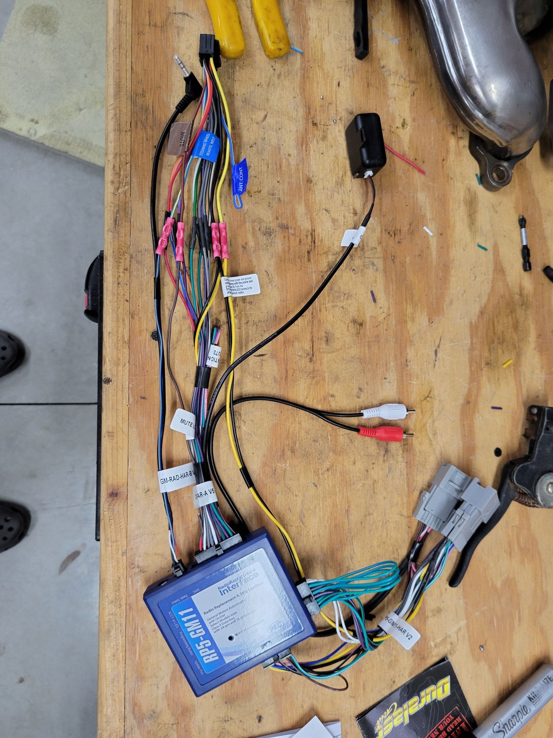

I was excited to finally get started on this head unit install. I did the PAC PR5-GM11 interface connections a few days ago. I carefully took console and dash bezel apart without issue. Seems like simple plug and play but I have the following issues:

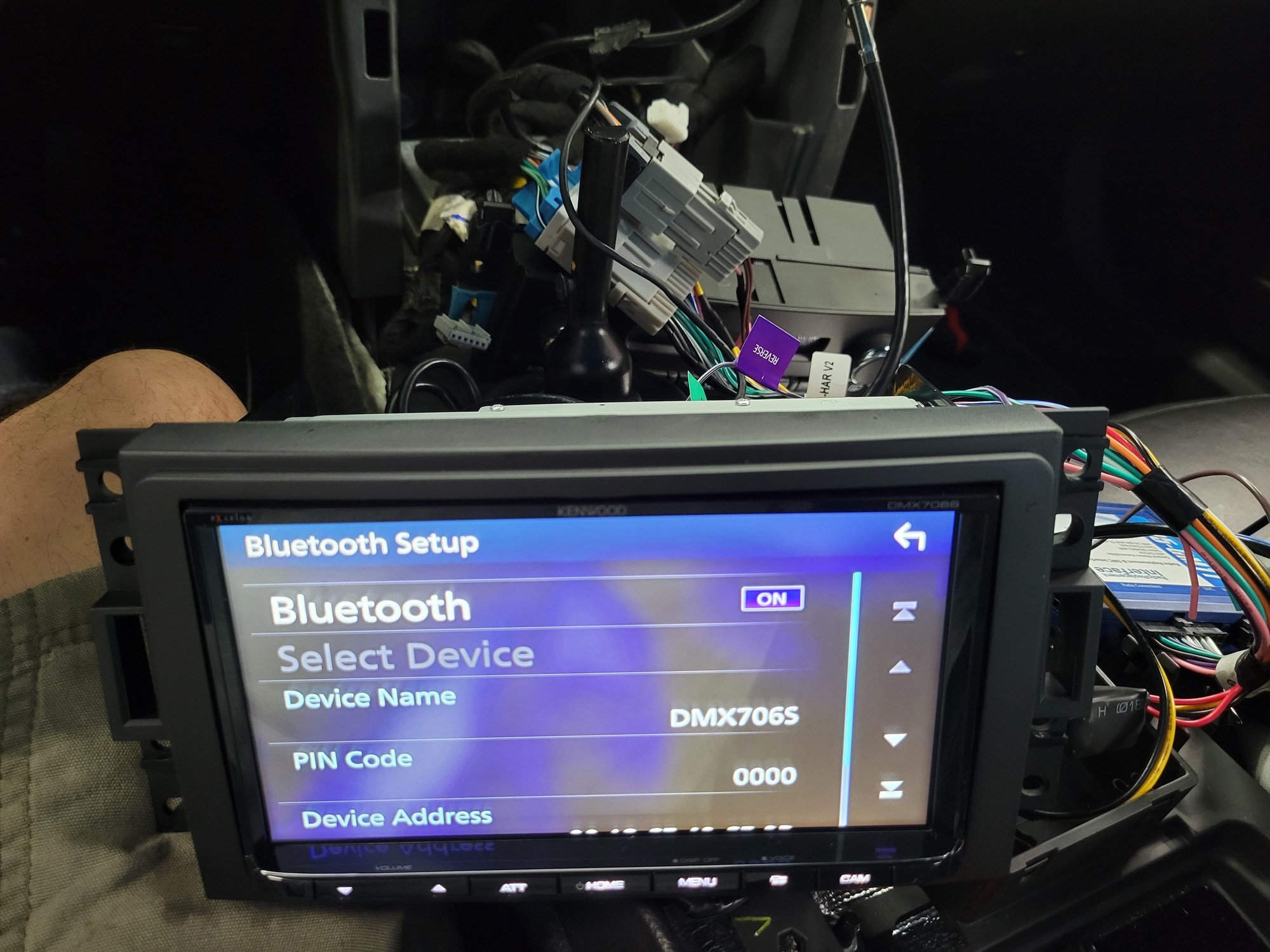

1. no sound other than beeper, radio will tune in but no sound. I assume connecting to the "amplified factory amp" is correct.
2. Bluetooth "select device" is grayed out so I cannot connect phone.
Steering wheel controls will turn volume up and down and change station (but cannot hear anything).
Any ideas?
I have not connected any cameras yet.

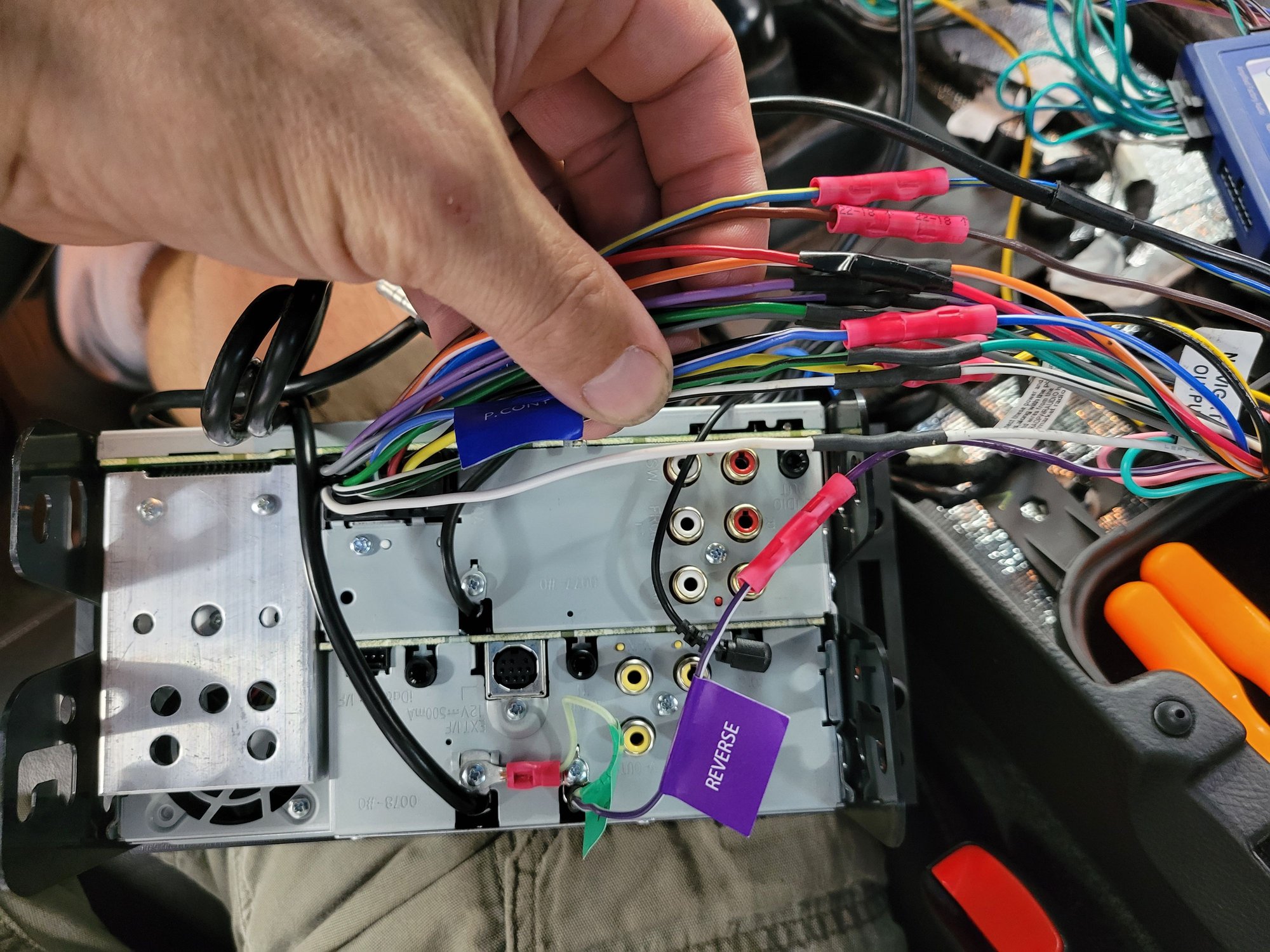

Most likely your amp is not turning on. Is the amp turn on wire connected properly? It is usually labeled "remote wire" and is blue with white stripe.

Good point Fred, I didn't think about that. It's kinda hard to tell from his pictures, but this could be it (red arrow).

Yeah, that might be it. Hard to know for sure from the picture. If so, easy fix.

Yep, he would be the first one who didn't hook it up, seen people make that mistake a few times. This should be connected to the Blue/White P. CONT wire from the radio harness.

Yeah, that fixed the sound. Thanks for noticing that.

Also, not sure if this is the issue, but do you have the parking brake wire connected properly? Some features will be unavailable unless the head unit knows the car is not moving and parked. You need to have the parking brake wire connected or properly bypassed.

Also, if the parking brake is connected properly, make sure you are in the correct head unit settings to connect a device. If you don't have any devices connected, and you try to select bluetooth as an input, it may be greyed out because no device is connected and therefor no bluetooth device is available. Either way, the bluetooth thing should be an easy fix. Don't get overly frustrated to the point where you overlook the obvious. You are almost there.

Ah, that's refreshing and makes sense. I grounded the light green wire to one of the screws on the back side of the head unit. I'm not sure about the light green wire on the interface..... could it be another one of the wires in the bundle that is labeled "Nav"? That "Nav" label sure has caused me some grief. LOL. My phone is a Galaxy S21. I didn't have my phone set to "discoverable" because I was waiting to turn on the "search for device". Maybe that's the issue.
1. Does the light green wire from the interface need to be hooked up somewhere? I'm wanting to bypass the parking brake and have the Lt/grn grounded to the rear of the receiver.

If you have the Lt. Green wire from the head unit connected to the chassis/ground, this should enable the bypass so you don't need to connect the Lt. Green wire from the interface to anything. Let us know how things go when you get home.

Rybern, you just want to make sure all the wires coming from the head unit are connected. Any leftover wires on the interface are a non issue. The interface is built to be compatible with all different head units, some with navigation and some without. So all the wires coming from the interface don't have to be connected.
If the parking brake wire is bypassed correctly, then it must be something in the settings. Check your owners manual for proper procedure to connect a phone. My guess is you are not in the correct settings. If you are and it is still greyed out, then check the parking brake wire again.

In the mean time, I also suggest you thoroughly review the Bluetooth section of your owners manual starting on page 51 to see if you can determine what you're doing wrong, also if applicable make sure the software is up to date on your phone. https://pdf.crutchfieldonline.com/Im...113DDX5706.PDF

I connected the USB and I got a message that says "Stop your car......". So it's grayed out because it thinks the parking brake isn't applied. Lt green is grounded to back of HU.
