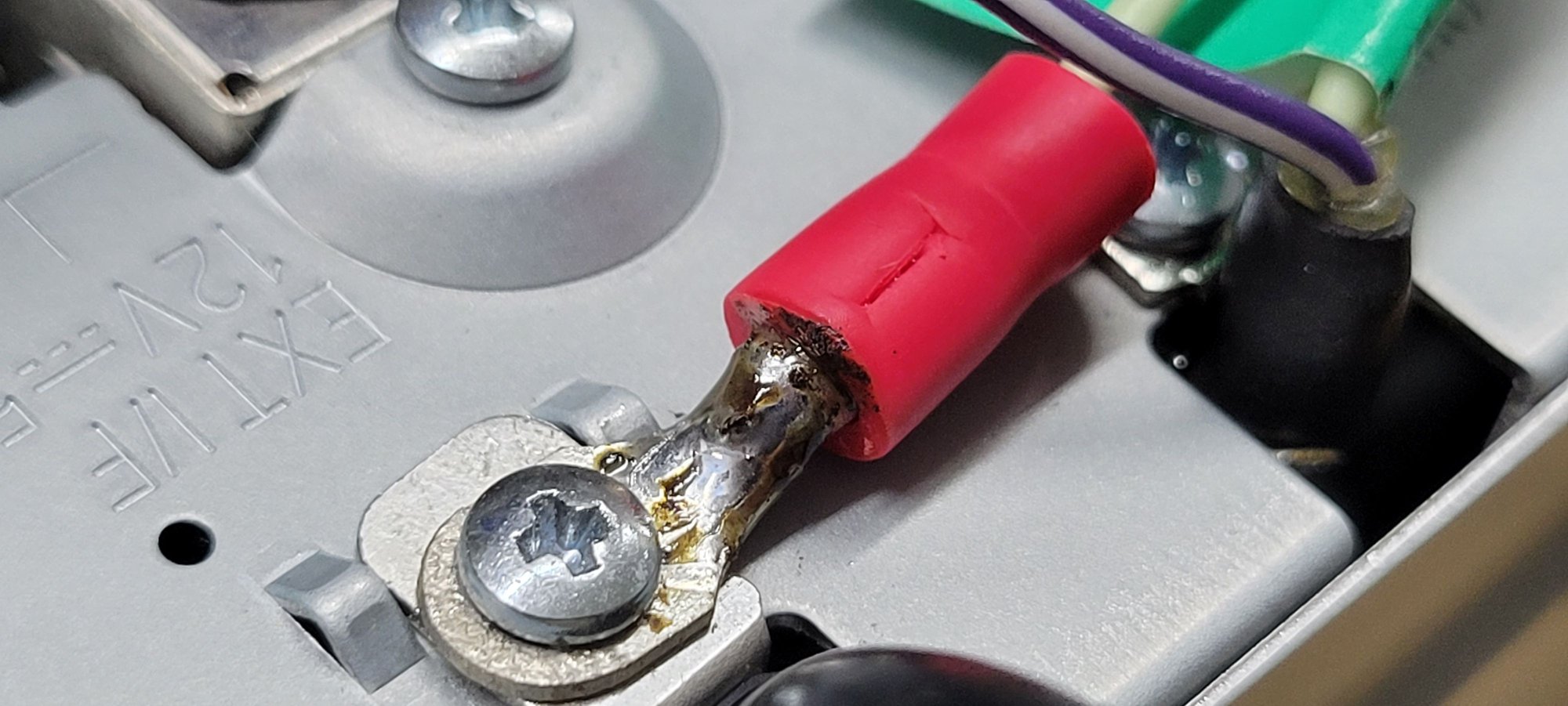

1. Just for the heck of it, I removed screw and soldered the crimp connector to the left green park switch wire to remove any possible doubt about this questionable connection.
2. I re-connected the brown wire loop off the interface with solder and shrink tube.
3. I tried the parking brake procedure of brake on, off then back on while car is running
4. Held mouth just right.
There doesn't seem to be any special page to go to register device. There is the BT setup page thst I've opened and I've opened up my phone and scanned for devices. "Select device" is grayed out... as always. Loving this Kenwood so far.
