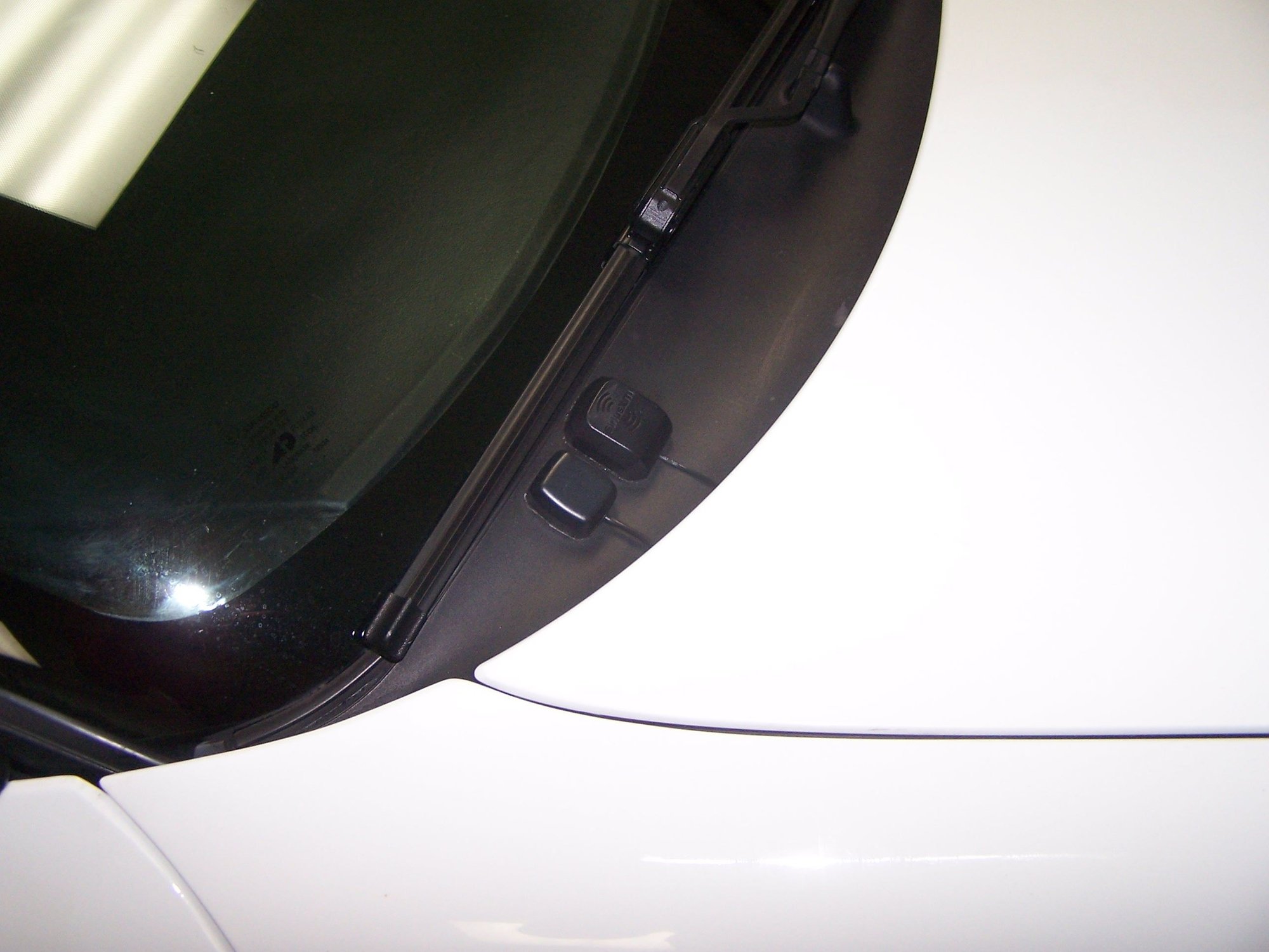

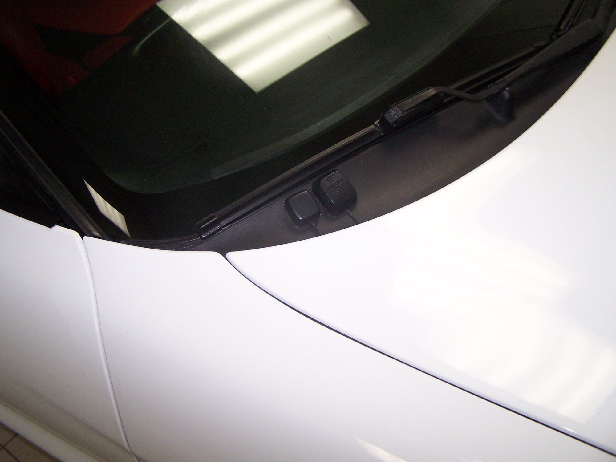

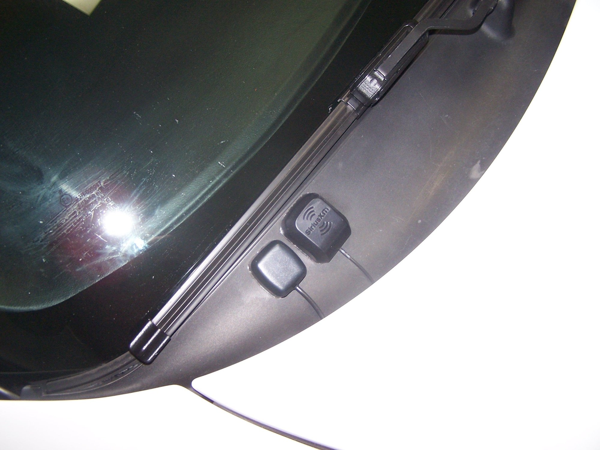

I placed the GPS and Sirius antennae in the
wiper area. Have no concerns. Mounting and wire running was easy. Antenna have metal bases so the fiberglass body is not a problem.

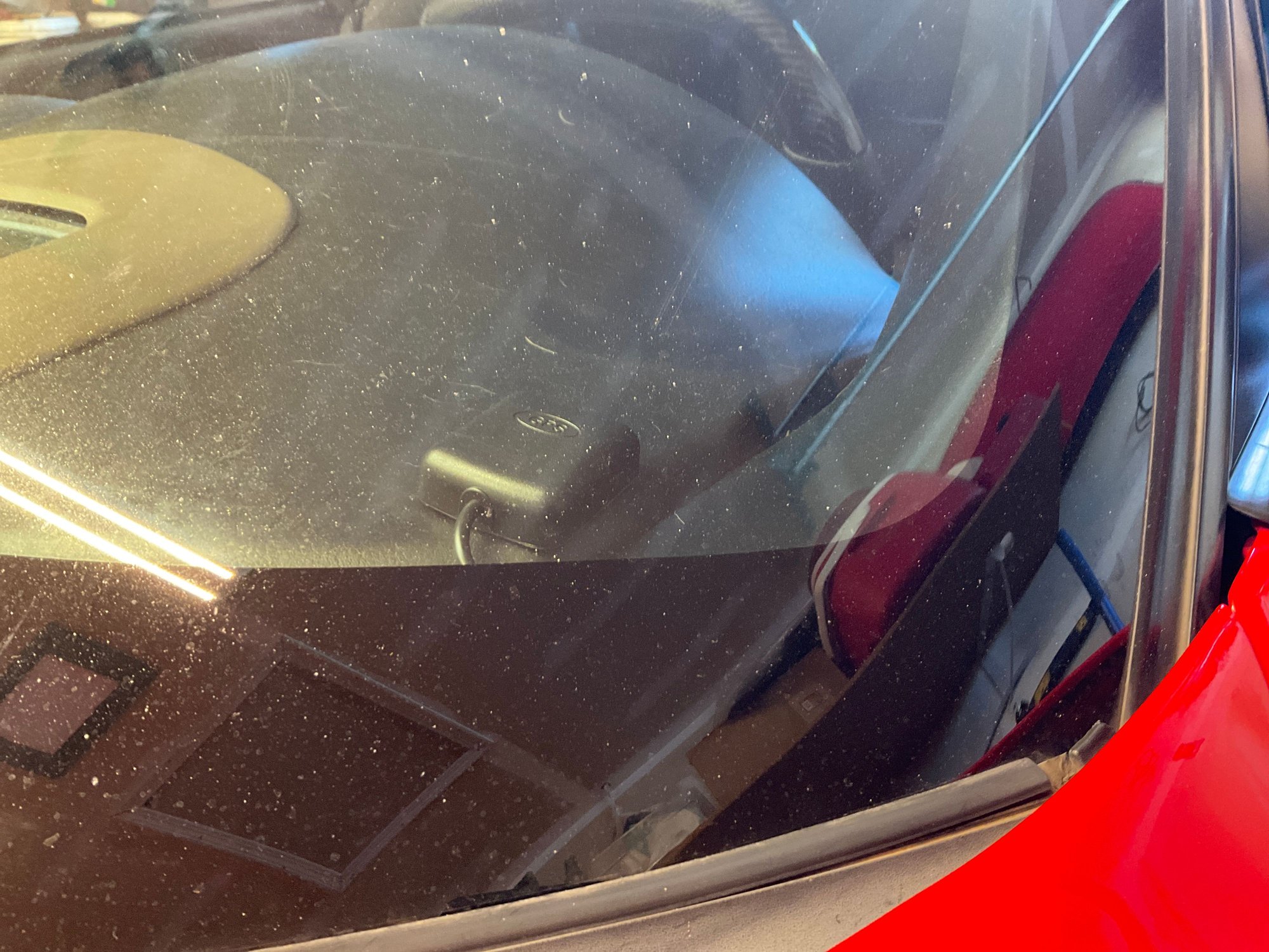

^ uhhh..I would have put them under the windshield
The signals go thru glass too

I put my GPS antenna under the waterfall. Works great.
