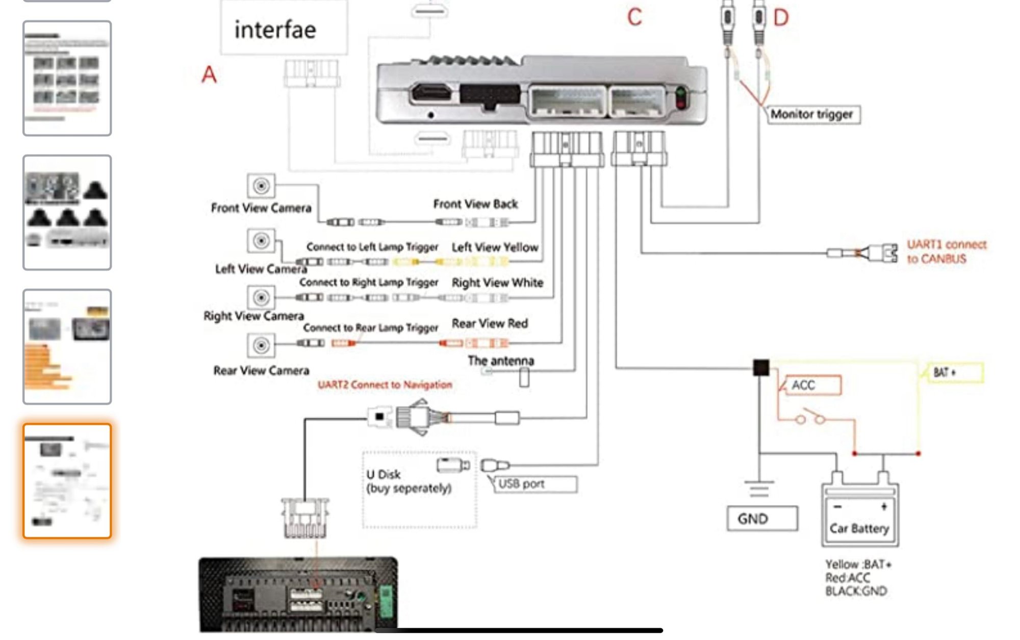

This can be achieved with the PAC GM1A-RST in conjunction with the PAC VS41, and an aftermarket head unit. The VS41 has inputs for four cameras (front, rear and two side cameras) The side cameras are triggered to come on with a connection from the VS41 to the turn signal circuits, that when the turn signal is activated it triggers the head unit to display that specific camera. I considered adding cameras to my side mirrors, but couldn't really think of a way to do them that would look good, or butcher up the mirrors which I don't want to do, so currently I'm just running the front and rear cameras.

They sell retrofit kits that can do this and plug into an aftermarket HU via HDMI

I'ld be interested in a link if you have one. The units in madsonp's post I think just switch among 4 cameras. Not create a birdseye surround view. Could be wrong

This one has an HDMI output

Thats slick. I see they use calibration grids to figure out the as installed camera pose info.
