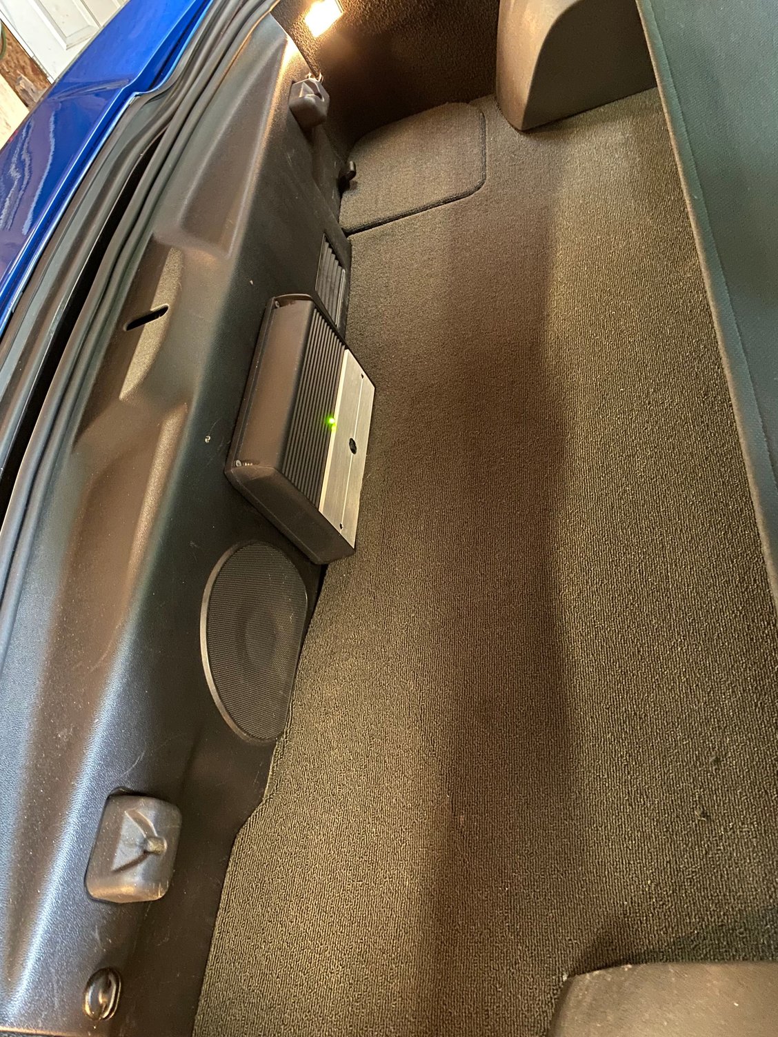

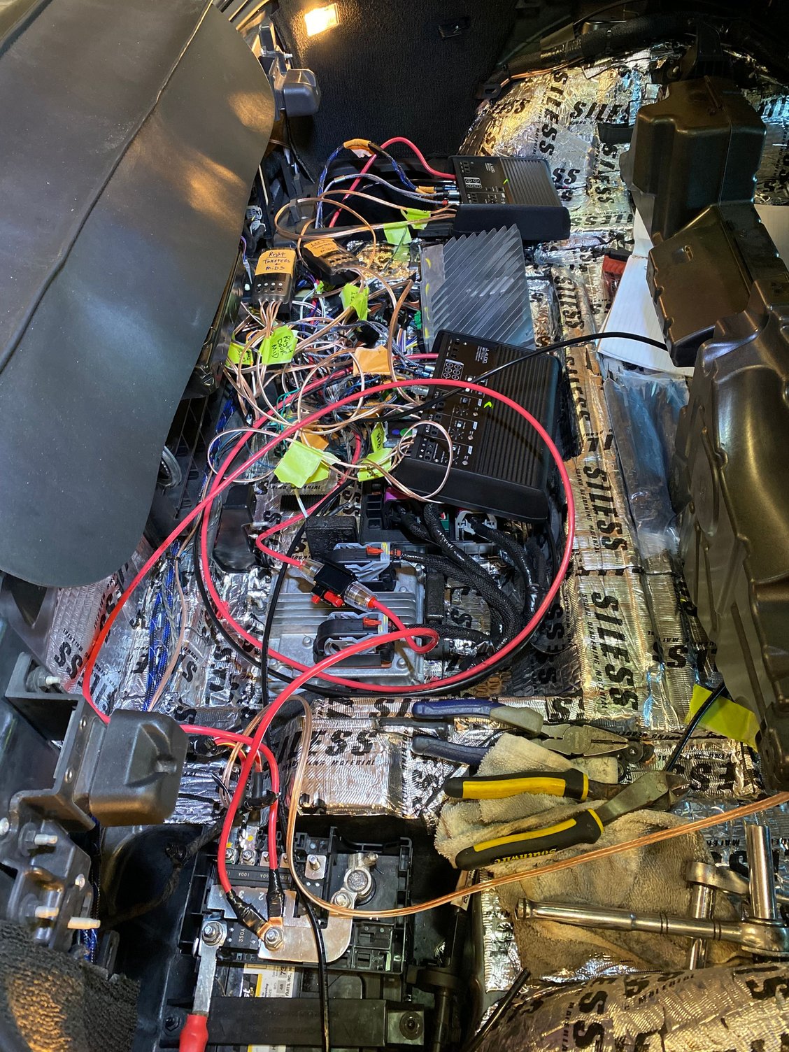

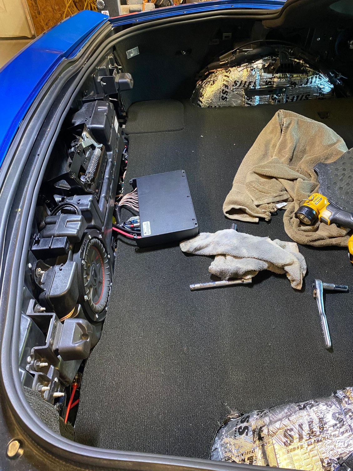

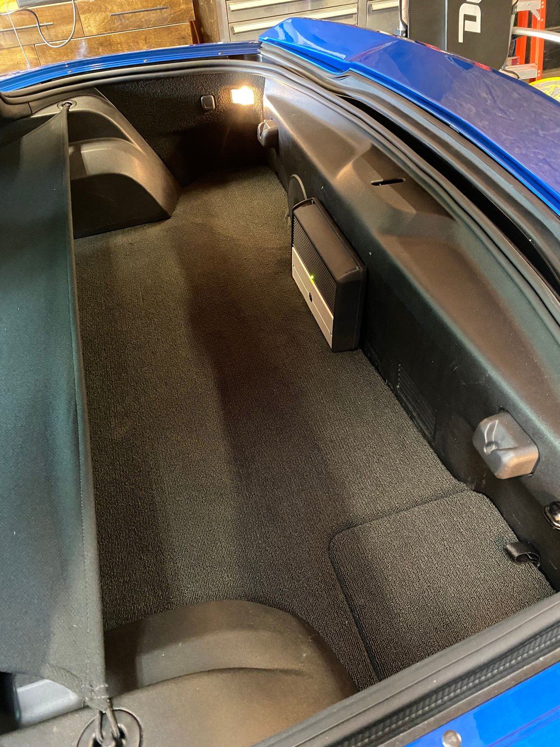

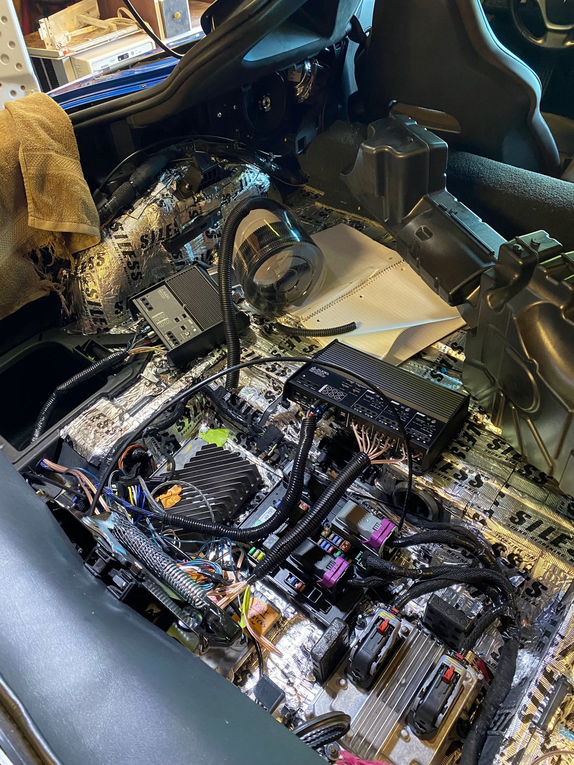

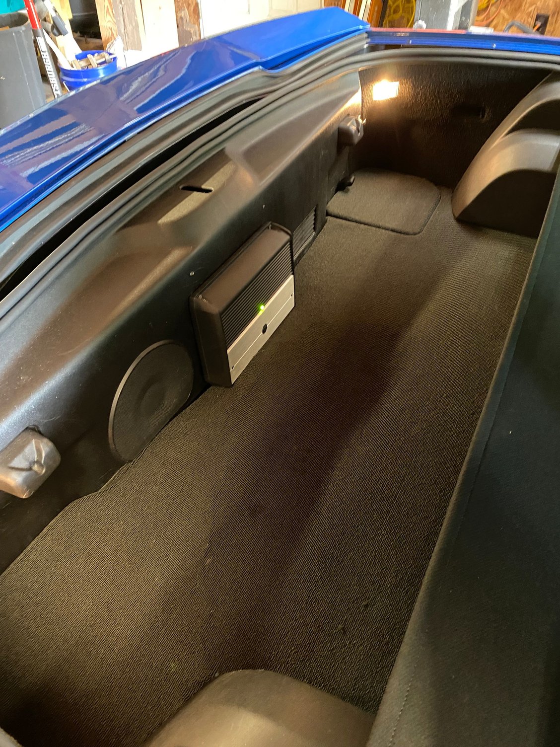

All right everyone with the help of Vince we can call this audio swap complete. 😁😎😁 Here are some pics and they include the mild to wild switch as well installed and programmed to the garage door opener in the visor.
Some important takeaways
  • When using a AmpPro PAC Audio unit and wiring they come with schematics and the wires with fancy heat shrink tubing that are speaker labels —— DISREGARD ALL OF IT BECAUSE ALL THE WIRING IS WRONG
    • PAC AUDIO IS of no help and don’t waste your time with Crutchfield tech support
  • use a AA or 9 volt battery , some painters tape and a sharpie and test tone all of your speakers so you know the correct color code for them and then label them with the tape
  • turn the sensitivity on all channels of the amp/amps to at least 50%, mine were turned off and it took a couple of hrs to figure that out

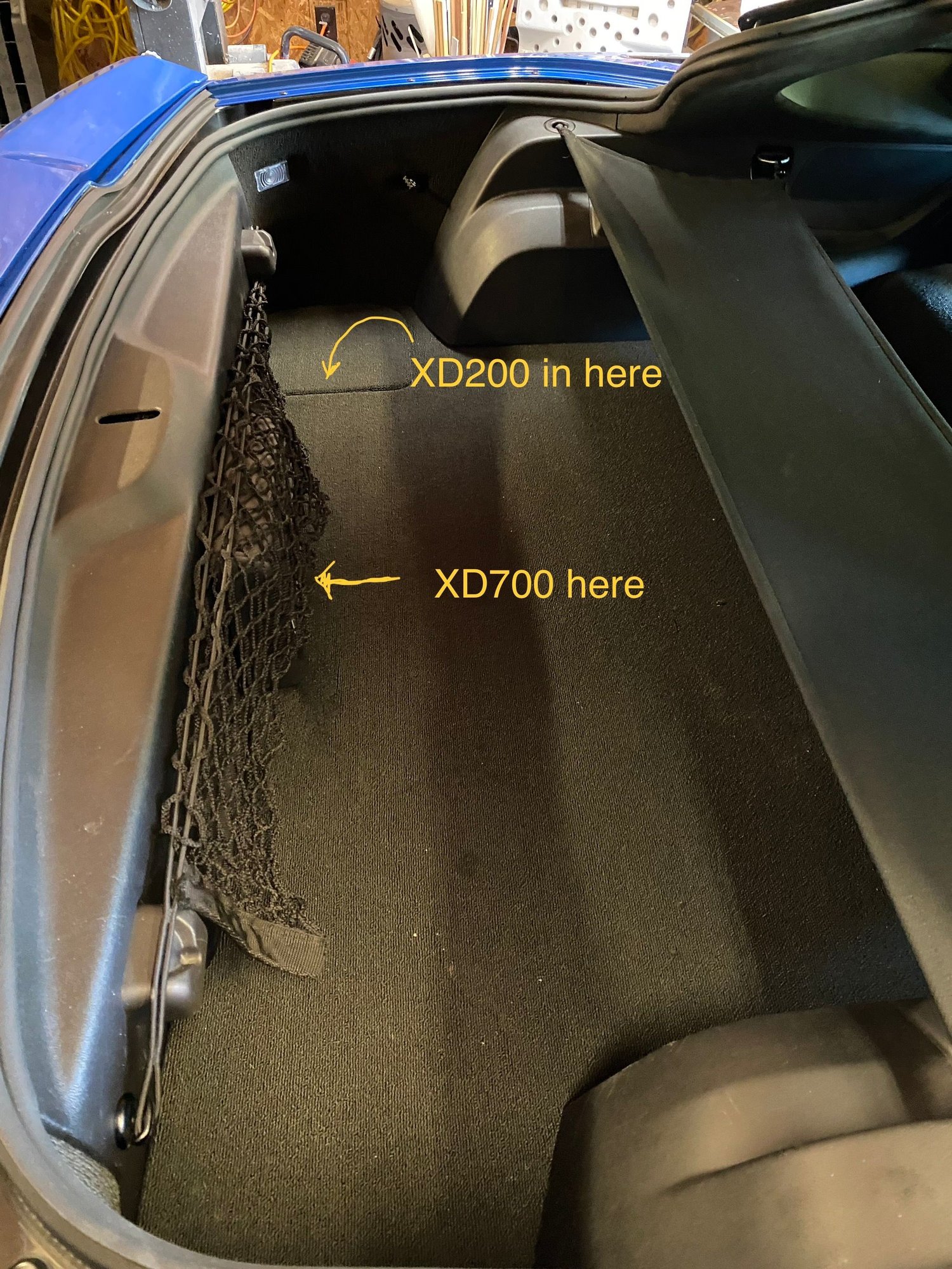

  • I was able to hide the JLAudio XD200 in the cubby hole in rear of car, I attached the JLAudio XD700 to the rear panel just below hatch latch - then put cargo net in place and you can’t even see it.

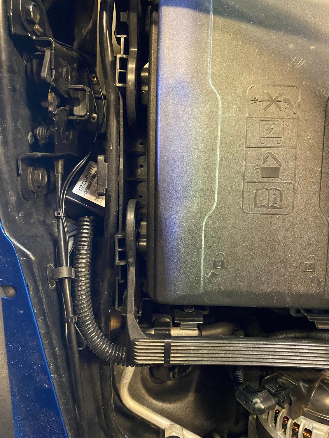

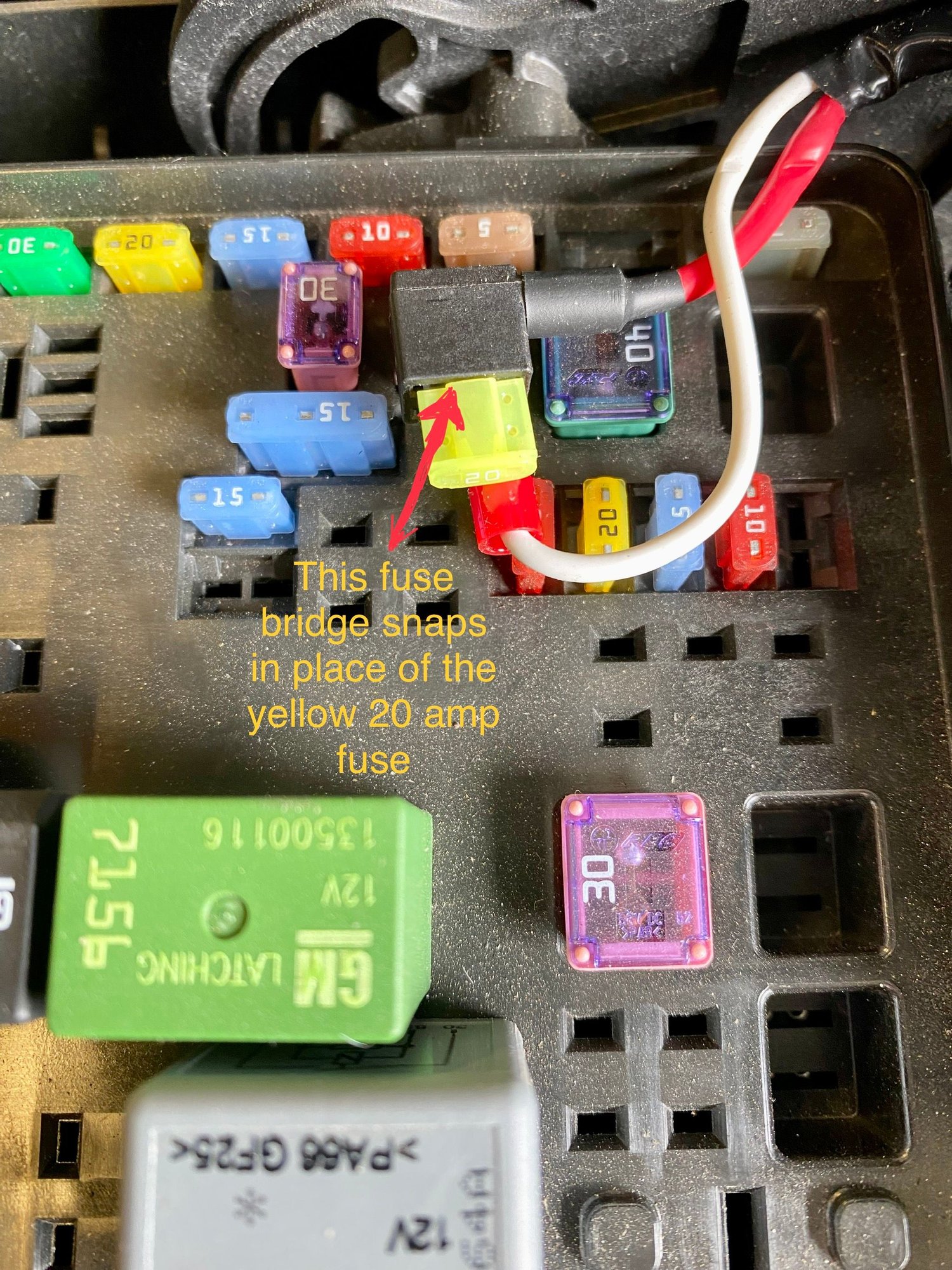

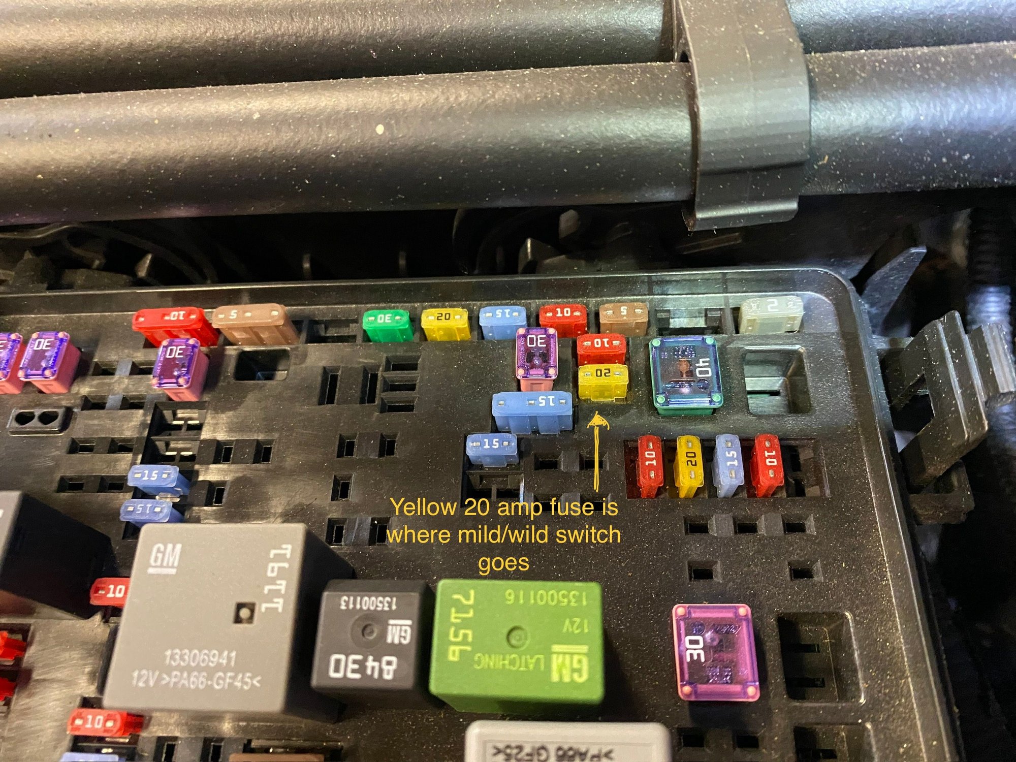

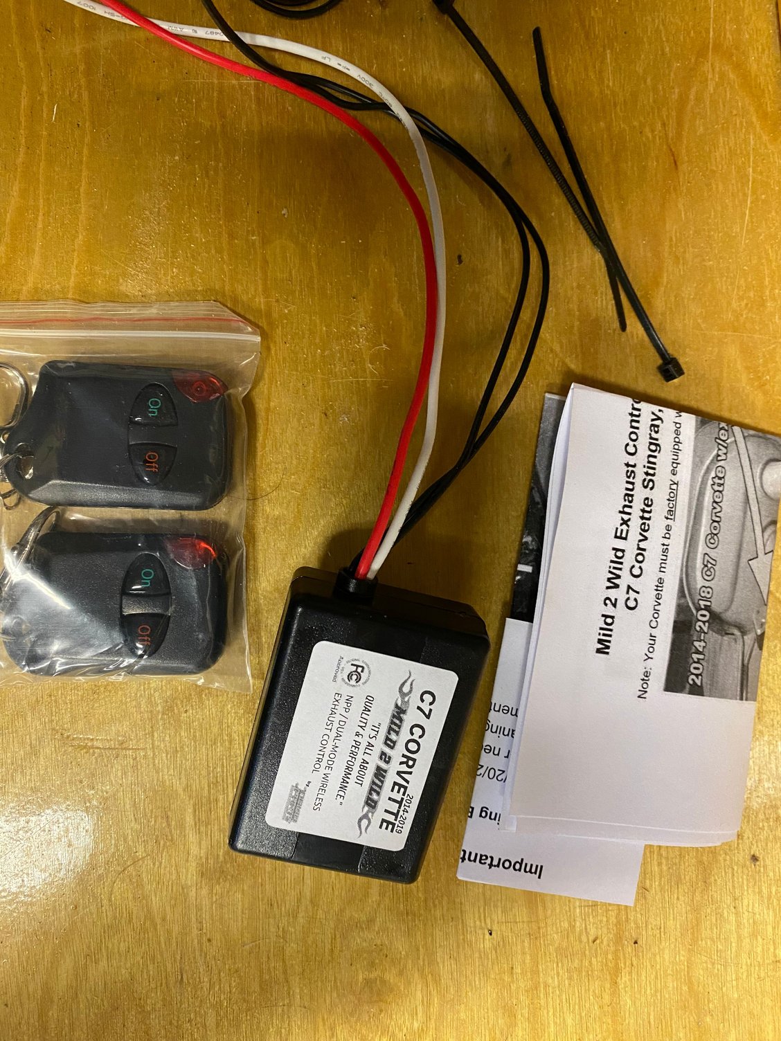

Mild -2- Wild exhaust switch
20 amp remove from slot and jumper snapped in its place. Then 20 amp fuse was snapped into jumper.
Inside fuse box under the hood on passenger side.
Mild/Wild module velcro down - there isn’t a blue antenna wire anymore. The antenna is internal now.

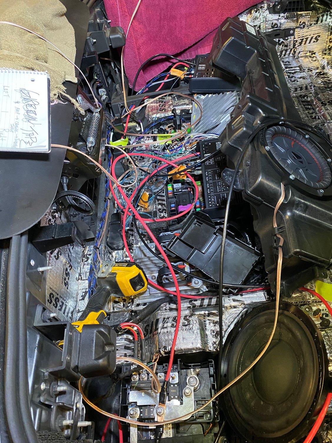

GETTING CLOSER 👍😎👍
Have two inline fuses to amp within 18” of battery
