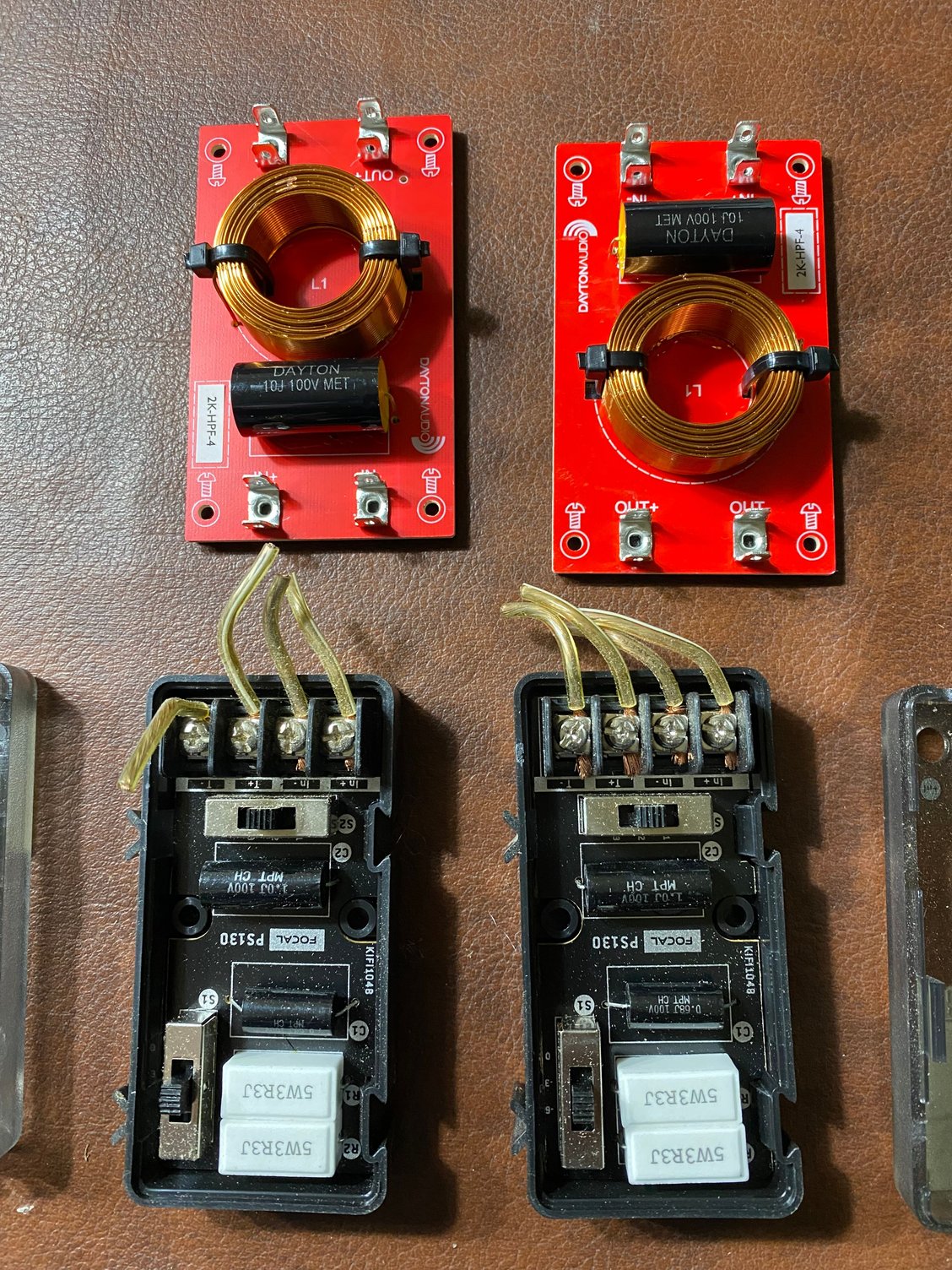

Dayton crossovers top - Focal PS130 crossovers bottom
Radio module for passenger side hooked up to PAC unit

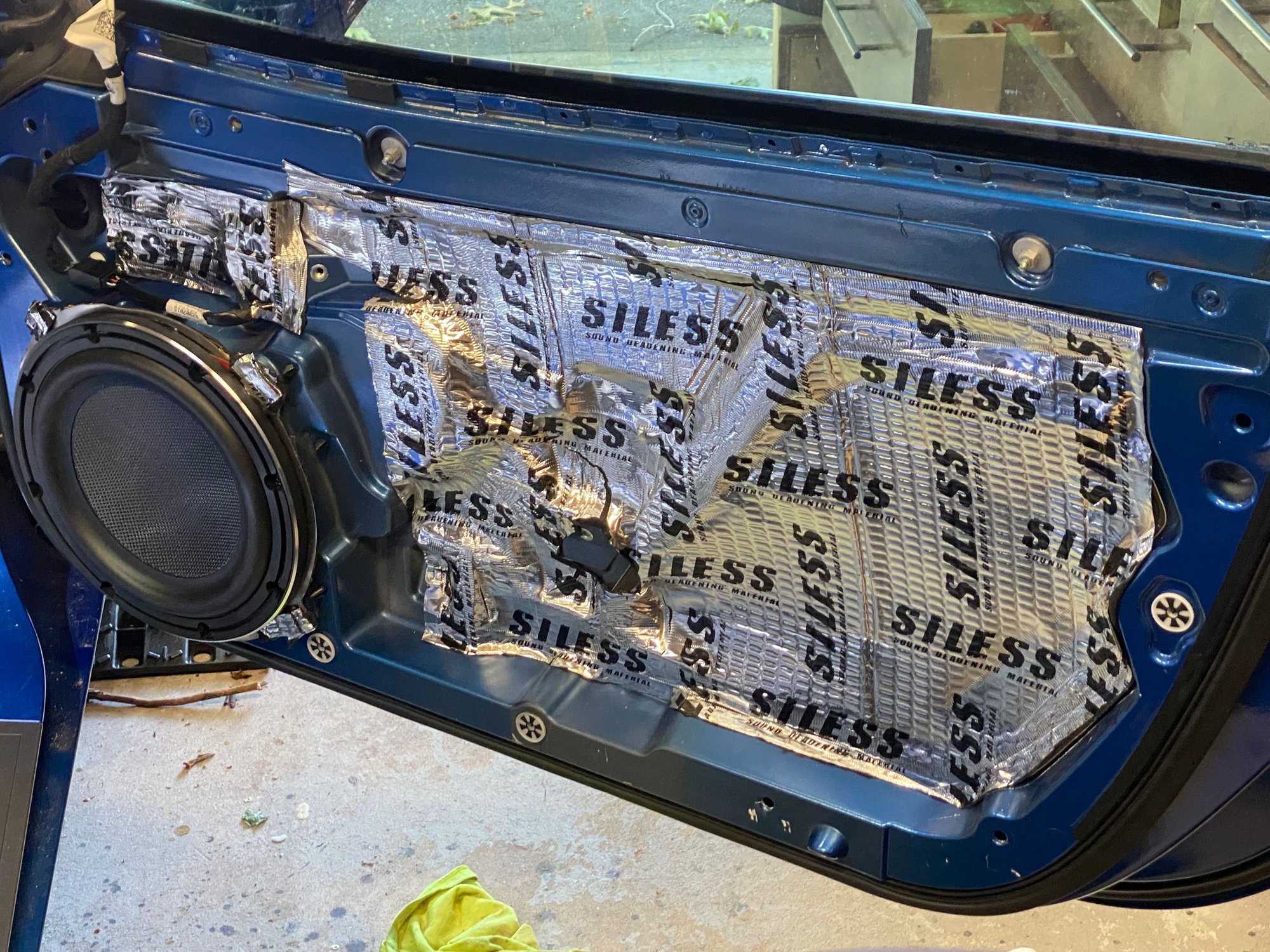

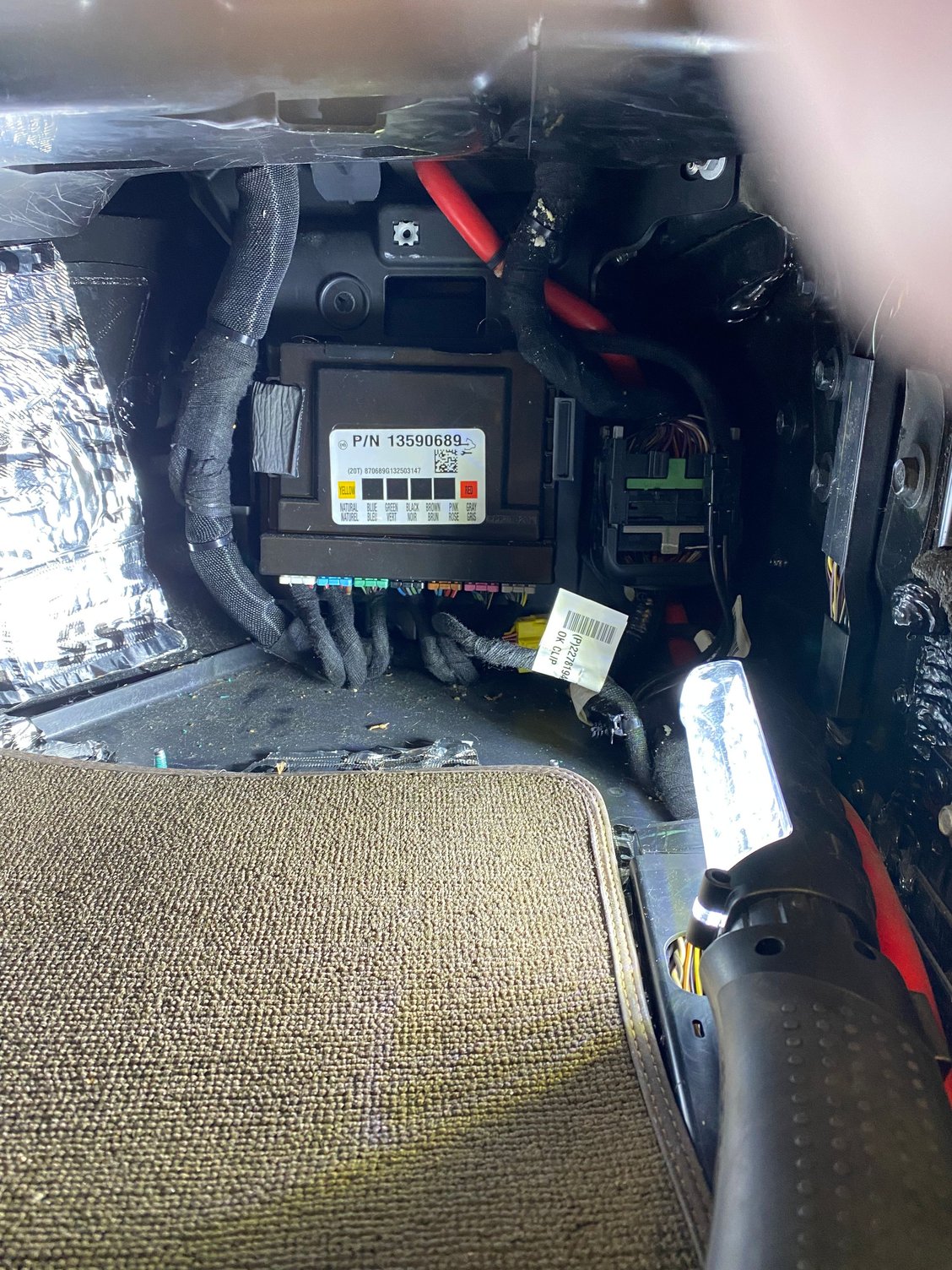

Okay so am still a bit confused on how to disconnect the a noise Canceling. The other post mentions pulling pins 4 and 5 on plug X3 but there isn’t a 4 and 5 pin?Someone also mentioned disconnecting it inside door panels. I couldn’t find any plugs inside door panels.
Also that Acrylic is entirely too brittle to Mount those 10lb subs in the doors. So my next alternative is using some 1/2” mdf for my door subs.
I see your sound coverage on your door (looks anwesome) and will work on that tomorrow as well. I like to do the same thing you did and that’s putting the deadener inside the door adhered to the outside skin.
I forgot how much work this custom install stuff is 👀😎👀

The pins are there. Or either you have a 1LT car that someone added the upgraded Amp and sub. The door mic should look like this:
And should be located here:
Old May 5, 2023 | 07:46 PM

Worked all day making 1/2” mdf adapters for the door subs and panel won fit back on. So am hoping the 16 gauge sheet metal I am working with is the ticket

I have that on drivers side only 😁

Okay found both of those and disconnected them👍😎👍

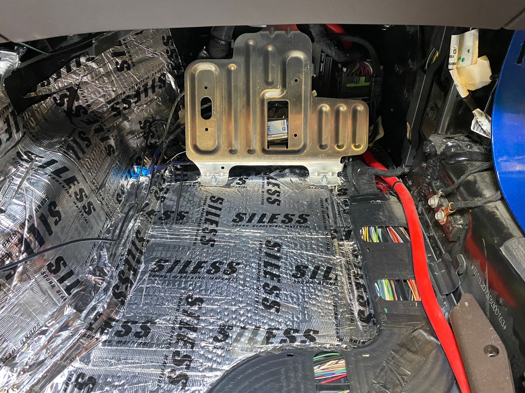

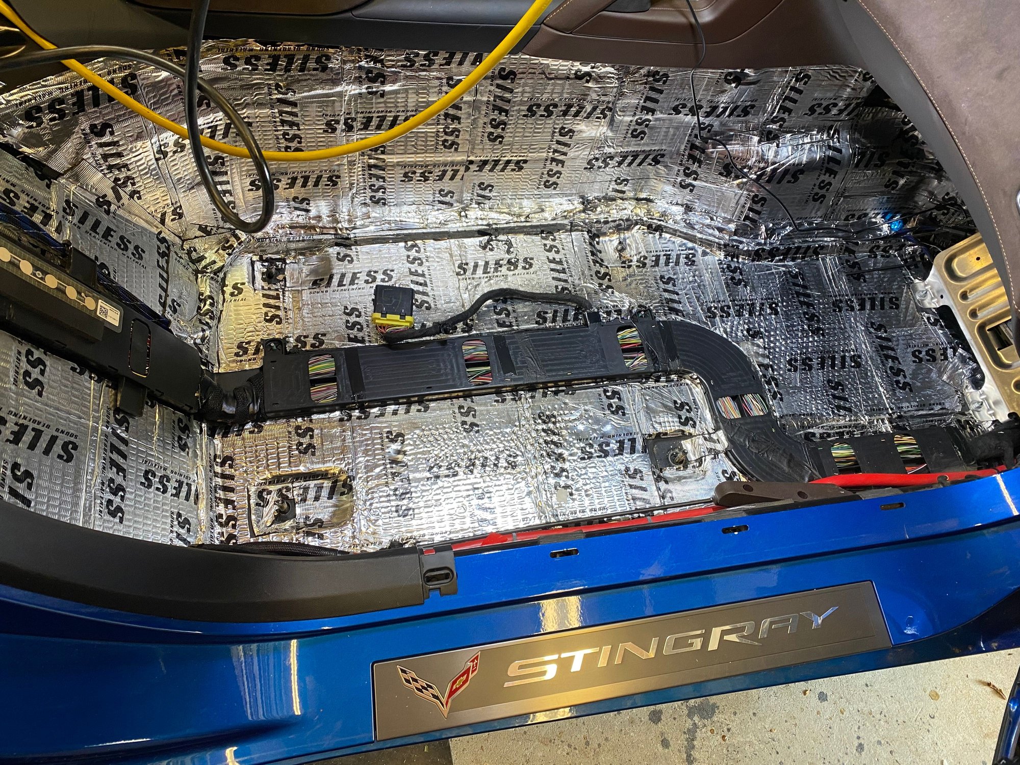

Fabricated the door sub mounts with 16 gauge “weldable steel.
So doors are complete with new mids and subs
All sound deadening is complete (two 36 sq ft boxes used)
rear sub mounted
rear speakers mounted
HMI modules and console ports changed to USB 3.0 for the Apple CarPlay

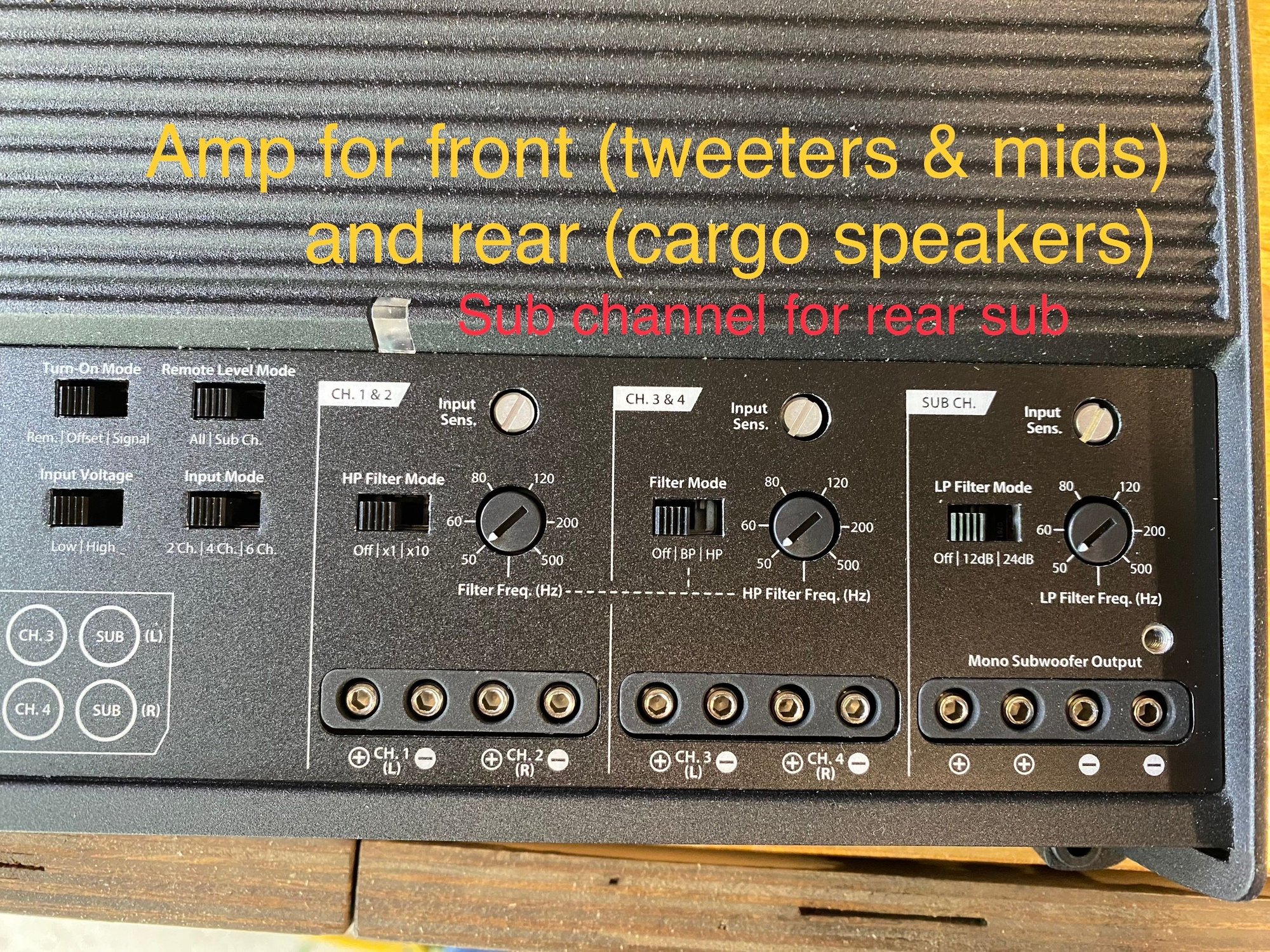

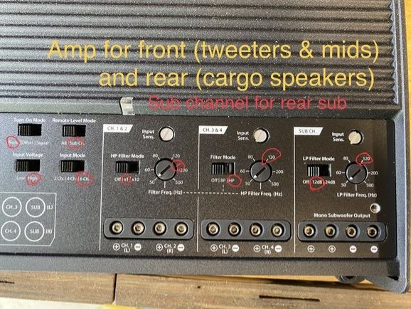

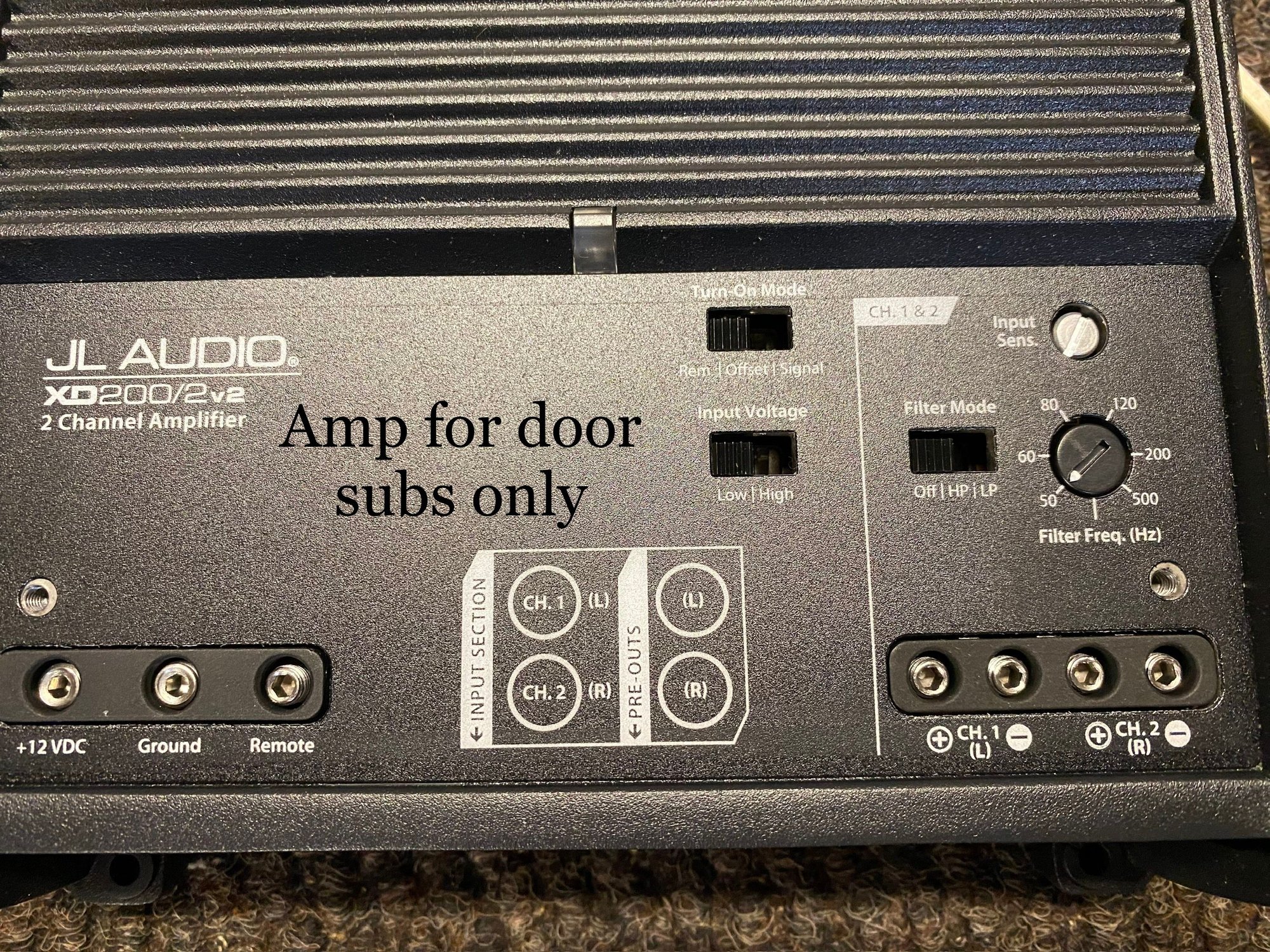

What settings
  • for the XD200
  • for the XD700
BLUE REMOTE WIRE FROM PAC UNIT - WOULD THAT GO ON BOTH AMPS DAISY CHAINED?
Old May 7, 2023 | 05:58 PM
  #94
VinceC5's Avatar
VinceC5
Joined: Sep 2004
Posts: 2,847
Likes: 439
From: Spring Texas
I would put a relay on the blue wire from the PAC unit and then let the relay turn on the two amps.

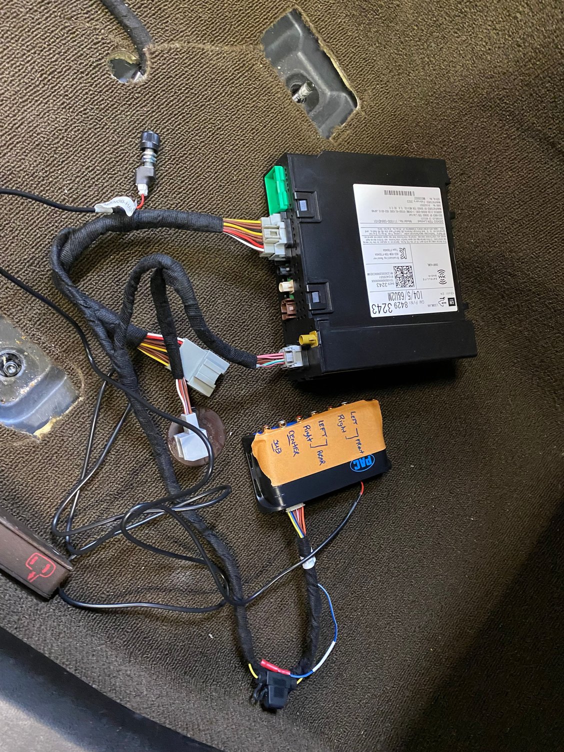

Okay stupid question, new wires running from tweeters ( for simple instruction skip crossover) go where.
Old May 8, 2023 | 09:58 PM
  #100
Rbohno's Avatar
Rbohno
Joined: Aug 2011
Posts: 373
Likes: 75
From: Iron Station, NC
Here is some examples so far from the PAC Audio harness
wire label (from PAC) as ………………………… actually …………………………………colors
(left front speaker 2) ……………………. Center dash speaker………….. White + , white/black —
(left front tweeter) …………………………Left rear. ……………………..White/red + , white/blue —
(left front speaker)………………………... Left door sub. ………………..White + , white/black —
(right front tweeter)…………………………Right rear ………………………Gray/red + , gray/blue —
The takeaway from this should be PAC Audio builds units for the masses so that’s why the first things they ask you is “did you tone test your speakers to verify the exact speaker location.
My feeling is if it’s made for the masses it should be priced accordingly so for an AmpPro and wiring to cost over $400 my labels should be correct out of the box. If that’s too much trouble then leave the labels off.
just my .02
