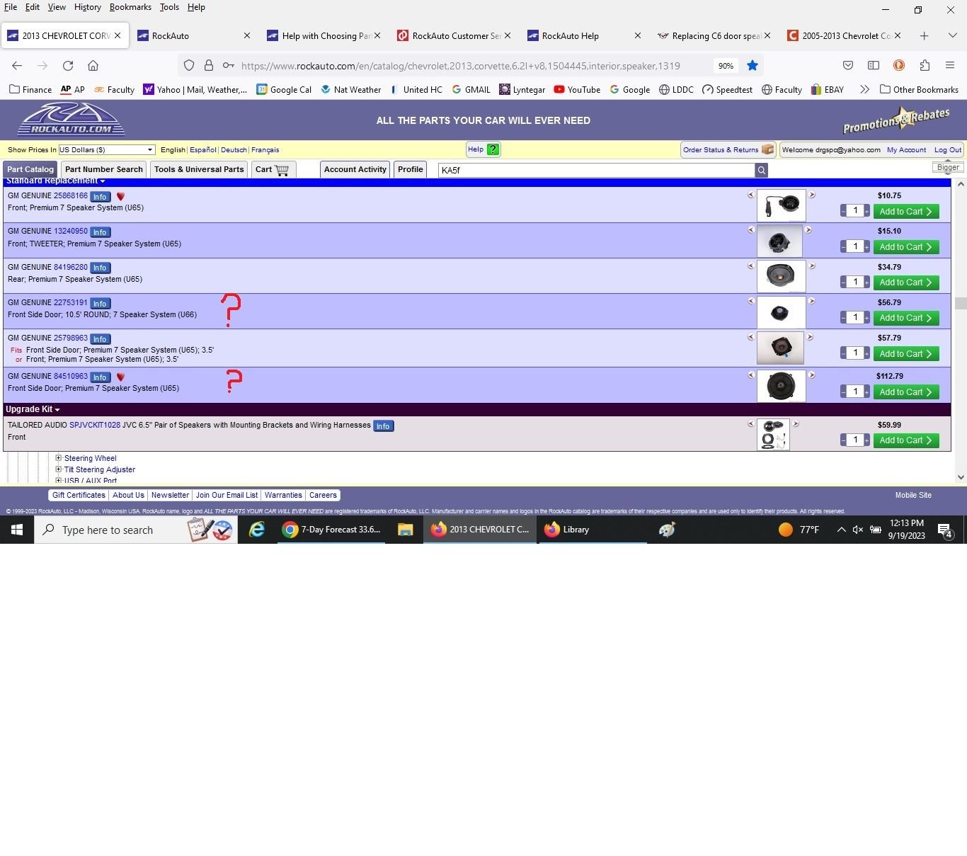

TORCHREDFRED, I have a 2013 w/Bose system. the Passenger side woofer is blown. Was looking at Rockauto but not sure which OEM speaker to order. I am attaching a screen shot of Rock Auto/speakers with couple of red question marks. I don't care to upgrade head unit or get into amps and such. Which door woofer will fit my C6?
2012-Bose, go with the bottom one that you marked. The top one is the non bose 8 inch on a 10 inch plate.
It’s part # 84510963
