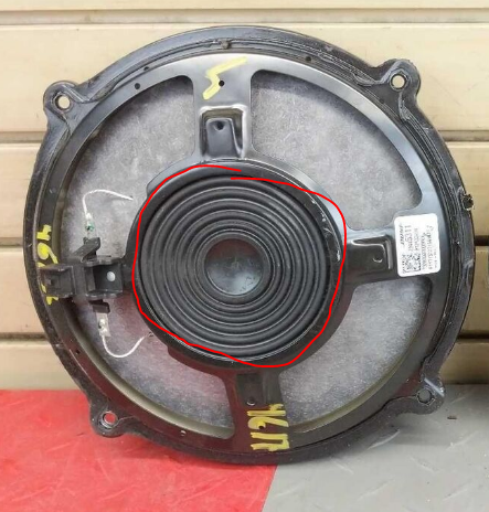

are you sure its actually blown? i know on c7's the black cone separates from the basket making it sound like its blown. a little epoxy and time, fixed for $6
I mentioned this in an earlier post, but the picture helps!
