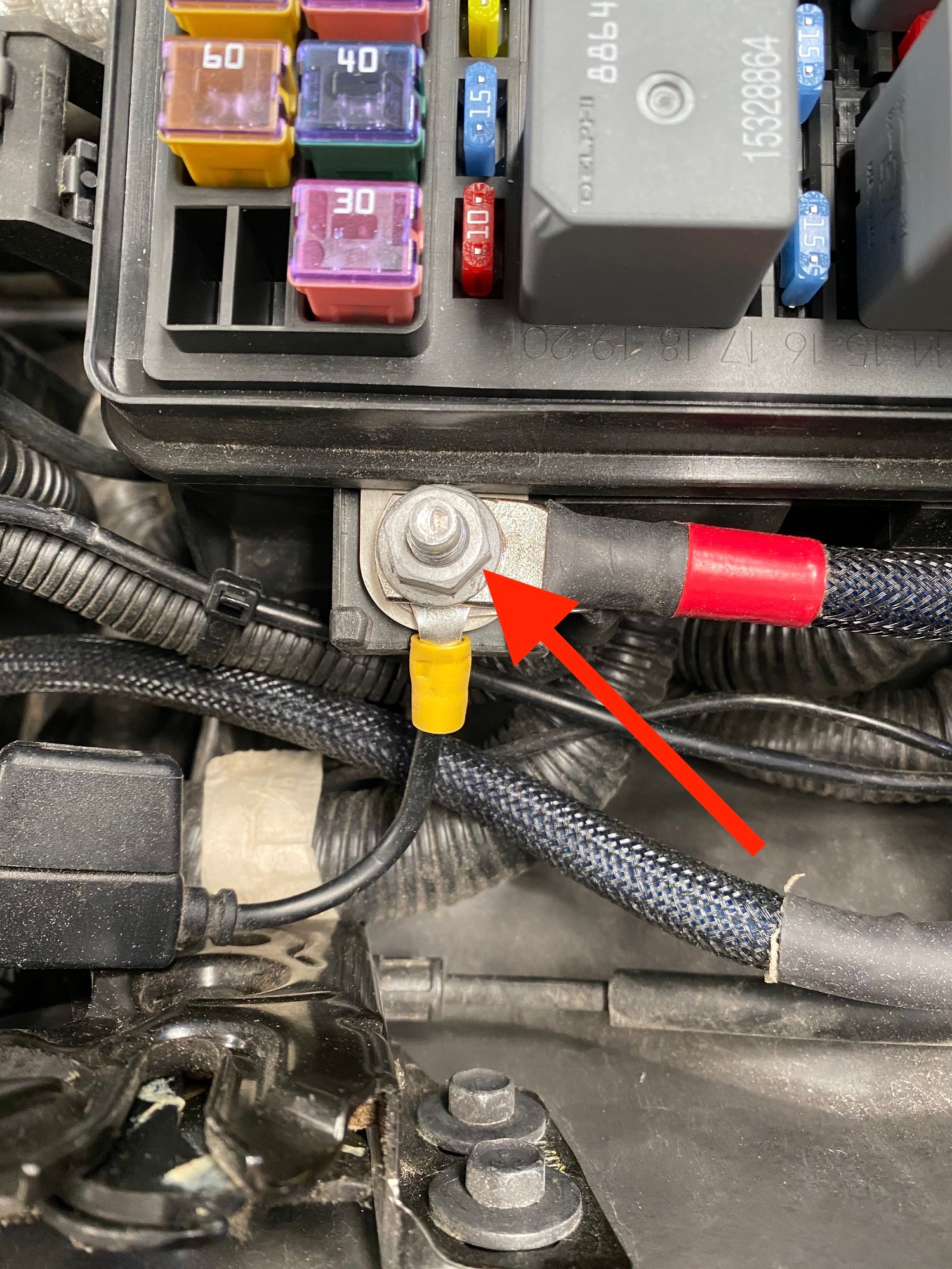

Not sure if the rear battery cars are the same, but I connected my subwoofer amp to the positive battery post on the under hood fuse box, that comes directly off the battery, then ran the positive lead back to my amp. The neg connection for the amp you want to ground as close to the amp as possible.
