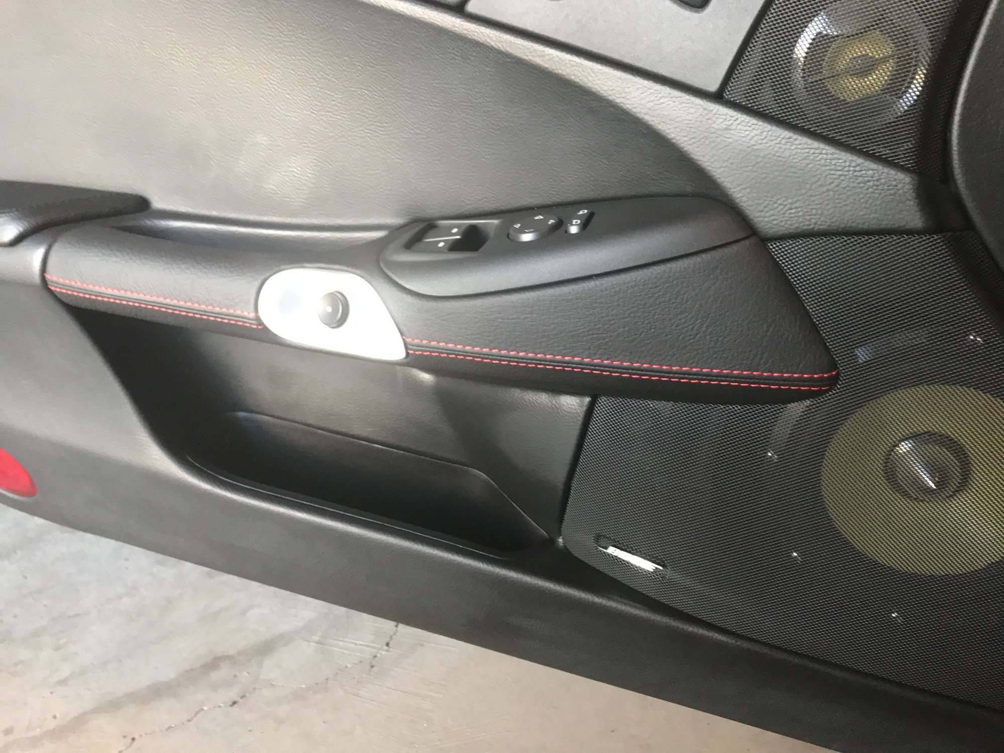

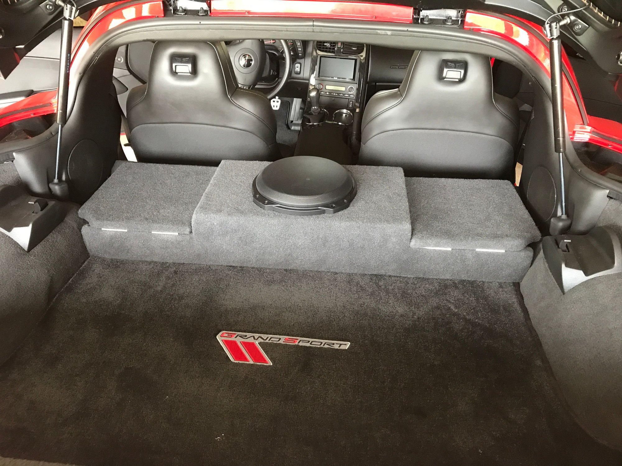

Lots of sub options that will accommodate the targa top. Sub Thump sells a couple pre made ones. I have 2 sub boxes, not from Sub Thump. One holds a shallow sub and fits the targa in the back. But since I never take the targa top off, I built another box that holds a JL Audio 10W6v3. I also went with a Pioneer head unit, Focal KRX2's in the doors, Morel 5.25" in the rear and a 5 channel Morel amp to power everything. Some will argue to go with larger door woofers for mid bass, and they are probably correct, but I am happy and pleased with my overall system and sound. Pics below.
