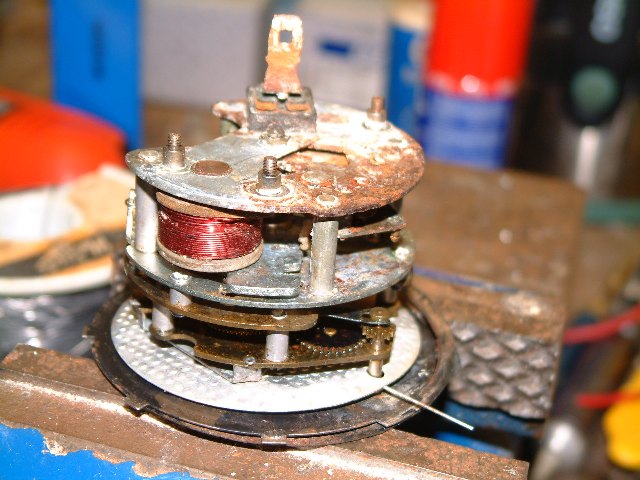

This is how the inside looks like:

It's a 60. My others are a 65 and 69. Thanks for offering your help; I may need it when I see what I have to work with.
Hopefully, it won't look as bad as Rob's pic above.

Obviously it looks brand new, now it is restored...
