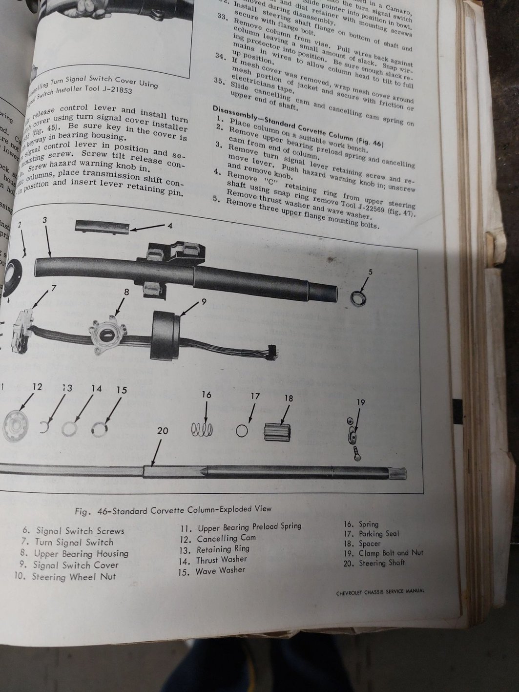

I'll try to help, but it has been 40 years since I played with the collapsible shaft. There is a round shaft with the sides milled flat which holds the rag joint fitting. This shaft slides inside a shaft tube (#20) upon frontal impact to allow the shaft assembly to collapse a few inches. If you have a Chevrolet Chassis Service Manual, section 9 provides pictures and instructions for assembly and installing a rag joint (steering coupler). The General will provide the best advice in his book. What I cannot recall and confirm is there was plastic injected in a couple of holes thru the shaft tube to hold the two pieces together. If that plastic has sheared, it will allow the shaft to move up into the shaft tube. I would try prying on the shaft to extend it out.
Please consult the General's book as my memory is faint on this.
Chevy Chassis Service Manual Section 9
This picture is from the 68 manual, I couldn't find it in my 67 manual. I don't see the plastic injection holes in this tube, they may be a figment of my imagination or memory.
Ron
