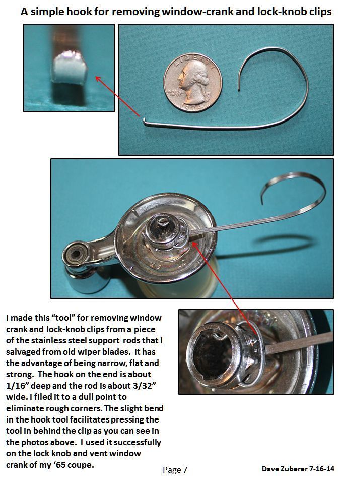

The "special tool" never worked for me. The molded door panel material doesn't give enough to use it without damage. The only two methods I have been able to use are:
terry cloth (or t shirt material) rag, sawing back and forth to catch the end of the clip. It you saw in the opposite direction that the clip is facing, it won't catch anything. Try both. The lock **** is specially hard because of the molded panel around it.
And, once I figured out which way the clips faced, I was able to take a small pick with curved tip, rotate it so the tip was flat, slide it behind the ****, then rotate it an try to catch the curved end of the clip and pull it out.
Either way you get the clip off, it will fall behind the door panel, but no problem to retrieve.

Try making a small hook tool like this one. Run it down behind the crank or lock **** then push it back toward the panel to move the hook forward to catch the clip, then pull up on the loop. Can be done with dental pics as well. I believe some have even used a bent heavy duty paper clip. Did you look at the PDF on tips for removing those clips attached above?
I have used this hook successfully to remove the clips on cranks and lock ***** on our 60 and 65. It's worth a try.
The large flat tool available at most auto parts stores is difficult to get behind the lock ***** as mentioned above and shown in the PDF.
With either tool, it's critical to figure out the orientation of the clip on the shaft, in other words, "where's the loop"?

Not rocket science people -- the videos in this link are on my C1 but I use a hooked pic to remove the door lock on my '63 the same way. I fumble a bit in the video because I'm juggling a camera while doing the job - it usually goes more easily. A bondo spreader protects the door panel.
https://www.corvetteforum.com/forums...post1584441554
The FLAPS tool works on the window crank but never seems to work for me on the door locks...
