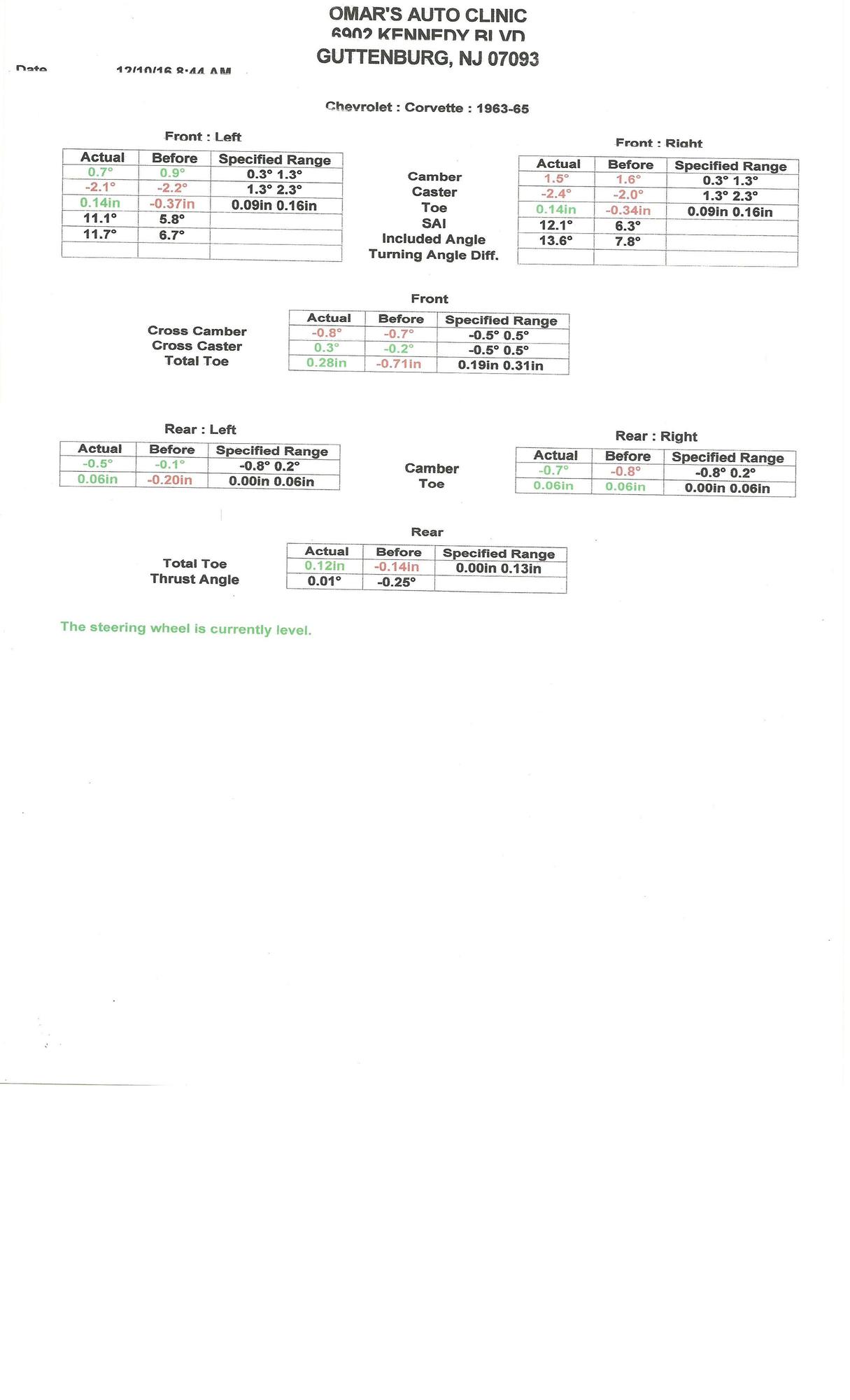

Thanks for all the input from everyone. Here is the printout and the suggestion from my shop as to the best fix. They say the offset shaft is not enough and I should use the adjustable control arm. Thoughts?

how does it drive/handle right now after the alignment you show in the report above? all of the parameters, except for caster, seem to be within spec.

His right front camber is not within spec either...........especially for radials.

Your caster is WAY off. You want POSITIVE caster. Your readout shows negative caster.
How many shims do you have at each location?

I find it difficult to believe that both sides could have THAT much positive camber and THAT much negative caster. If only one side was that far off I might suspect a tweaked frame, but BOTH sides...
There is definitely something rotten in Denmark.
The suggestion that the upper controls arms were incorrectly installed side to side is a good start. Get together with another C2/3 and visually compare. Look at your AIM and note that the right/left upper control arm/shaft assemblies are different part numbers.
What maintenance/restoration history do you have on the front suspension?
Post photos of the shim packs.

Although no expert in C2's, if the A-arms are different, it's where I'd start. Some caster is needed to stabilize and center the car and for steering wheel return. Negative caster like that shown would give the car the stability of a bicycle with its handlebars and forks flipped backwards....not good in a performance car.
