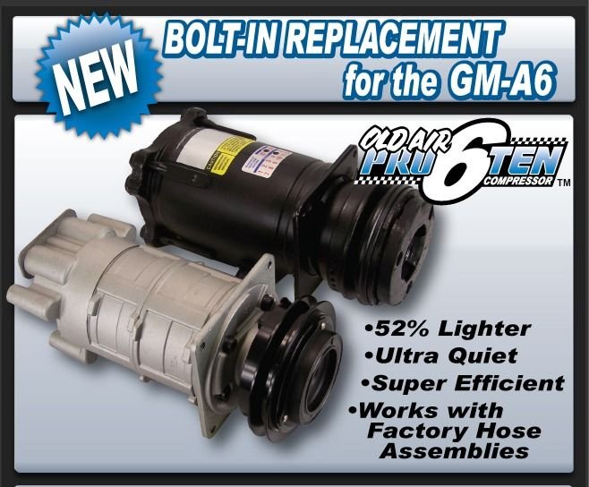

Just one additional piece of info...
For those that are thinking about using an A6 Compressor instead of the Sanden compressor, check out the ALMA Products A6 compressors.
http://www.almaproducts.com/products/ac-compressors
These A6 style compressors use the double lip front seal to address the issue of oil leaking from the front seal (and onto the underside of your hood).
There is also the aluminum PRO6TEN compressor as an option for a compressor that looks like an A6 compressor.

I can't imagine the pain of changing plugs with one of those big A6 style compressors on the car. With aftermarket air you're not fooling anyone anyway so I don't see the point...
It would be interesting to see if these units got the same NCRS deduction as the Sanden units...

I have so much 'stuff' under the hood that it takes me 6 hours to change sparkplugs....
