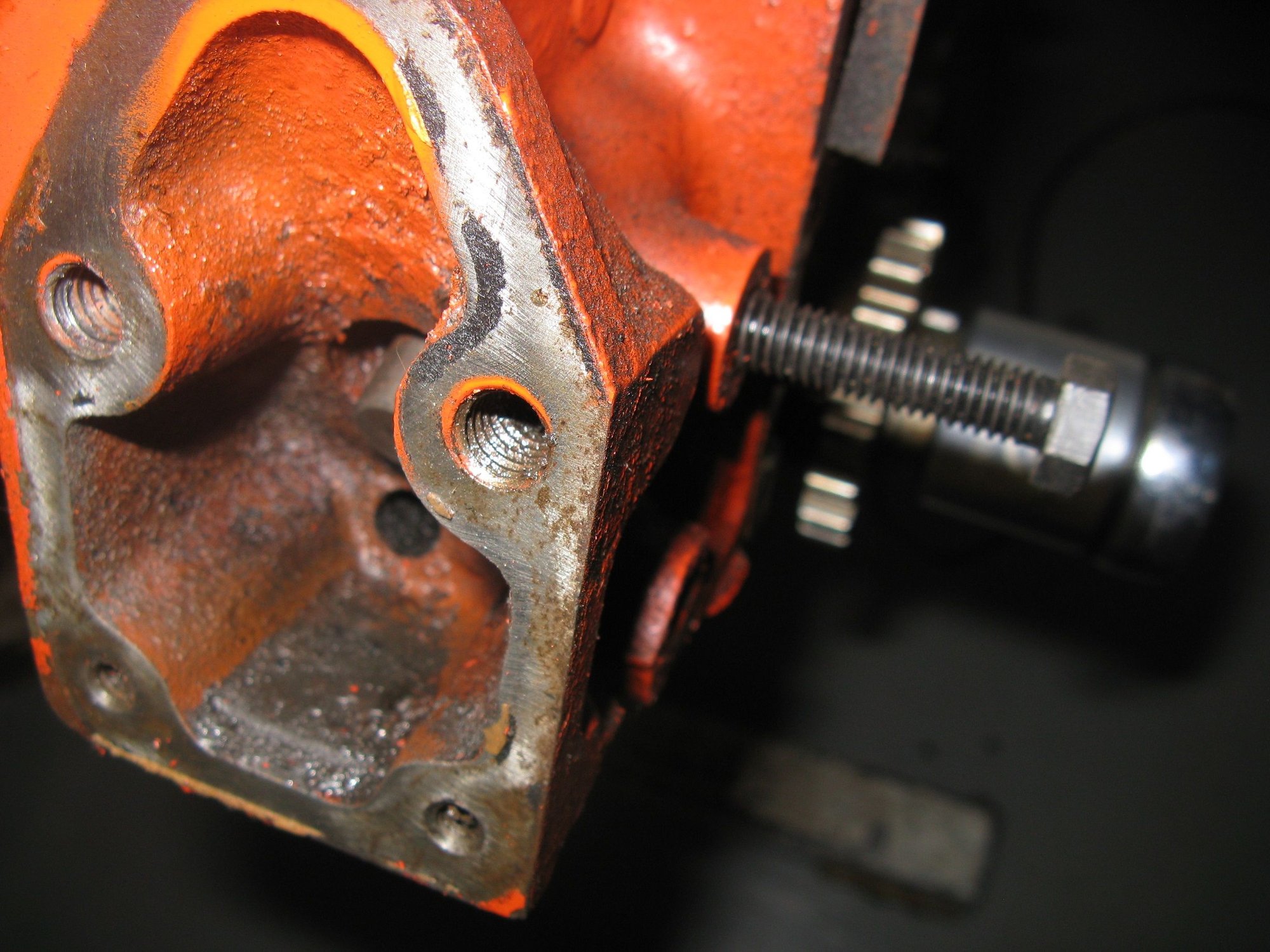

Yep the front bolt is tapped through, use a long bolt to hold it in place. (Don't forget to remove it and replace the short bolt when done!)

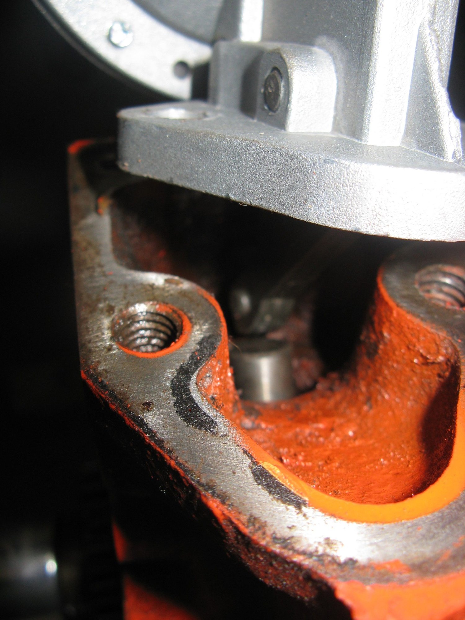

Remove this bolt:
Use a bolt long enough, aprox. 2" & fully threaded, into the hole until it contacts the rod. Do not over tighten. Note that I rounded off the end so it will not mar the rod.
It is best if you are near TDC on compression stroke.
Make sure the pump lever is under the rod before you bolt up the pump.
