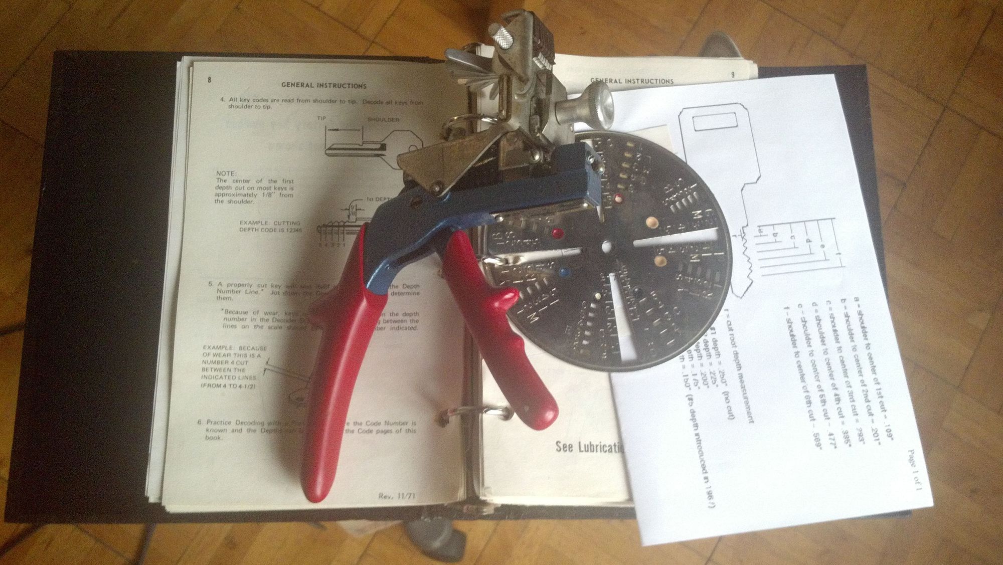

Cylinder number # 8798 corresponds to key code 434554 which is the depth of each of the cuts in the key. This is the tool needed to cut the key. The key on my 67 was a son of many previous keys and had to be wiggled and pushed down a certain way to work. When I cut a new key it worked perfectly and did not pull out.

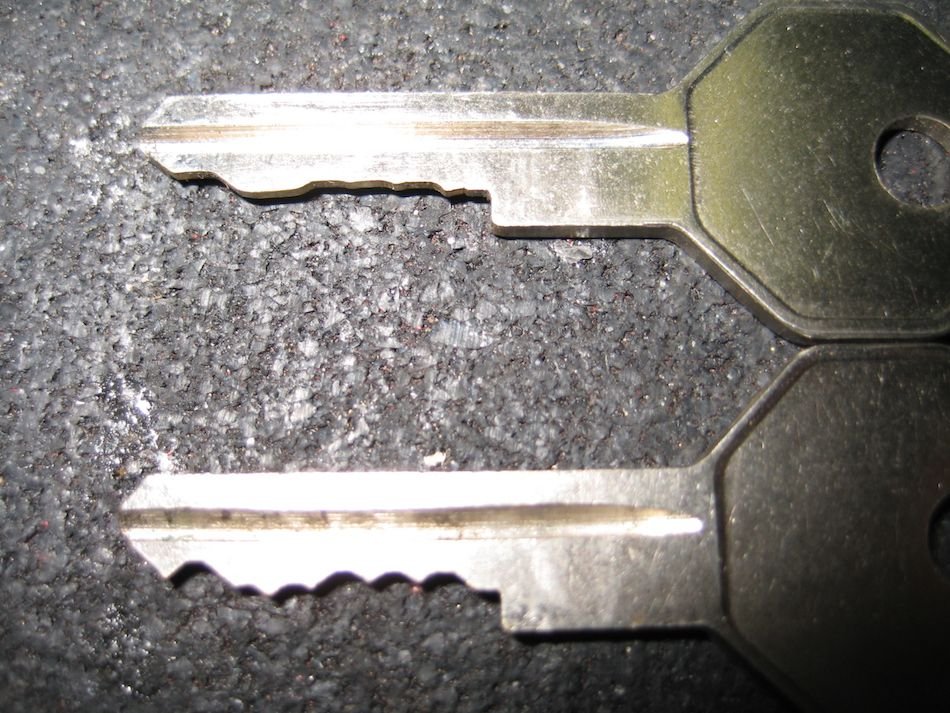

Both of these keys are for my '63. The top one came with the car. Worn and copy of a copy, etc. Works fine but comes out of ignition switch.
The one on the bottom was recently made using the code. Again works good but stays in the ignition.
