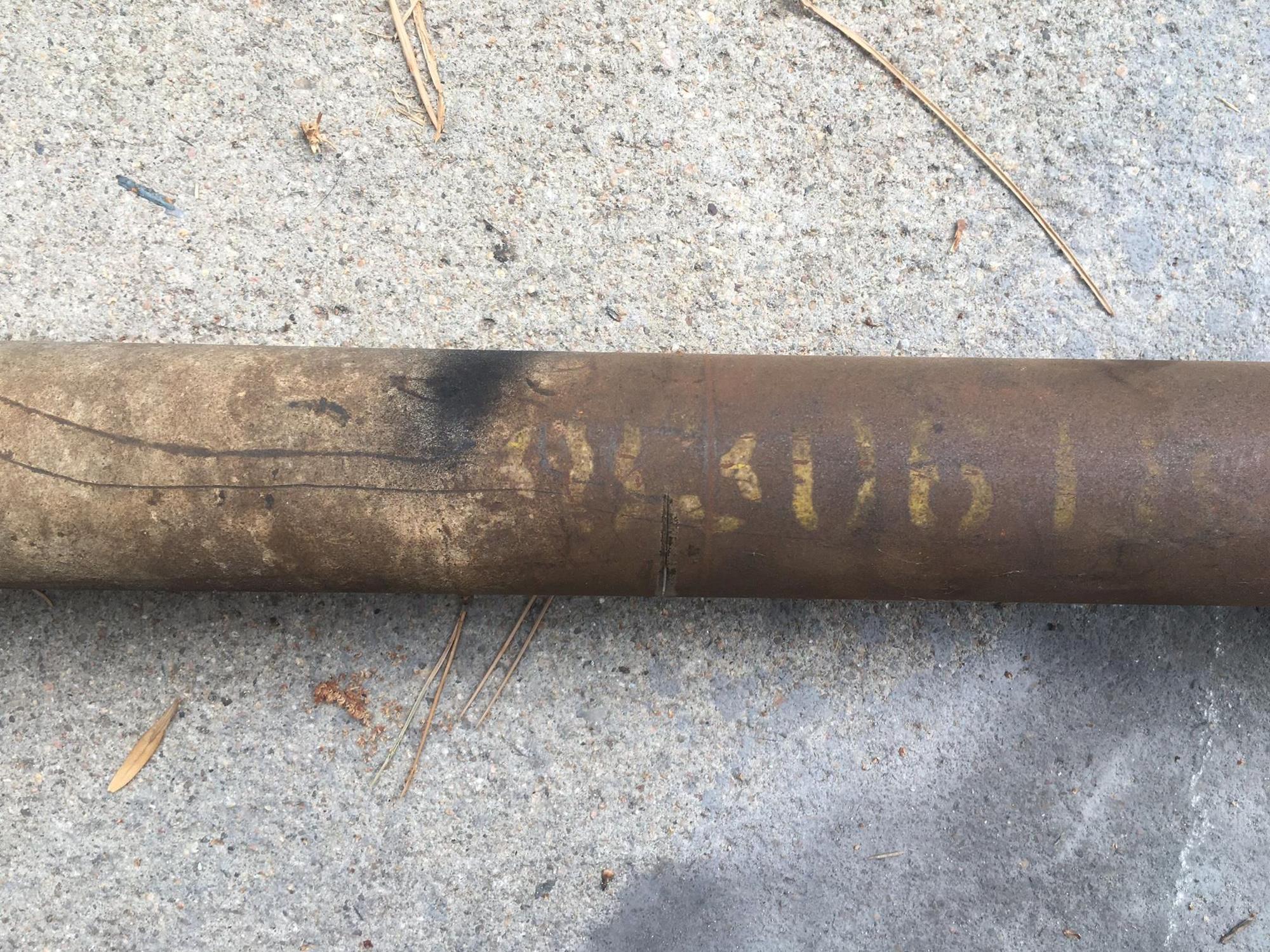

I got a new (to me) trans today, close ratio Muncie to replace the B/W 1963 that was in it. (info on separate trans thread) Now here is something I thought was cool. Since I have to get a new slip yoke, I decided to putll the driveshaft to replace the rear u joint also. If you look closely you can still see the original stencil in yellow paint on the driveshaft from the factory. I thought that was pretty cool, although others think I have just lost it!

That is cool. I didn’t know they had one. Is that a part number or part of the vin?
I think it was for identification on the assembly line. I've seen them on other cars also.

When I cleaned up my 66 drive shaft years ago, I didn’t have any numbers, but I could still see the two colored bands around one end and two yellow chalked X’s on the shaft. I thought it was pretty cool.
In your picture, it looks like the shaft has a slice/crack in it?
Tom
I noticed that in the picture also. I think it is a scratch but I will check it out closer, I got the new u joints for it today.
