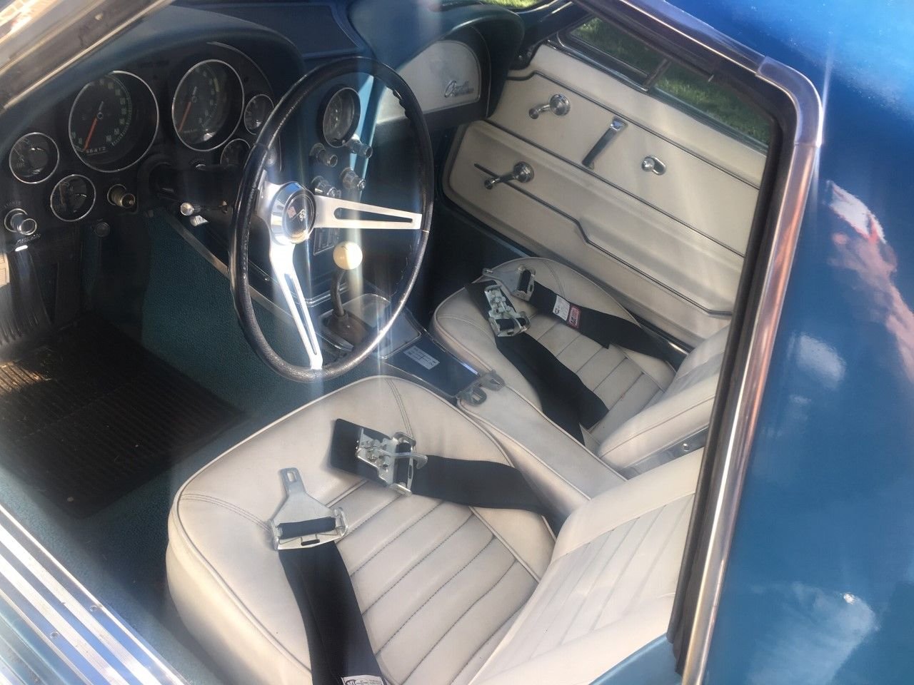

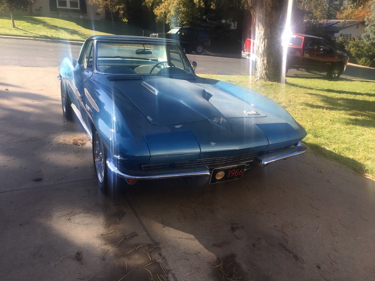

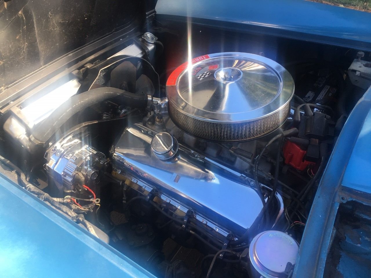

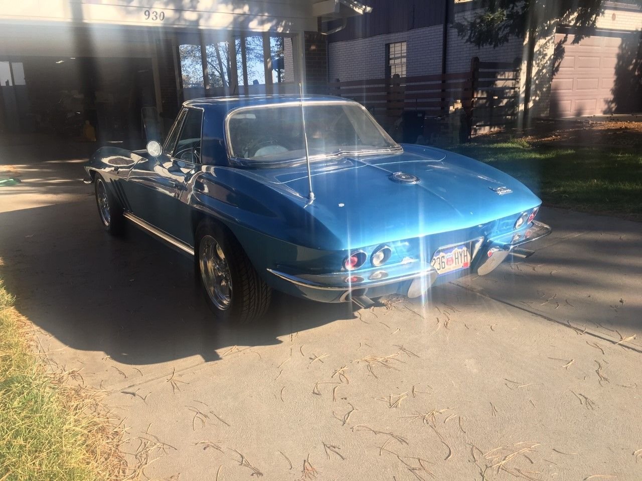

Default Ol Blue Lives..............
...........and the beat goes on.
A couple of the members have asked me about my progress and I apologize for the long lag time, but I had some family issues that got in the way of my projects, but am getting back on track now. I had to put Ol Blue on the back burner for a bit but got back to her in the late summer this year. Couple of big hiccups that came up involved the front suspension and overheating.
So I got involved in rebuilding the front suspension, and thought, I can get tube a frames with new ball joints and bushings for just a bit more cost than rebuilding the stock ones and get some extra caster besides. WRONG I got some (in another thread) from an on line vendor and after putting them on, 1, the car sat up like a 4 wheel drive P/U, 2 there were NO steering stops so the tires hit the fenders and frame, AND not enough room to get the camber needed because of not enough room for shims to get to 0. Talked with vendor several time and finally gave up I put in offset cross shafts (which got me close but not to 0 on camber) built my own steering stops, and cut one full coil off of the front springs. I finally got it to sit where I liked the stance but still want 0 camber, so I will probably go to Global West in the future, (which is what I should have done in the first place)
Then on to the overheating. I had an aftermarket aluminum radiator and electric fans in the car. (big block with iron heads) and going driving it was ok as long as you kept air moving through it. At each stop light it would creep up a little higher, and never go back down. Soon I was in the red and peeing out of the over flow tube. AND stop and go traffic, well forget it. So I took out the aftermarket aluminum radiator and the electric fans and put in a 7 blade GM Corvette fan, new fan clutch and a Dewitt radiator. Took the temp down about 15 degrees. Still working with it, but it is a lot better. Another question about that, but for another thread.
Took her out to the Golden Super Cruise last weekend (last one of the summer) and car was a bit hit. Seems people like patina on C2, maybe because they don't see many that are not fully restored. Lots of smiles
Currently I am still working on the e brake (cable froze up) w/wipers (appear to be siezed up) and the headlights, which take about 1/2 a day to open. Also need a new headlight switch. Did I mention letting a car sit for 20 years is a really bad idea.
A couple of pictures from today, sorry about the star bursts, I guess the lens was dirty or something. Special effects?
Thanks for all the encouragement from those following the thread, I will try to be more timely in the future.
