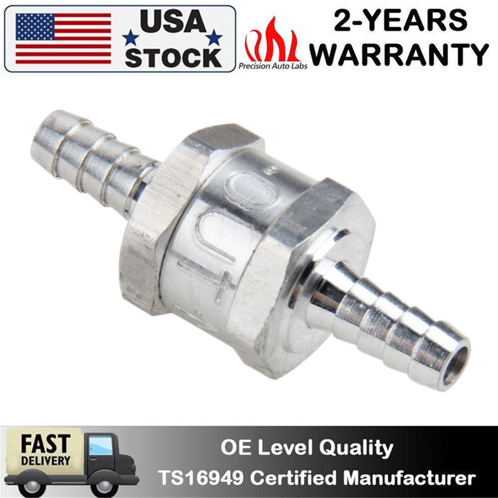

I have no idea why you have to loosen a line at the carb to get it to start, whether it is draining back toward the tank or not.
Like I said previously, you can buy a check valve for very few bucks to splice into your fuel pump line to test your theory instead of wearing out your keyboard here.
https://www.ebay.com/itm/5-16-8mm-Fu...gAAOSwh41atNO1
Mike, is this the same brand and style as the one you use on your cars?

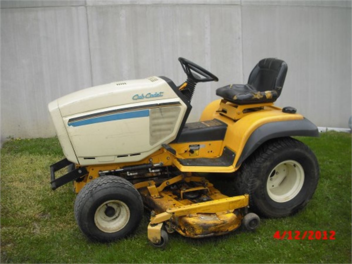

I have a fleet of garden tractors. Just a fetish of mine. About 20 of them are the same design, just different features and different engines. All have fuel pumps and all have the tank lower than the engine,
Three different kinds of engines. Kohler Magnum opposed twin, Kohler Command V Twin and Briggs Vanguard V Twin. The Briggs and the Command have the same kind of vacuum diaphragm fuel pump. The Magnum has a cam operated fuel pump.
The only ones that will start quickly after sitting idle for a week or so is the Commands. The Briggs and the Magnum, you crank and crank and crank and finally they will start. Both seem to have empty carburetors.
So, I bought three of these check valves a couple weeks ago and installed one on one of my problem children, thinking that fuel is draining back to the tank. So far, on one tractor, that hasn't made any difference. Still hard to start. I'll get around to installing the other two check valves but I have no confidence that the fuel siphoning back to the tank is the problem.
I think the problem is evaporation, just like me and almost everyone else of this thread thinks.
Small, low pressure fuel pumps are available and installing one would fix this problem. I just don't get too emotional over it.
