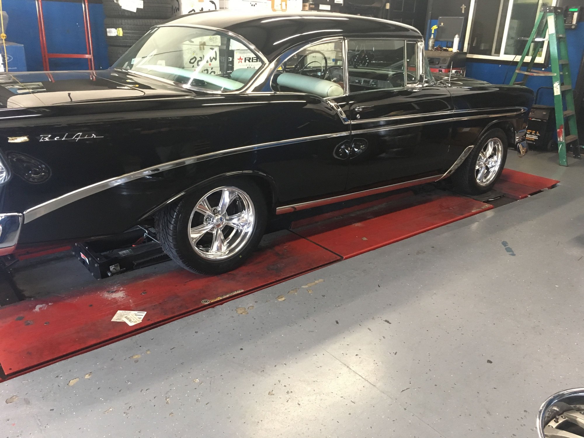

Yeah, I'm kinda curious to know how far I was off. Someone mentioned the Lunati Voodoo 201207-11 (or -12) might have been better. I kinda thought the -11 might have been better, but not the -12.
I have the equivalent of the 201207-10 in a non roller in the 327 in my black '56 Chevy, It has the same block bored out .030 with the same flat top pistons. I took a set of "peak" or "pyramid" heads and put in oversized valves (not quite the same as double humps). I used 2.5" Ramshorn headers and 2.5 exhaust pipes out to 14" Dynomax Super Turbo mufflers. My CR was rated at about 9.8 with HP at about 300. I was happy with those specs, and I like the idle and I have the original 3 on the tree with overdrive, I love it, I don't remember if the posi rear end is a 3.36, or 3.55 but it cruises beautifully at 70mph doing 2300RPM. I have burned 40 feet of rubber off the 17X8 Nitto tires without trying too hard..
I have another fully rebuilt 3speed with the B/W OD. Has anyone regressed to this setup? How did '62 Corvettes use their 3 speeds.
