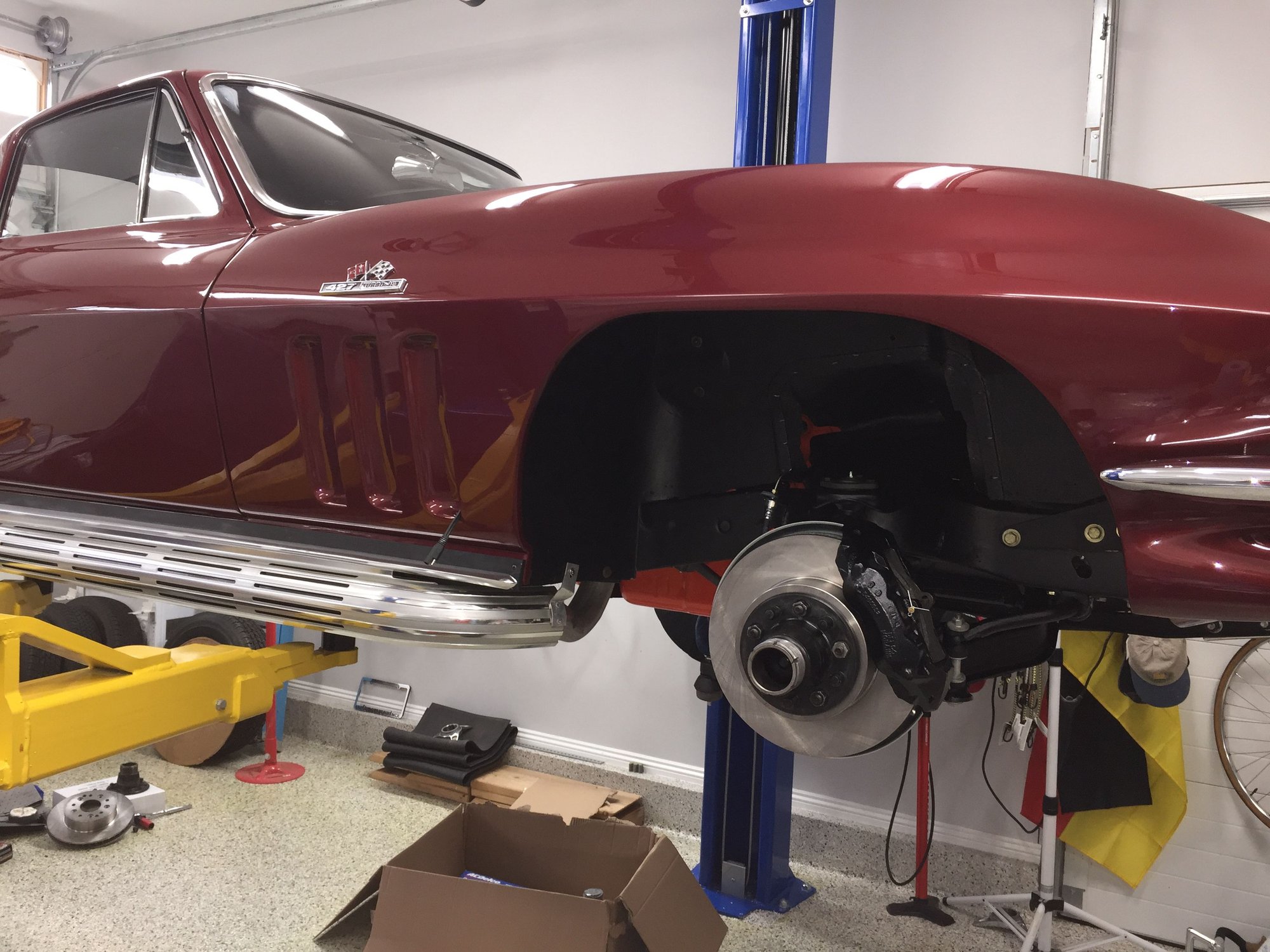

I’ve tried searching brake bleed but run into the usual difficulty from an iPhone.
My ‘66 has a newer dual reservoir mc, but no power brakes.
I’ve completely drained the brake fluid, changed the calipers and a few lines.
Now I need to fill with fluid and bleed.
I’ve bled a lot of brakes but never on a car with no fluid.
I have a Motive power bleeder (I have not ordered the correct adapter yet btw).
Those who have done this, should it go fairly well filling the mc and power bleeding each caliper or on this car has that proved difficult and I may need a vacuum bleed or another method?
I would think a Motive bleeder pumped to 15-20psi would work to fill each line and get all the air out but am I to expect any issues?
Thanks,
Dennis
