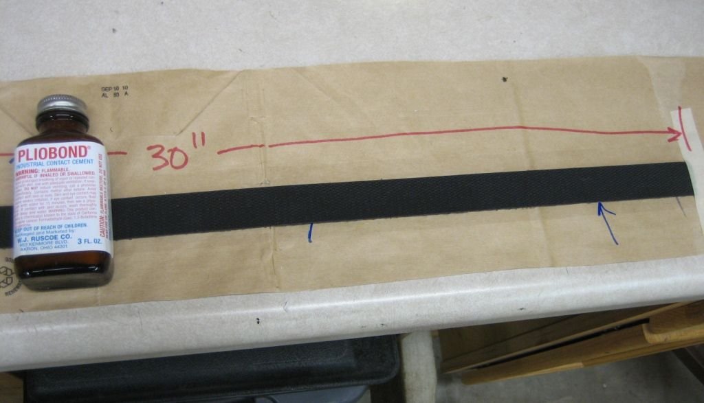

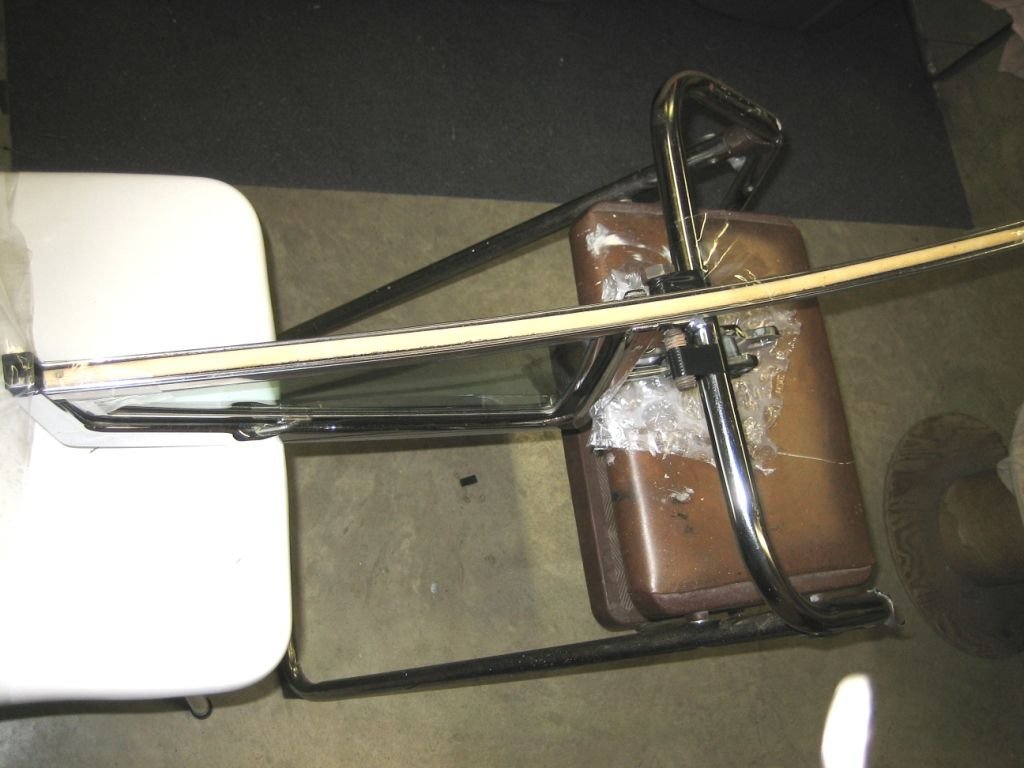

Use 'hook' -- not loop -- velcro, 1" wide, ~30" length for convertible. Good quality, non-adhesive backed; not "fabric store" stuff. Cure by inserting, slightly bending & securing a wooden rod. The 1" width will exactly fill the 3 inside surfaces of the "U" channel without trimming. Removing old fuzzie mat'l is time consuming, but worth it.
