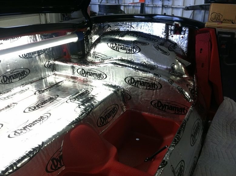

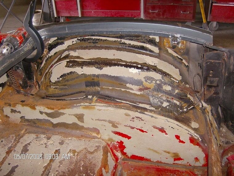

I did the interior of my '63 in Dynamat and I can't imagine it is any more difficult to remove than the original carpet/foam was.
From this...
to this...
and finally this...
Good luck... GUSTO

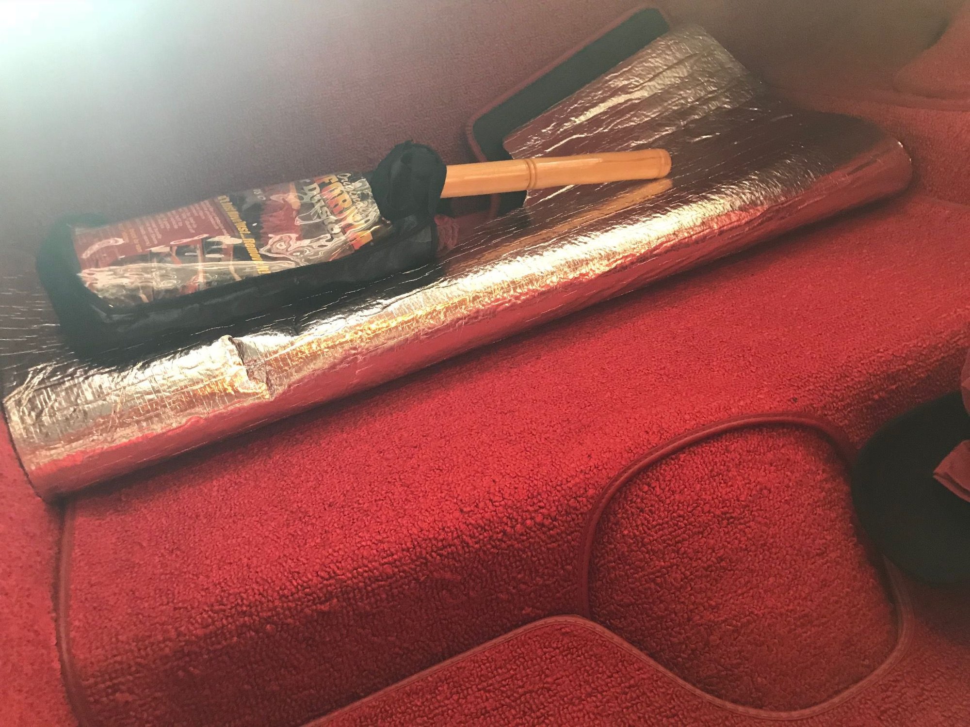

The Frost King and Peel'N'Stick work just fine...the goal is to get enough mass to dampen vibrations and harmonics while getting some acoustic deadining. I even installed it in the roof of my coupe:
There is also a cargo area insulation mat with foil backing that you can buy reasonably (coupe or eonvertible) with a carpeted cover that really deadens drive train sounds in the rear. You can get them both from Mid America Motorworks for about $150...
They just lay in place and are removed in 10 seconds....if desired....
Its also great for coupes to protect original carpet from fading via UV through the rear glass.
